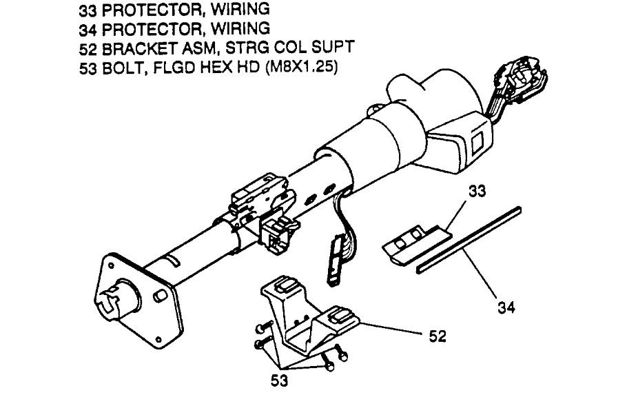

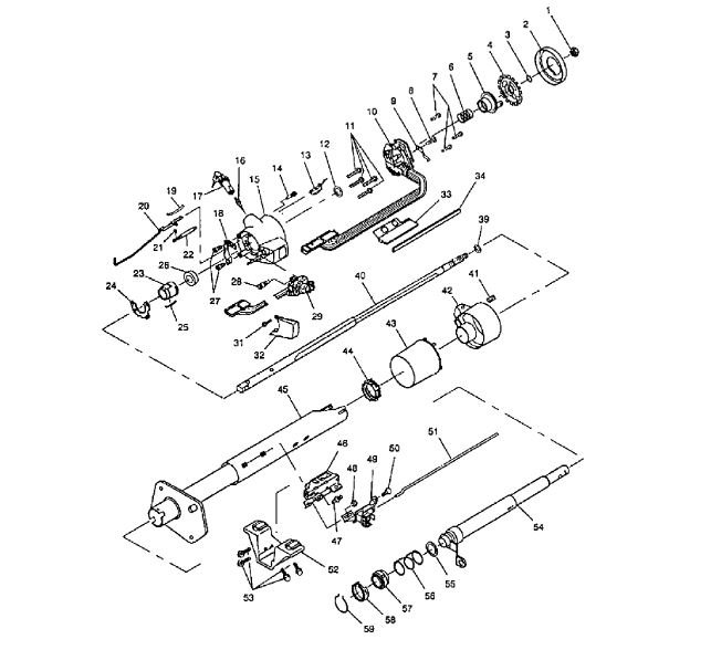

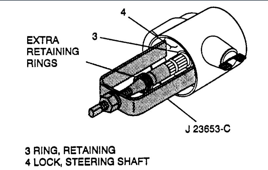

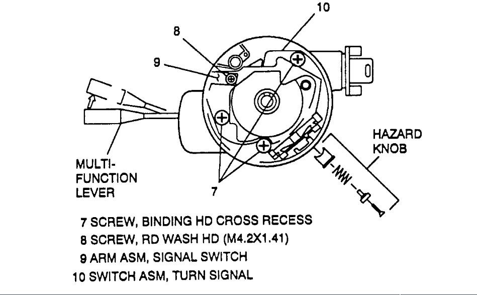

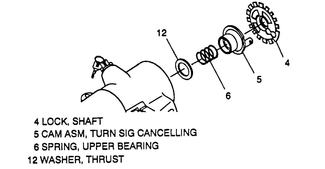

About a month ago, the ignition on my truck started to get stuck right before that last click for it to kick over. It tried to lock up on me only once while it was still on. Well that lasted for maybe two days, but haven't had any issues since. Until last week I tried start it and but this time it just completely locked up on me. There was no turning it to the off position, or wiggling it. I was able top still remove the key from the ignition with no problem, so I finally just disconnected the battery.

I attached the procedure for replacing the lock cylinder. it sounds like the cylinder needs to be replaced.

3. Shaft lock retaining ring (3) using J 23653-C to push down steering shaft lock (4). Dispose of ring (3).
Removing Shaft Lock Retaining Ring
4. Shaft lock (4) from steering shaft assembly (40).
5. Turn signal cancelling cam assembly (5).
6. Upper bearing spring (6).
7. Thrust washer (12).

9. Multi-function lever and hazard knob assembly.
10. Washer head screw (8) and switch actuator arm (9).
11. Three cross recess screws (7).
Turn Signal Switch Removal Preparation
Removing Turn Signal Switch
12. Turn signal switch assembly (10).

A. Hex head bolts (53).
B. Steering column support bracket assembly (52).
C. Turn signal switch connector from vehicle wire harness.
D. Wiring protectors (33) and (34).
E. Gently pull wire harness through column.
