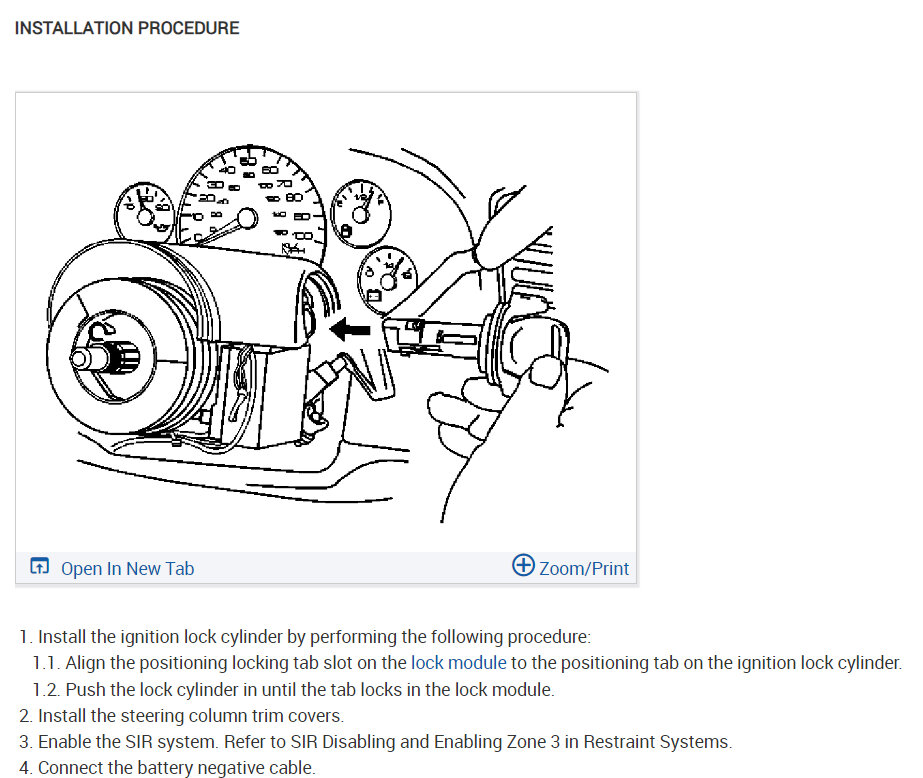

how do i reconnect the white wires that someone cut on my ignition tumbler when they ripped and smashed my ignition apart?
Mar 14, 2024 at 4:31 AM
  • 55,721 POSTS

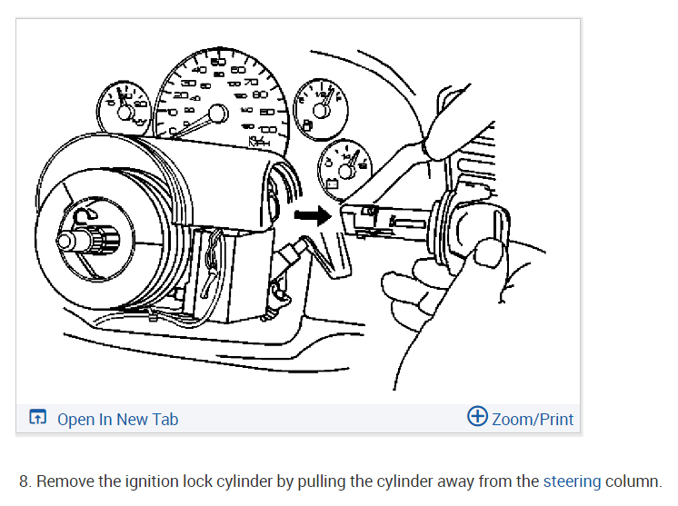

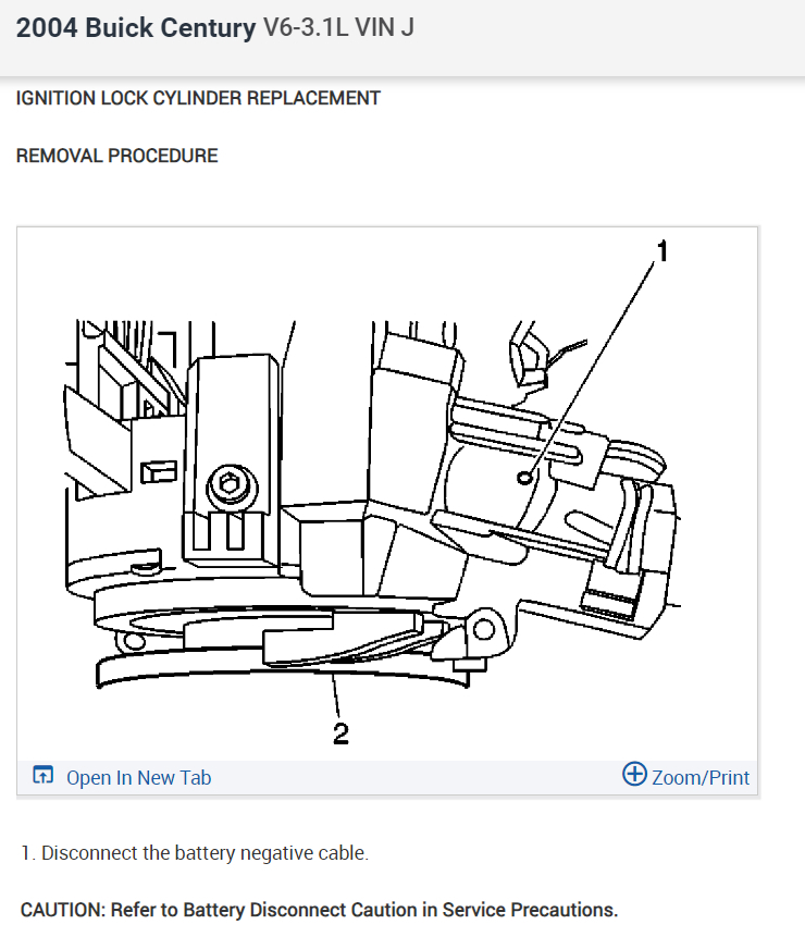

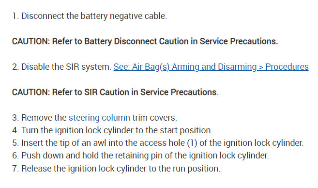

Do you have an image so we can see the damage you are trying to fix? Here is how to replace the ignition switch, I don't see any wires that you speak of? Check out the images (below). Please upload pictures or videos in your response to the problem so we can see what's going on.
