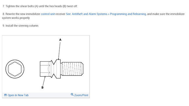

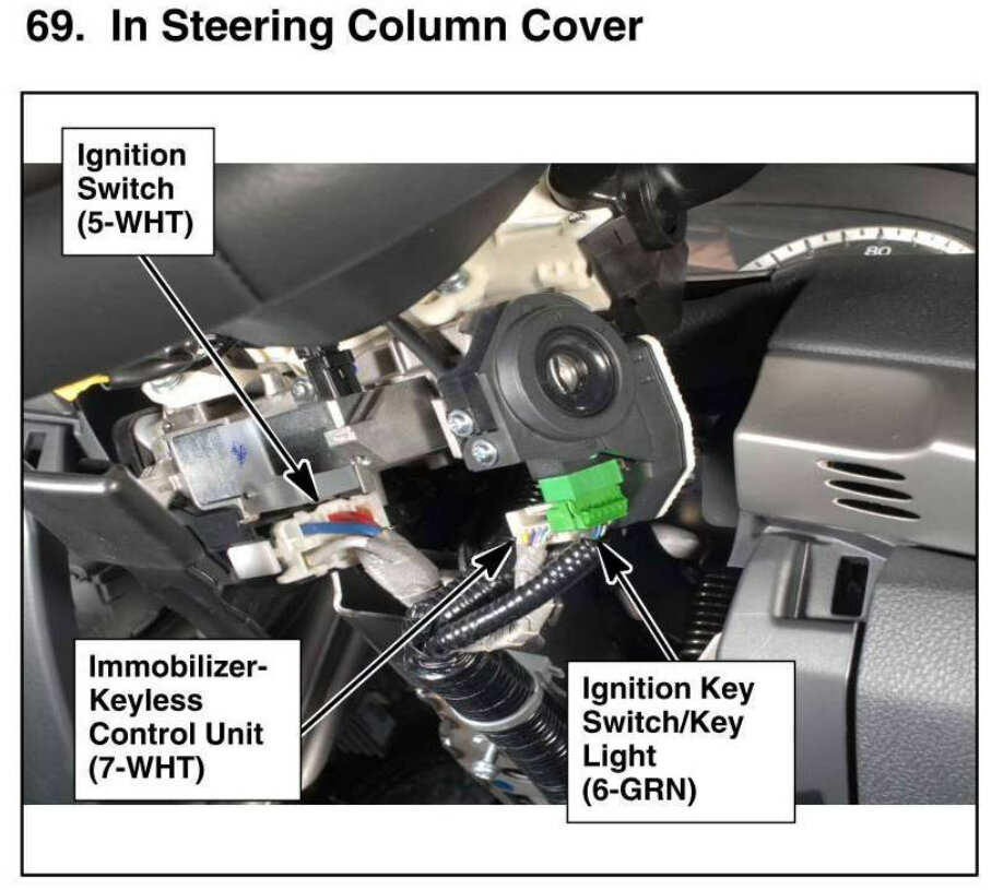

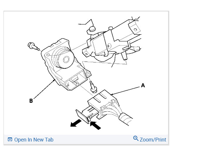

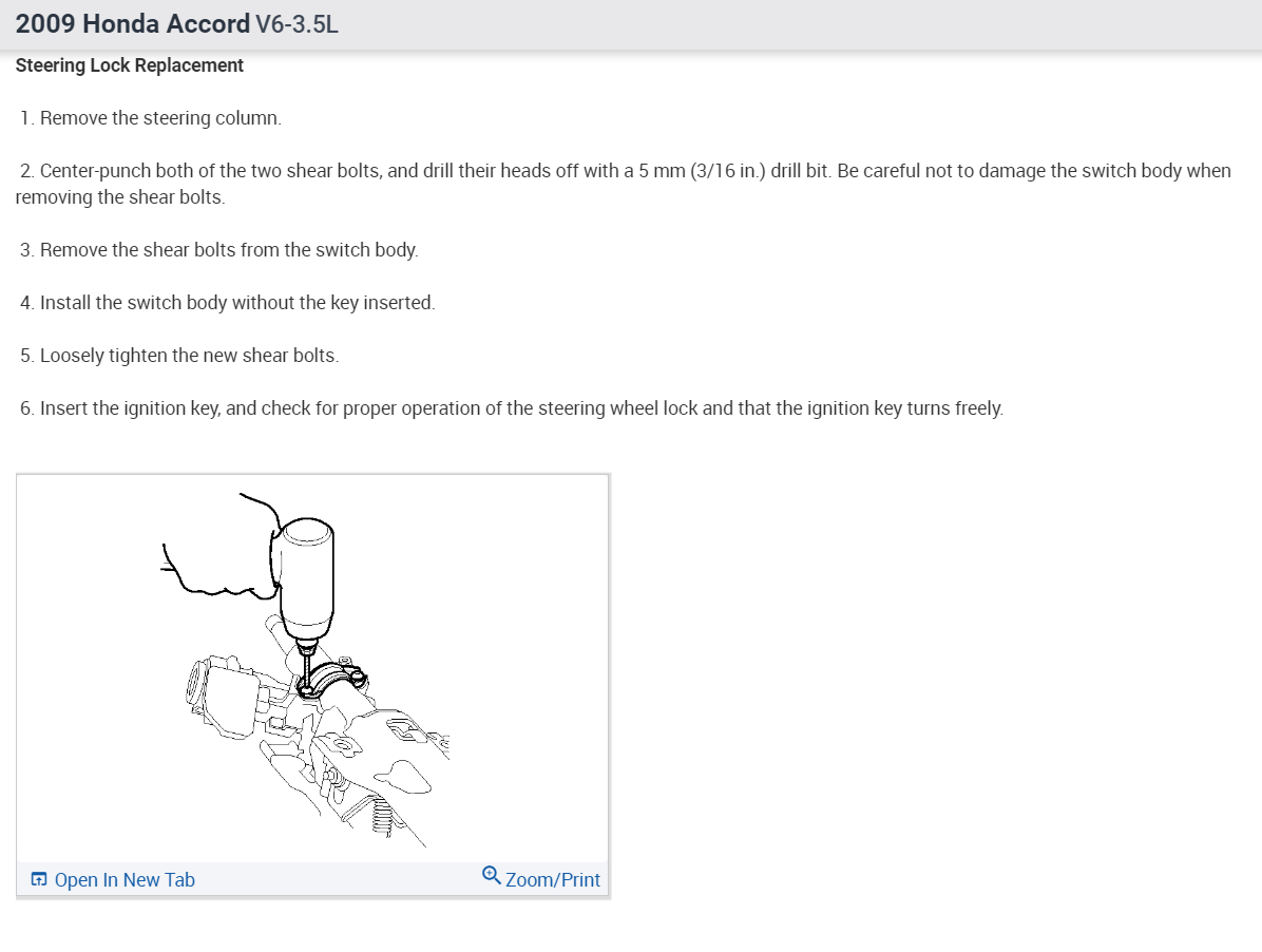

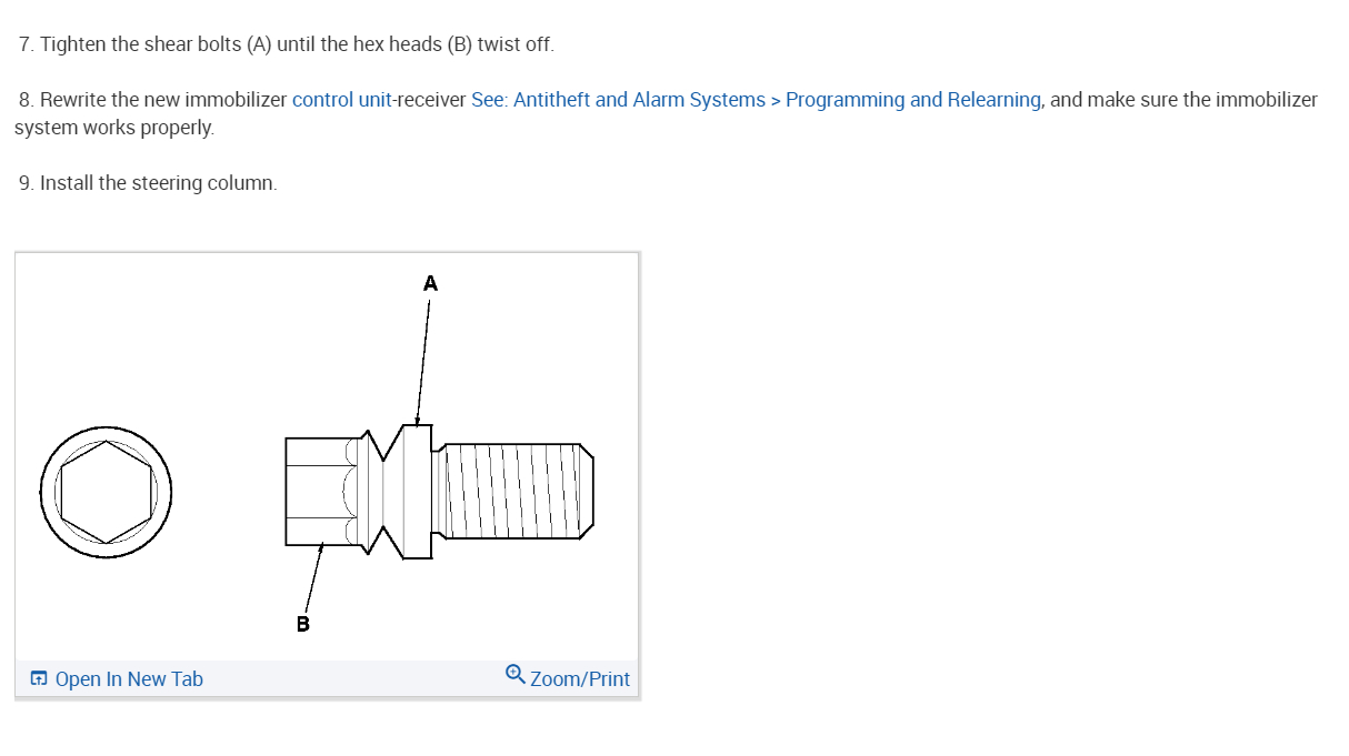

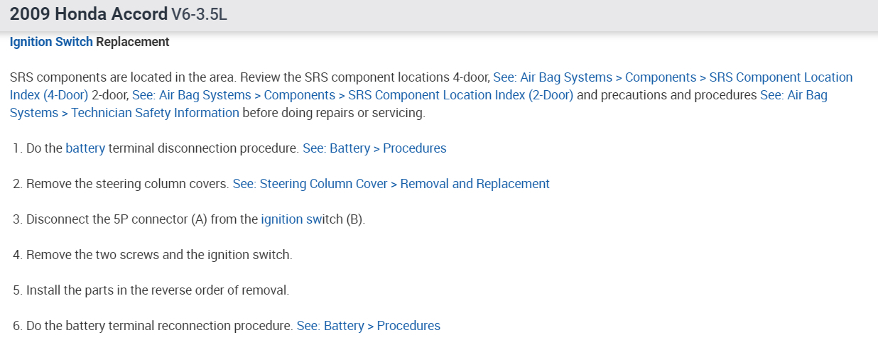

Okay, I bought a new ignition lock cylinder with the key. When I change the cylinder and not the whole assembly. Do I still need to get the key programed? Okay I changed the ignition lock cylinder and the car keeps digging but the key won't turn. I read that after market cylinders don't meet flush so the right stuff isn't connecting to tell my car to run. So I'm assuming I need to get the whole assembly instead. So my question is if I get the whole assembly with the coded key once I change it do I have to get anything reprogramed or will my car just start normal again?
Aug 6, 2023 at 3:57 AM
  • 55,433 POSTS
You will need to have its codes, I would get the part from the dealer so it will come pre-coded or have a mobile locksmith come out and recode the key. Check out the images (below). Please let us know if you need anything else to get the problem fixed.
