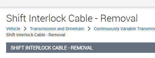

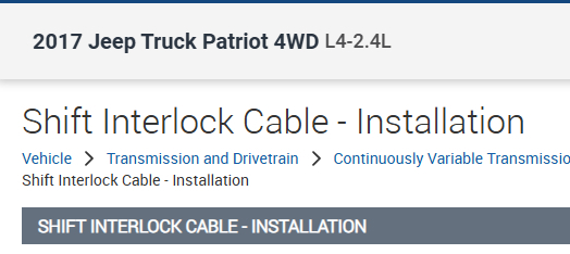

2017, jeep patriot, latitude, 2.4, automatic, 6 speed transmission. 151k miles.
I paid to have my key removed from my ignition. But it was recommended that I not put it back in until I repair the locking mechanism on the steering column connected to gear shift.
I cannot seem to find any instructions or video on how to do this. Does anyone know where I can learn DIY specific info on changing this cable if that is in fact the issue?
Actually any guidance would help.

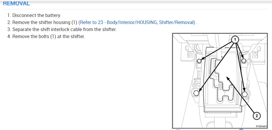

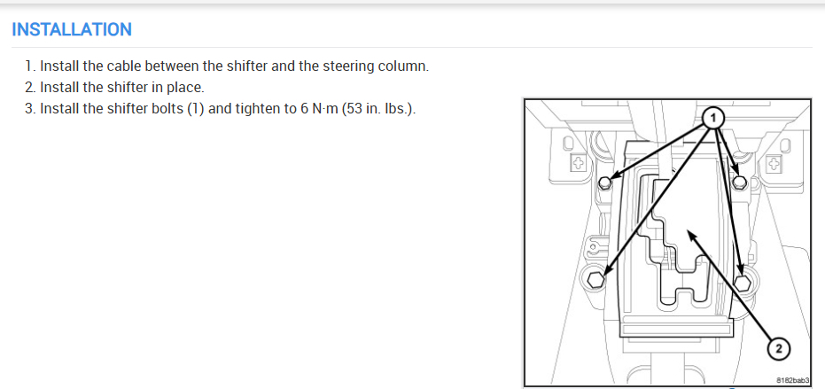

Hi:
I was able to find the removal and installation directions in my manual. I attached them below.
Take a look through the directions and let me know if they help or if you have additional questions. I hope this helps.
See pics below
Aug 2, 2026 at 8:17 PM
  • 110,251 POSTS

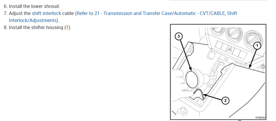

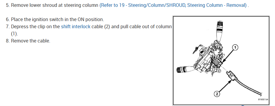

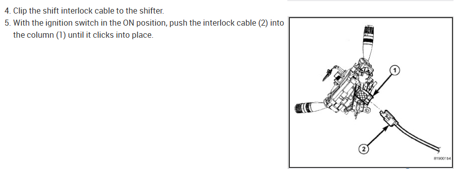

Here are the additional directions. I hit the wrong button. LOL
