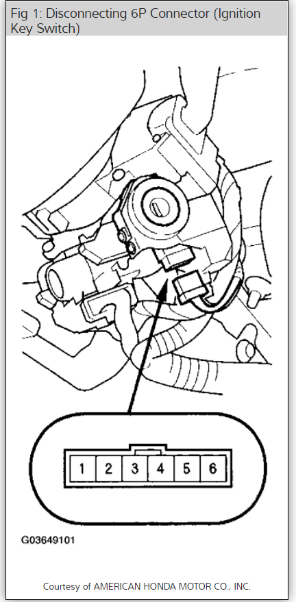

Key goes into ignition but will not turn.
Feb 26, 2018 at 11:21 AM
  • 54,832 POSTS

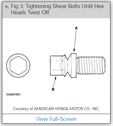

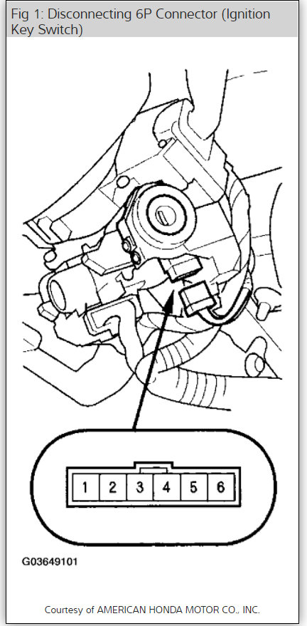

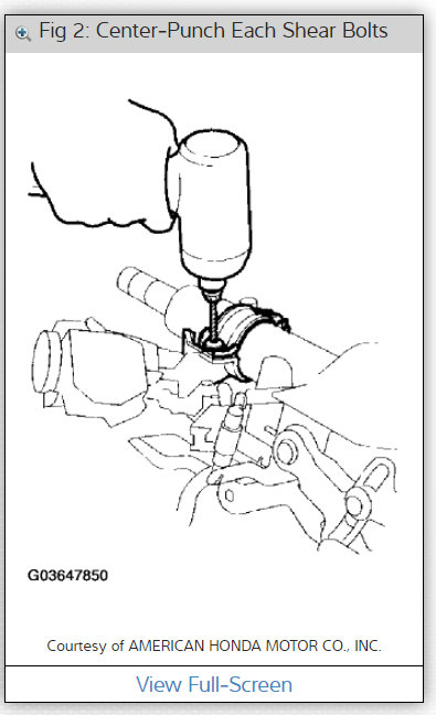

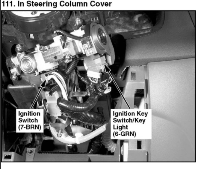

It could be you have the steering wheel pressed against the lock. Here is a guide to help you see whats going on:
https://www.2carpros.com/articles/ignition-switch-wont-turn-stuck
If okay then the lock will need to be replaced here are guides below to help you see what you are in for when doing the job. I think you can get the ignition lock from Amazon or Rock Auto.
