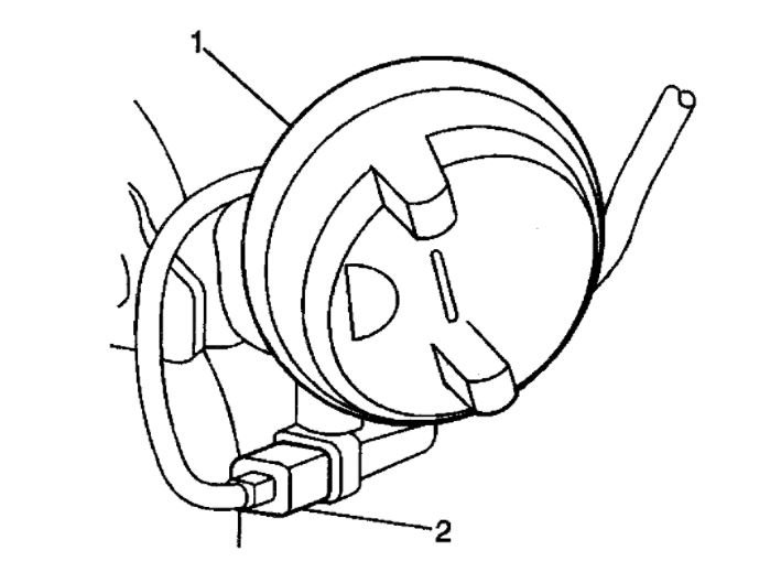

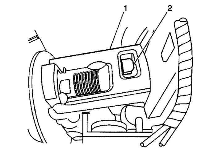

4. Drill out the locking button (2) on the rear of the housing assembly (1) using an angle drill.
5. Remove the ignition lock cylinder (1) by pulling outward from the steering column.
6. Disconnect the electrical connector (2) from the ignition lock cylinder (1).
7. Remove the metal shavings from the steering column and ignition lock housing assembly.
