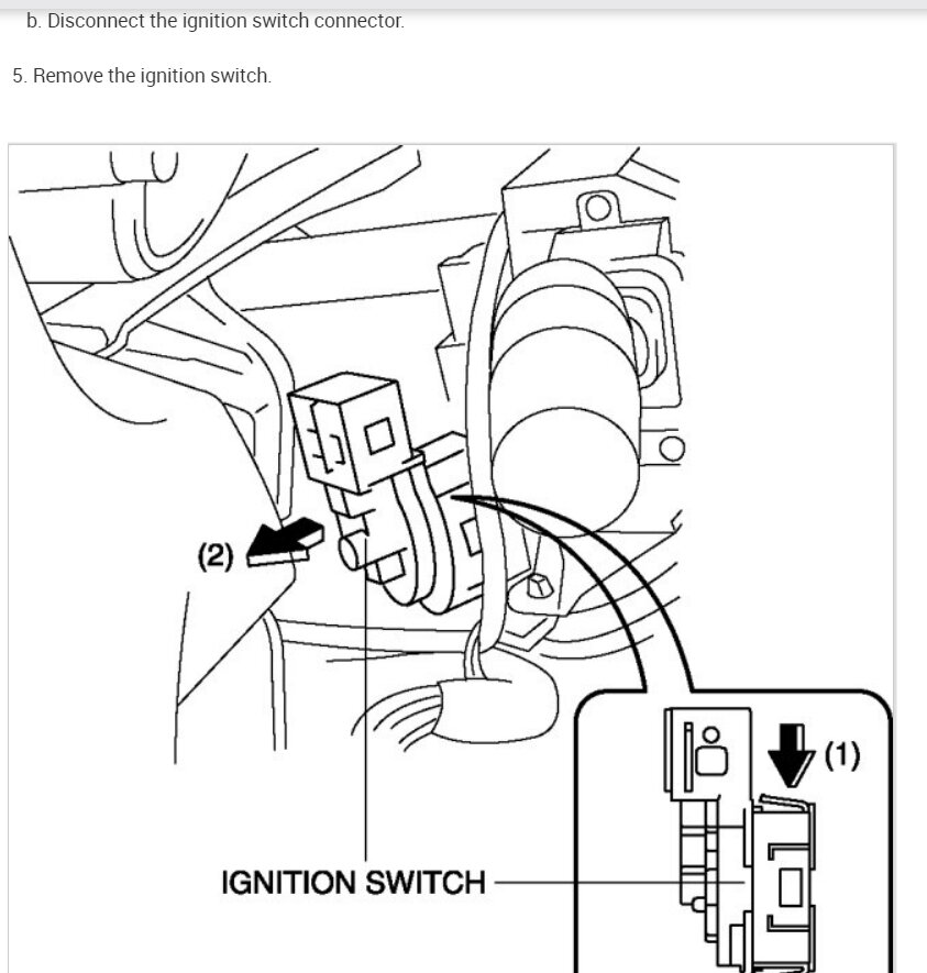

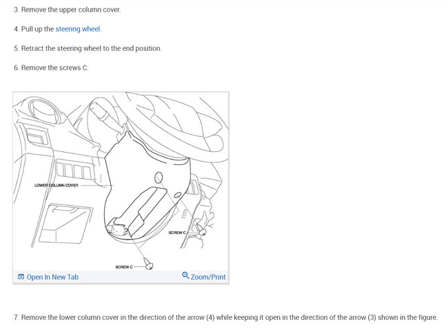

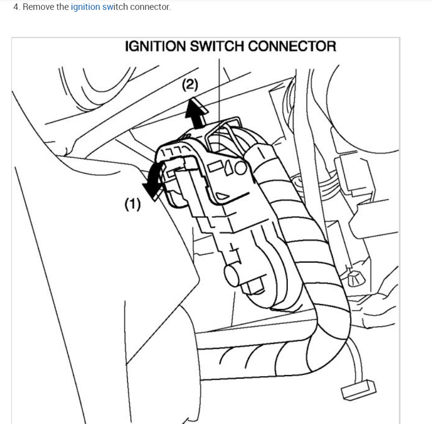

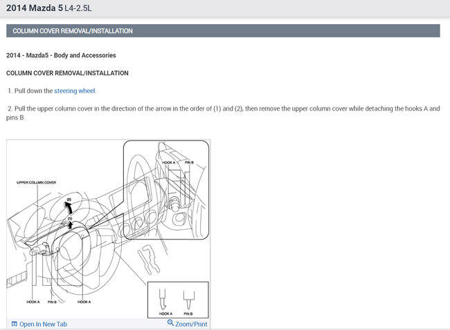

To start with we need to spray WD40 into the ignition switch lock to see if that helps. If not, the key lock will need to be replaced and you will have two keys for the car. I would get the parts from the dealer so they can be coded to your car before they are installed.
This guide may help:
https://www.2carpros.com/articles/ignition-switch-wont-turn-stuck
Check out the images (below). Let us know what happens and please upload pictures or videos of the problem.
