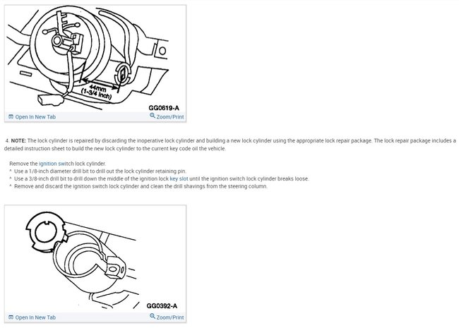

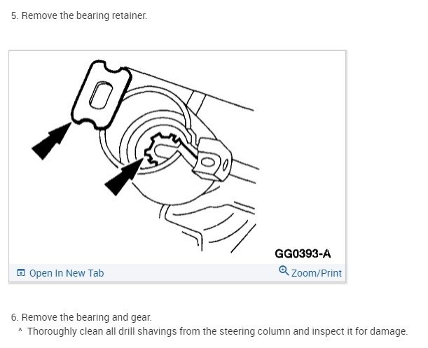

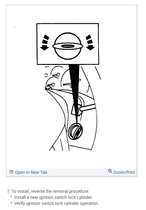

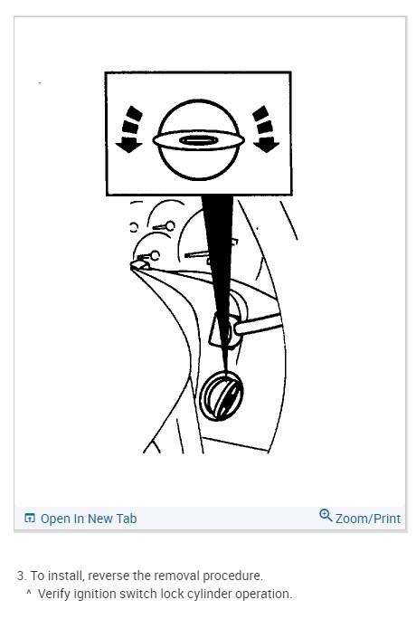

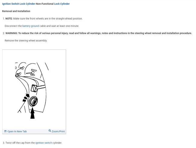

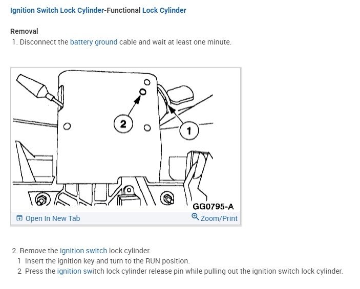

Tried removing the ignition lock cylinder so I can replace it. But the old one is stuck in the steering column.
Mar 17, 2022 at 8:17 PM
WENDY W
  • 86 POSTS
I've attached removal and installation procedures below for both functional and non-functional ignition lock cylinders. Please remember to disconnect the negative battery cable before you begin.
