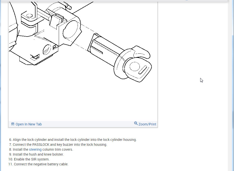

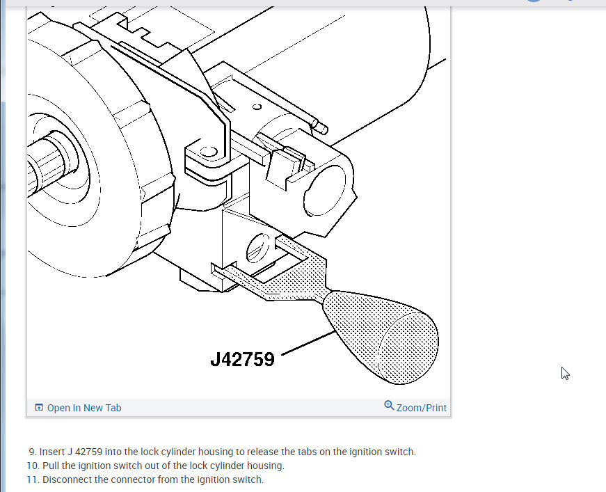

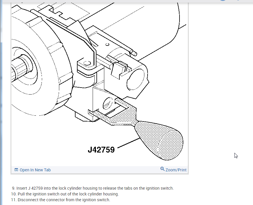

Here are the directions for replacement. The attached pics correlate with the directions. I'm not 100% sure, but the new key may require programming. There is nothing listed in the manual, but I swear it was required.
_________________________________________________
2005 Chevy Truck Tahoe 4WD V8-5.3L VIN T
Ignition Lock Cylinder
Vehicle Steering and Suspension Steering Steering Column Service and Repair Removal and Replacement Ignition Lock Cylinder

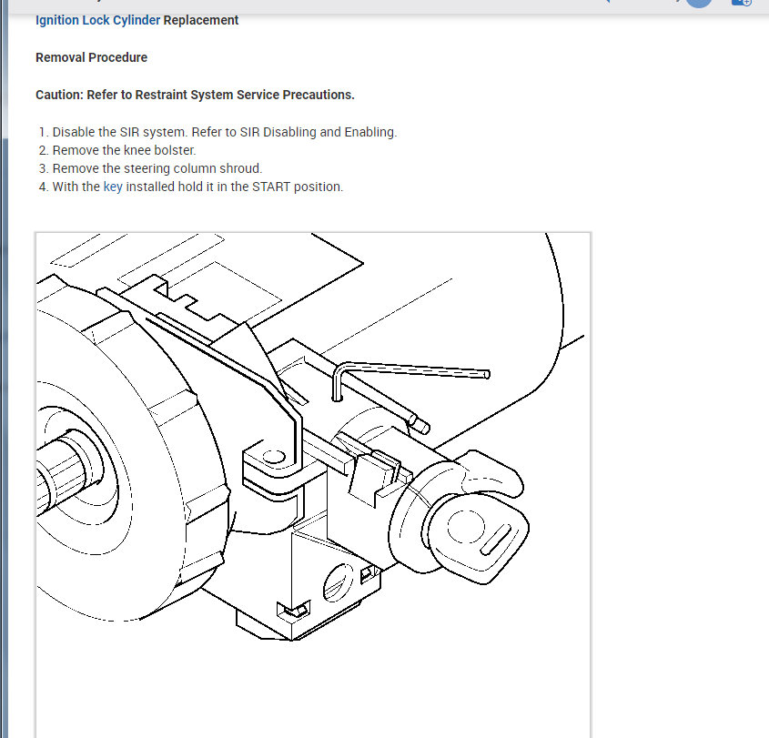

IGNITION LOCK CYLINDER
Ignition Lock Cylinder Replacement
Removal Procedure
1. Disconnect the negative battery cable.
Caution: Refer to SIR Caution in the Preface section.
2. Disable the SIR system.
3. Lower the knee bolster.
4. Remove the steering column trim covers.

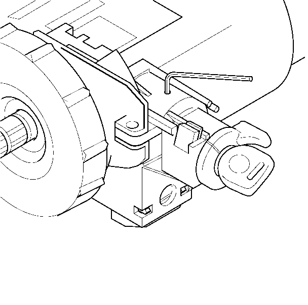

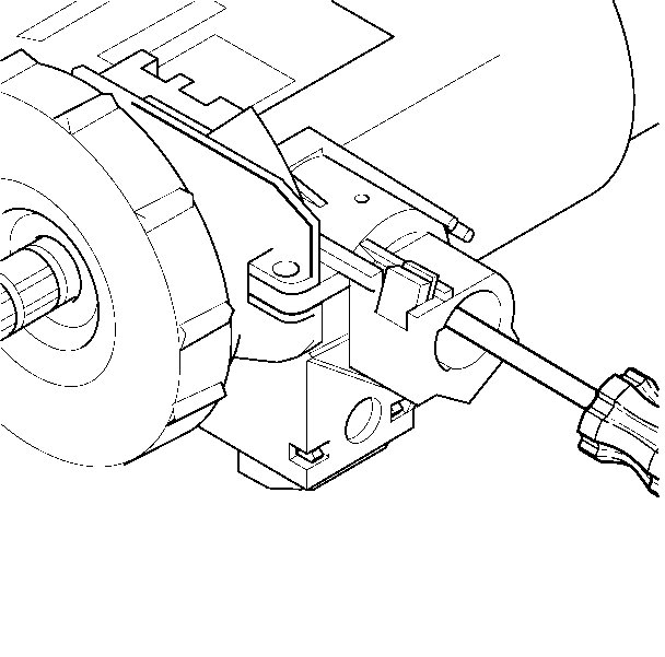

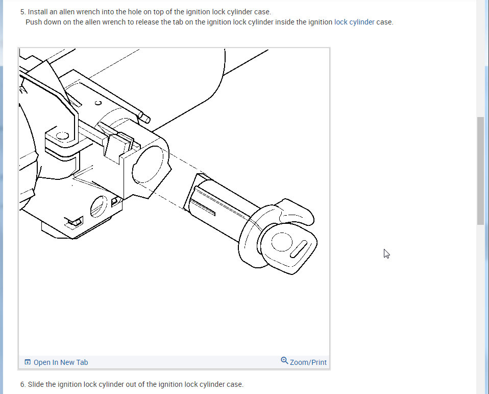

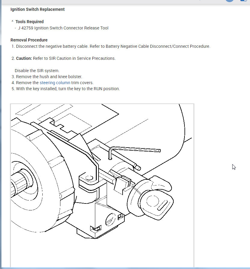

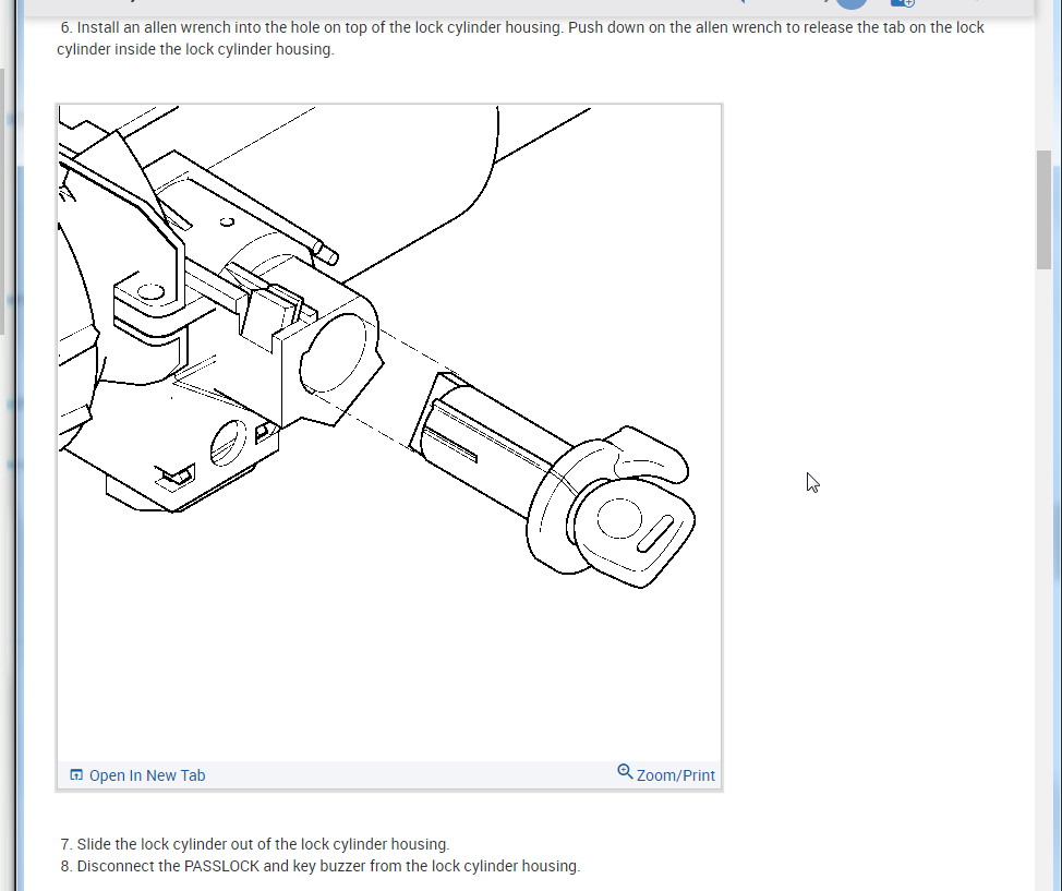

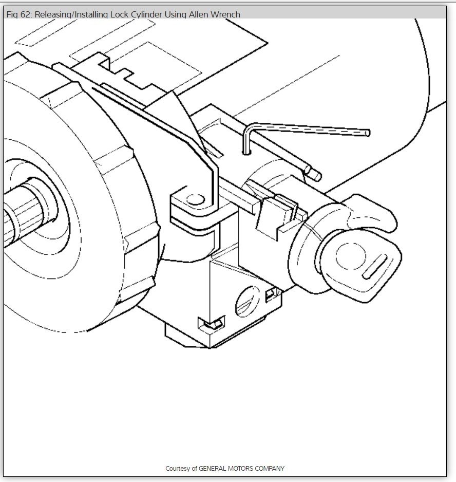

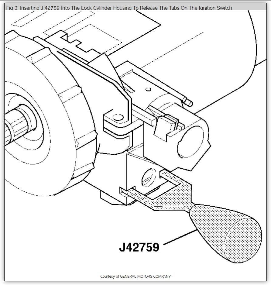

5. Use the key in order to turn the ignition lock cylinder to the START position.
pic 1

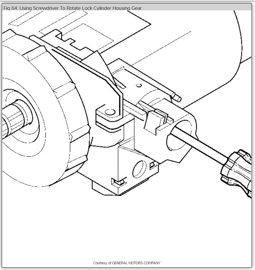

6. Install an allen wrench into the hole on the top of the lock cylinder housing.
Push down on the allen wrench in order to release the tab on the lock cylinder inside the lock cylinder housing.
Pic 2

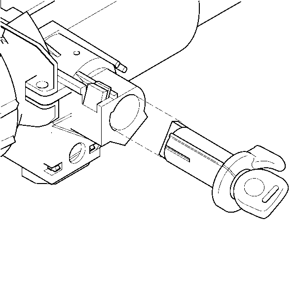

7. Slide the lock cylinder out of the lock cylinder housing.

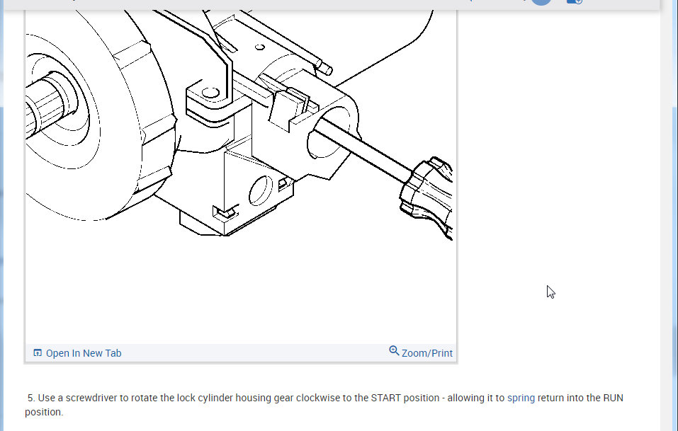

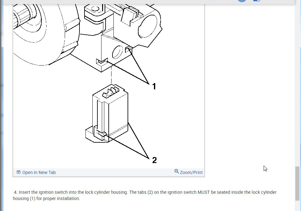

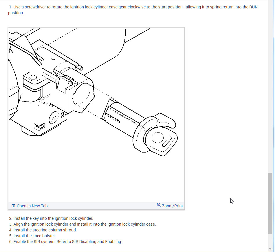

Installation Procedure

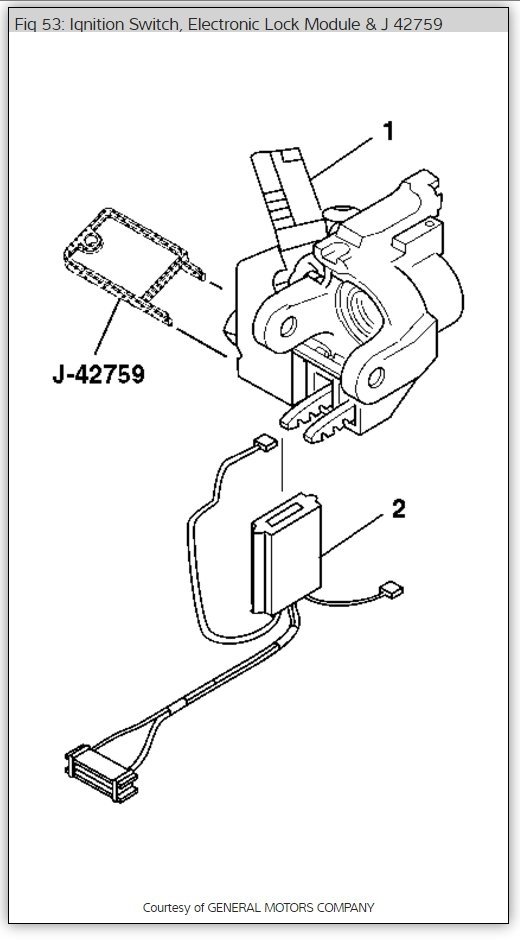

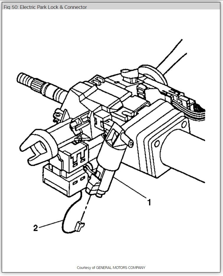

pic 3

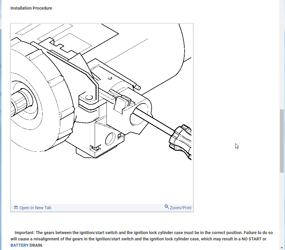

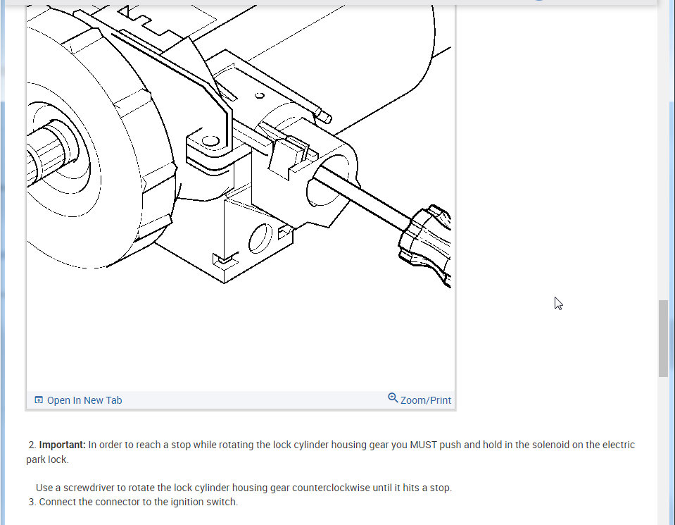

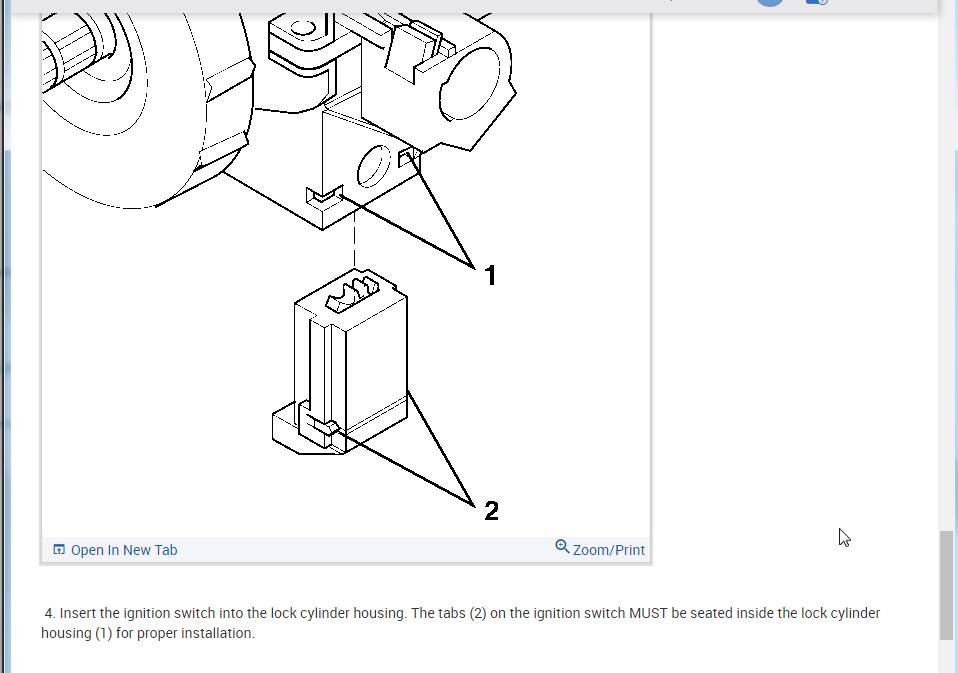

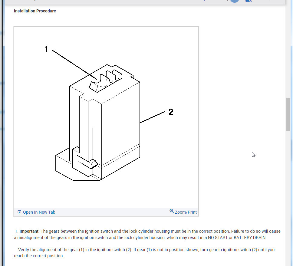

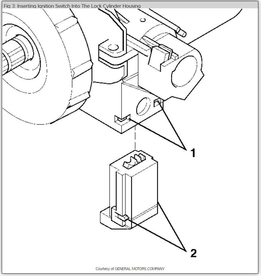

Important: The gears between the ignition switch and the lock cylinder housing must be in the correct position. Failure to do so will cause a misalignment of the gears in the ignition switch and the lock cylinder housing, which may result in a NO START or BATTERY DRAIN.

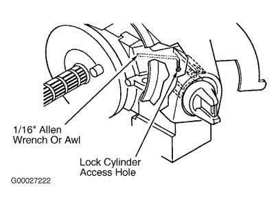

1. Use a screwdriver in order to rotate the lock cylinder housing gear clockwise to the START position.
2. Remove the screwdriver and allow the lock cylinder housing gear to spring return to the RUN position.

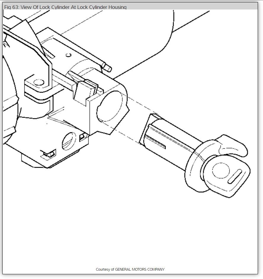

pic 4

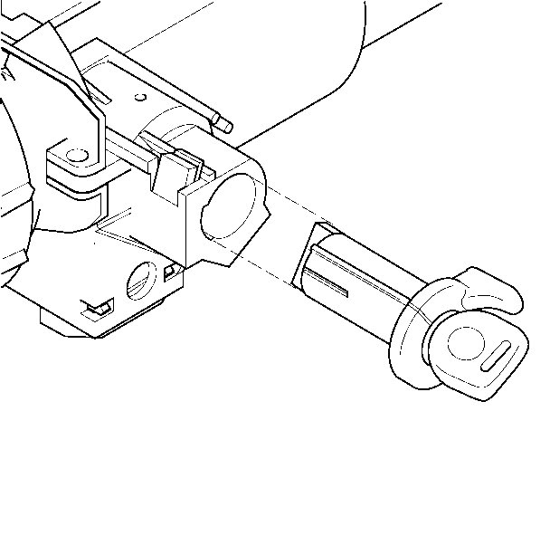

3. Install the key to the lock cylinder.
4. Align and install the lock cylinder to the lock cylinder housing.
5. Install the steering column trim covers. Refer to Steering Column Trim Cover Replacement.
6. Install the knee bolster.
7. Enable the SIR system.
8. Connect the negative battery cable.

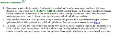

I changed my ignition key cylinder and now my new key wont come out of ignition. Still starts and runs fine. did fix the problem i was having the battery light wouldn't go out when i turned the car off.
Jun 3, 2021 at 3:21 AM (Merged)
  • 55,395 POSTS
It sounds like it is because the ignition tumbler if off one tooth. here are instructions to so show you how to fix the problem. Check out the diagrams (below). Please let us know what happens.

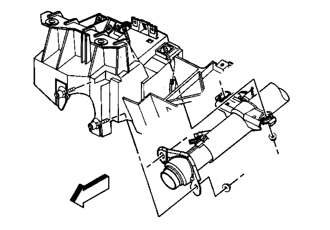

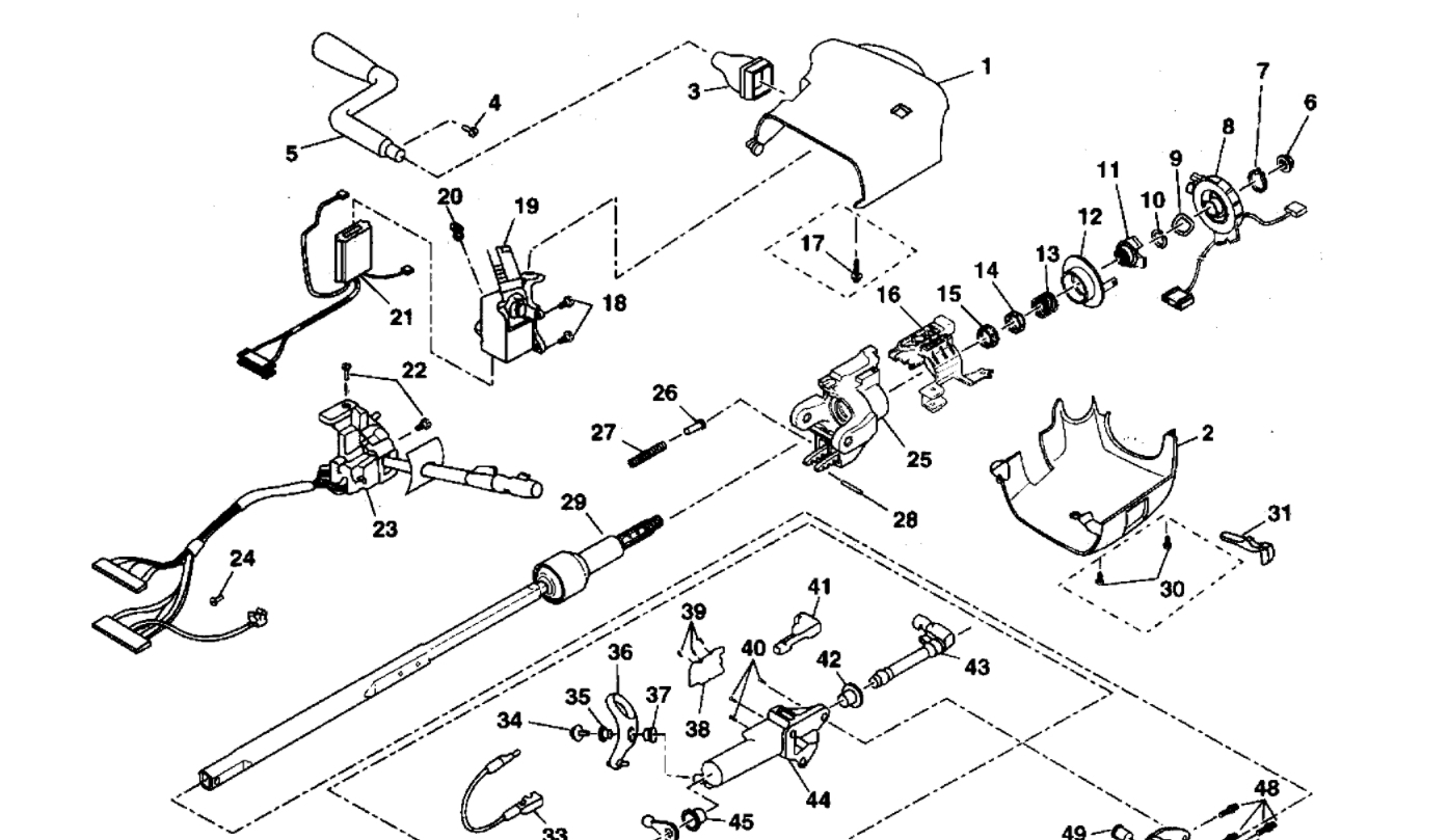

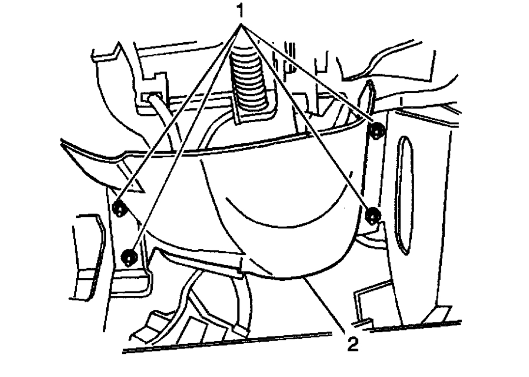

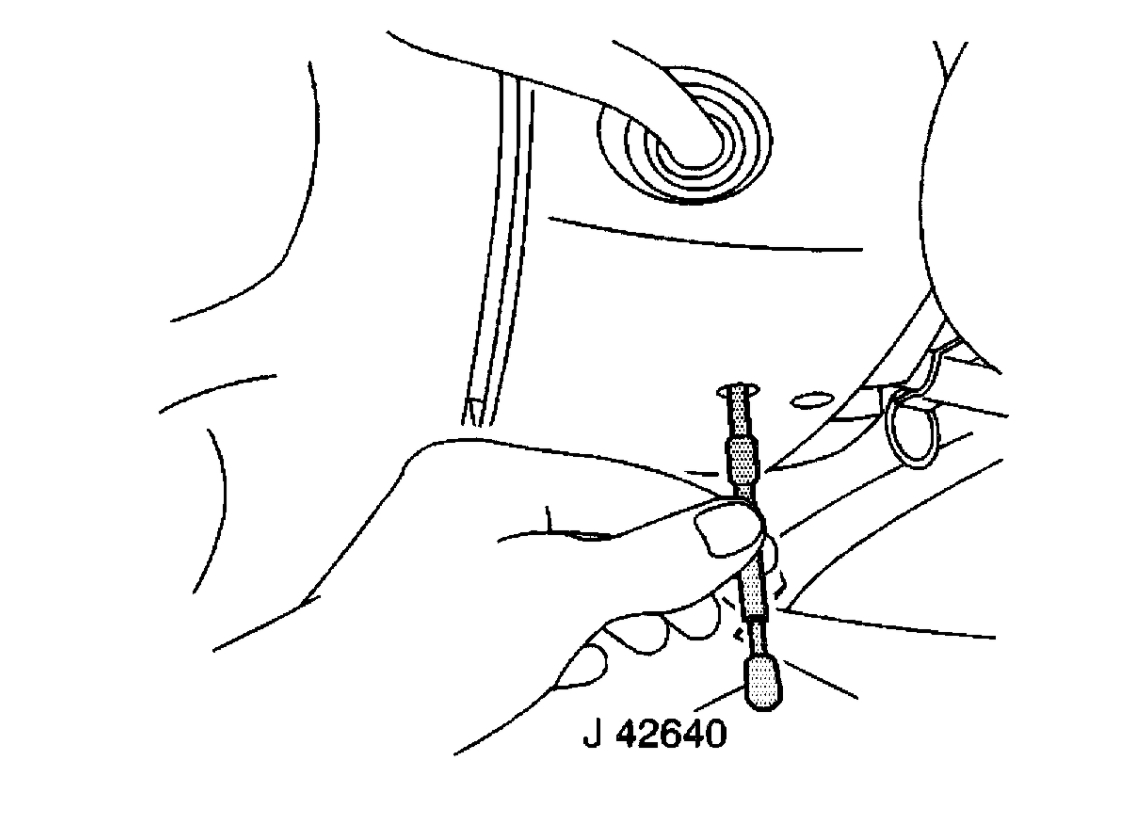

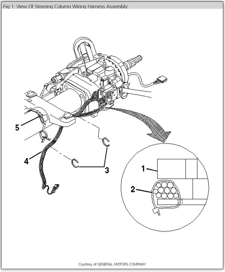

In most cases, it is easier to replace the column than repair it.I attached the procedure for you to view. The only thing that will need to be done is to program the key to the car. Check out the diagrams (Below). Please let us know what happens.
https://www.2carpros.com/articles/how-to-reset-a-security-system
Tools Required
J 42640 Steering Column Lock Pin
Removal Procedure
Notice: Once the steering column is removed from the vehicle, the column is extremely susceptible to damage. Dropping the column assembly on its end could collapse the steering shaft or loosen the plastic injections that maintain column rigidity. Leaning on the column assembly could cause the jacket to bend or deform. Any of the above damage could impair the columns collapsible design. If it is necessary to remove the steering wheel, refer to Steering Wheel. Under no condition should the end of the shaft be hammered on, as hammering could loosen the plastic injections which maintain column rigidity.
Notice: The front wheels of the vehicle must be maintained in the straight ahead position and the steering column must be in the LOCK position before disconnecting the steering column or intermediate shaft. Failure to follow these procedures will cause improper alignment of some components during installation and result in damage to the SIR coil assembly.
Caution: Refer to SIR Caution in Service Precautions.
1. Disable the Supplemental Inflatable Restraint (SIR) system. Refer to Disabling the SIR System in Restraint Systems.
2. Remove the knee bolster. Refer to Knee Bolster Replacement in Instrument Panel, Gauges and Warning Indicators.
3. Lock the steering column through the access hole in the lower steering column trim cover using the J 42640.

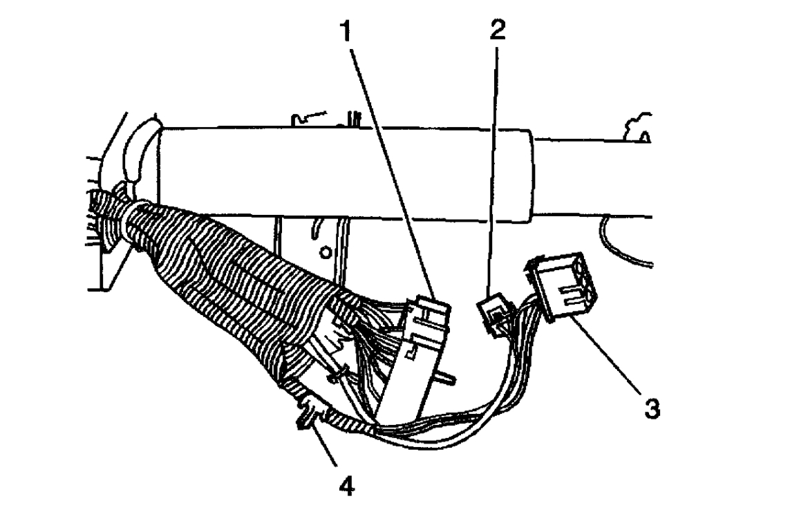

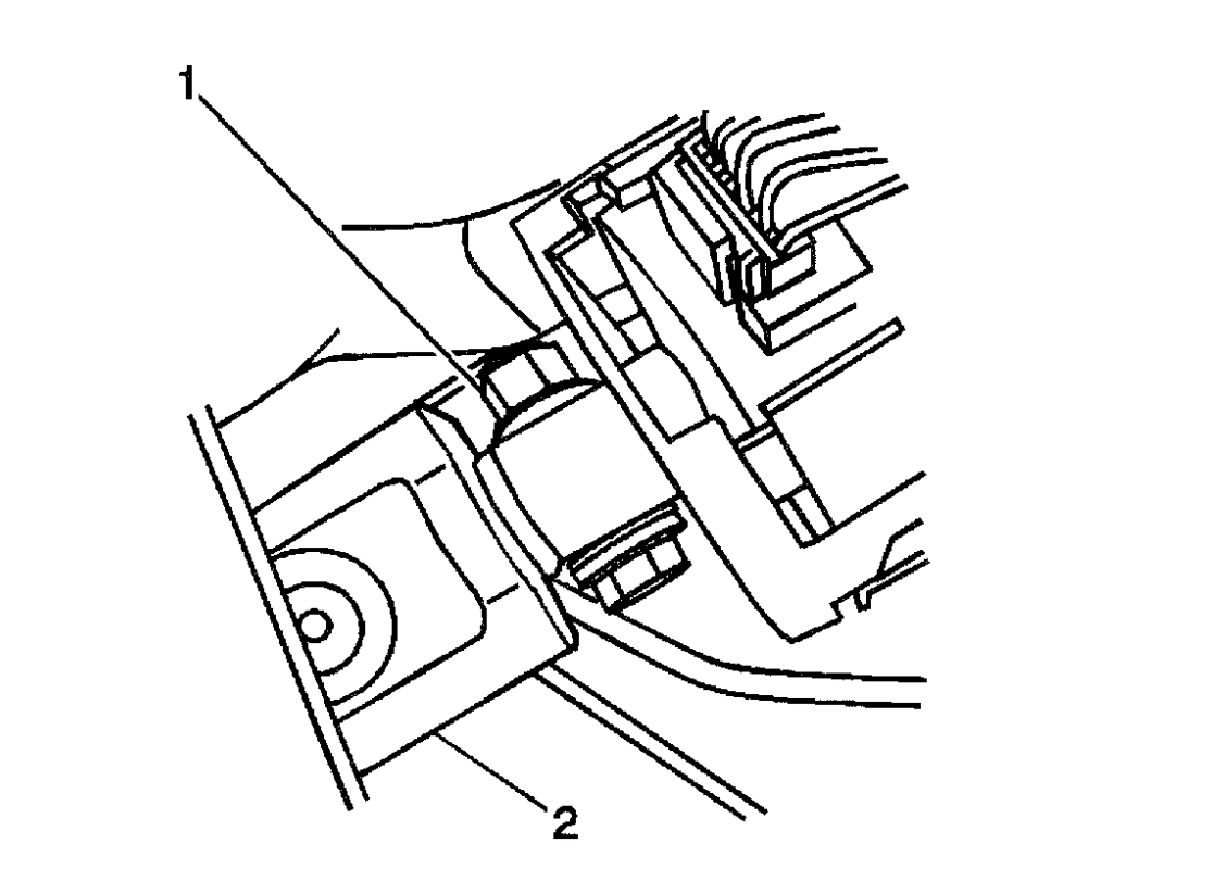

4. Remove the body control module bracket. Do not disconnect the harness from the body control module. Refer to Body Control Module Replacement in Powertrain Management.
5. Disconnect the transmission shift cable (1) from the steering column.

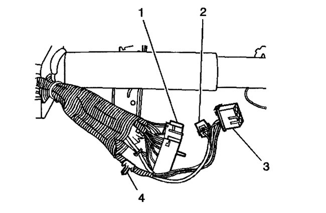

6. Disconnect the steering column electrical connectors.
Notice: During removal of the steering column the wire harness retaining clip must be removed and reinstalled after installing the steering column or damage may occur to the wire harness.
7. Remove the electrical harness retaining pin (4) from the instrument panel.
8. Remove the upper intermediate shaft pinch bolt (1) from the steering column to remove the intermediate shaft (2).
9. Remove the nuts (1) from the knee bolster deflector (2).
10. Remove the nuts from the upper support bracket.
11. Remove the steering column from the vehicle.

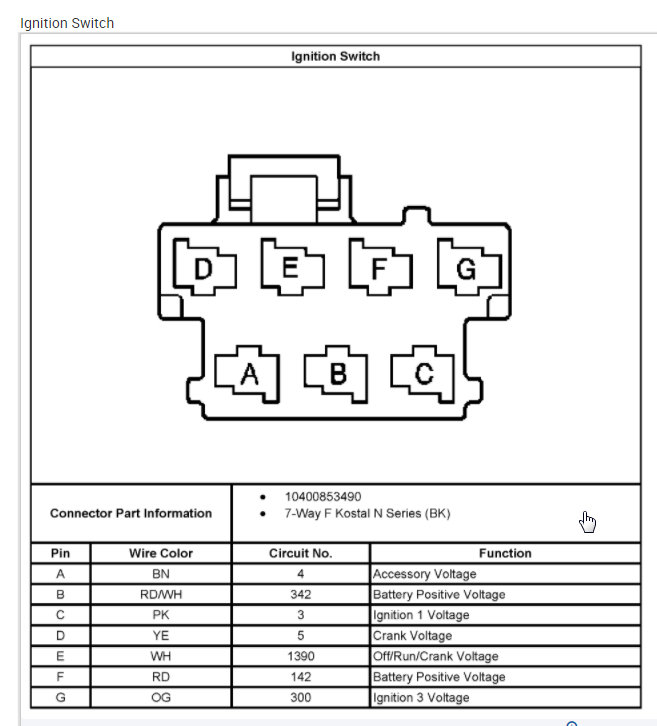

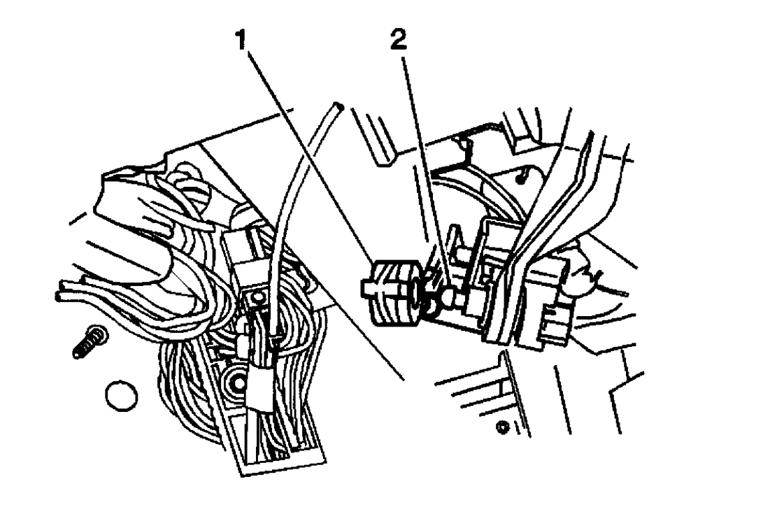

I'm trying to install a new ignition switch on my Tahoe. Is there a special tool needed? How do I install? Thanks in advance.
Jun 3, 2021 at 3:22 AM (Merged)
  • 55,395 POSTS

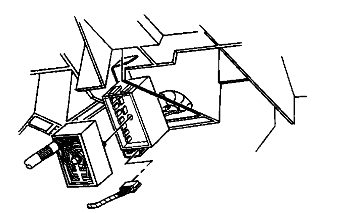

The job is not to bad there are a couple of torx screws that hold the switch on and a bolt through the lower wiring connector. Here are the diagram you need to get the ignition switch and tumbler replaced. Check out the diagrams (Below)Please let us know if you need anything else to get the problem fixed.
