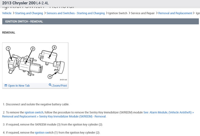

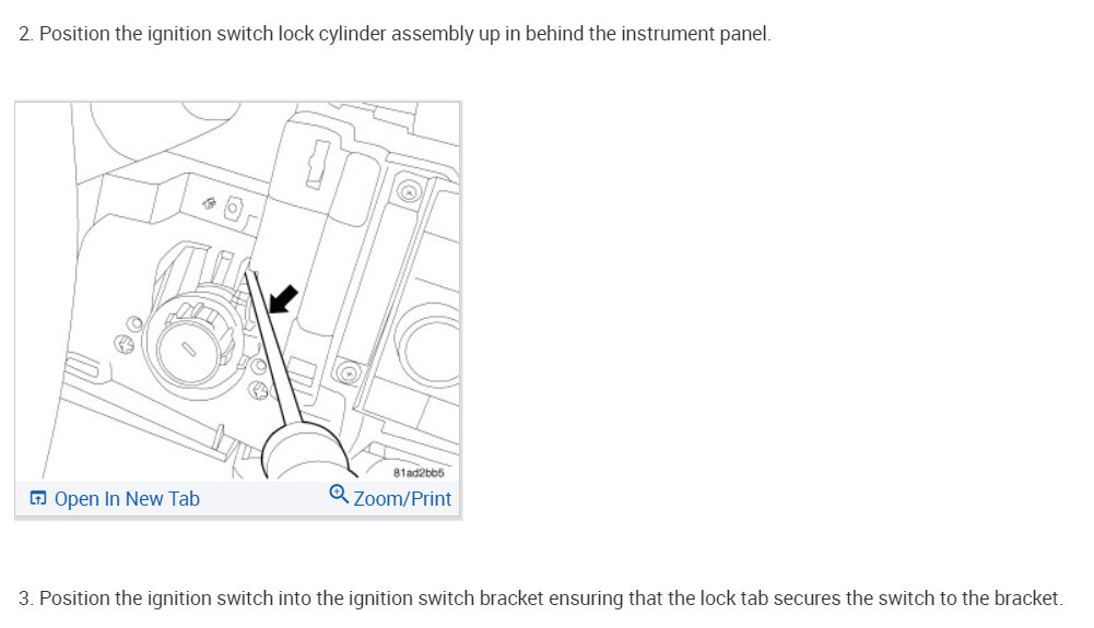

I lost the keys to my car and decided to try a hammer and screwdriver method. So, I completely ruined the cylinder lock of my mission assembly. I went to the junkyard and got an all-new Ignition assembly, switch, the transponder. Lock cylinder and key off of a Dodge Avenger, which they said it was compatible. But it doesn't start my car. It'll turn on everything but crank over. It will not crank over the red light is flashing on the inside. What should I do next?
Oct 13, 2023 at 1:00 AM
  • 55,395 POSTS

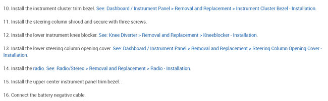

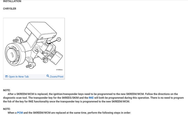

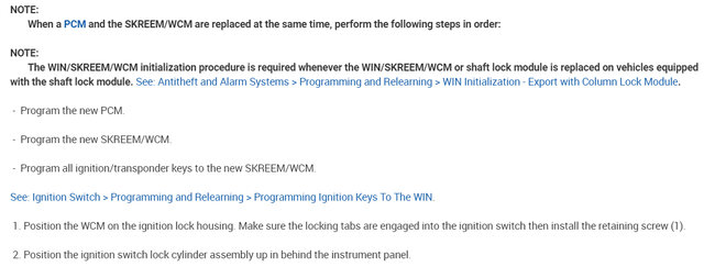

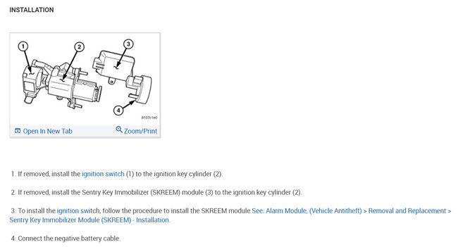

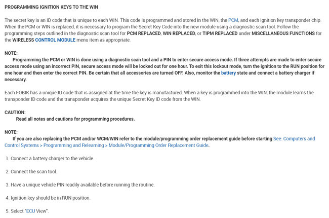

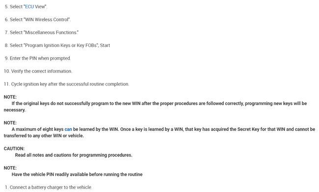

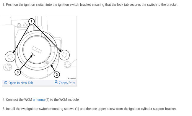

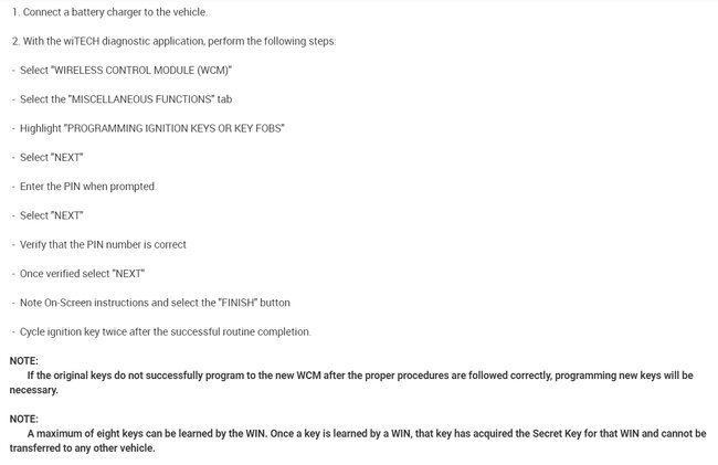

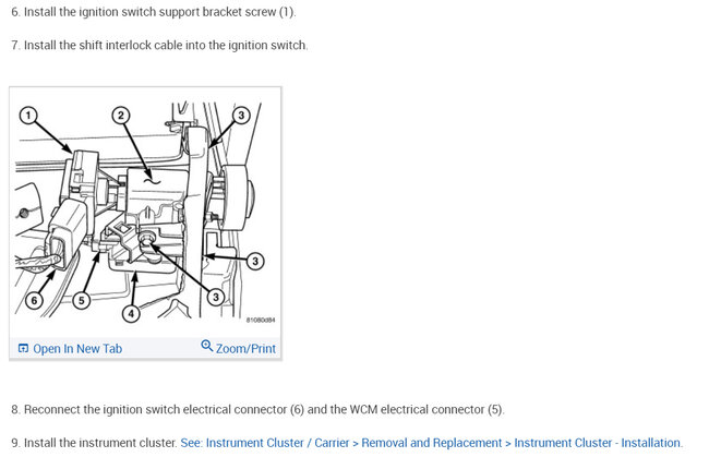

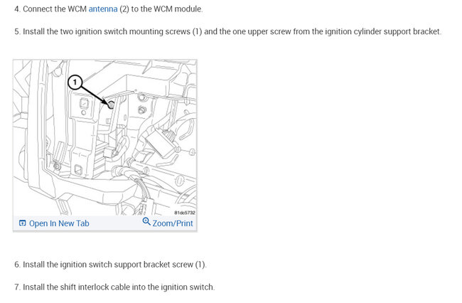

This is because the ignition key must be programmed to the car for it to work and satisfy the Skreem module. So now the car's security system has kicked in, this is why the security light is flashing. Here are the instructions on how to install the new ignition switch and key and how to reprogram the system. Check out the images (below). Please let us know what happens.
Oct 13, 2023 at 10:45 AM

Each chip is programmed to the car, I have seen people switch the chips but I am not sure if you can do that with your, I would dissemble the old key to see if you can find it, if not, you can have a mobile locksmith come out to do the job/program the ignition key it should cost about $250.00.

Each chip is individually programmed to the car so even if they look the same reprogramming is necessary or the security system will stay on.
