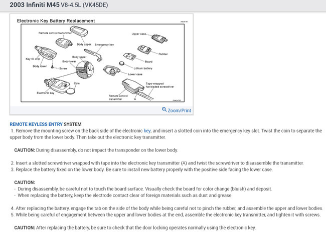

Changed battery in key fob, now will not turn in ignition and start car. Everything else on key fob works, also the extra key works.
Aug 2, 2018 at 8:21 AM
  • 55,694 POSTS

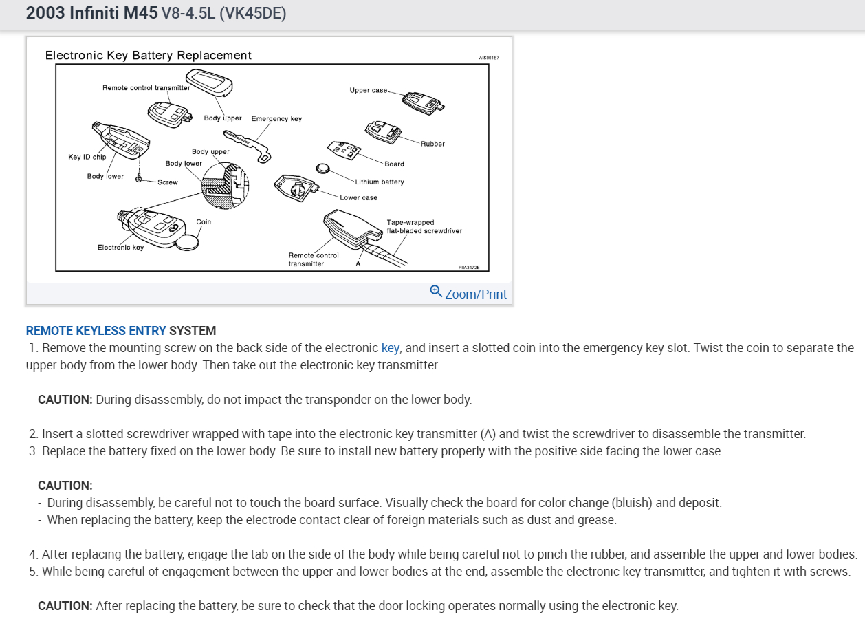

It sounds like you have the battery in upside down. Here is diagram to help you see how to change the battery. Check out the diagrams (below). Let us know what happens and please upload pictures or videos of the problem.
