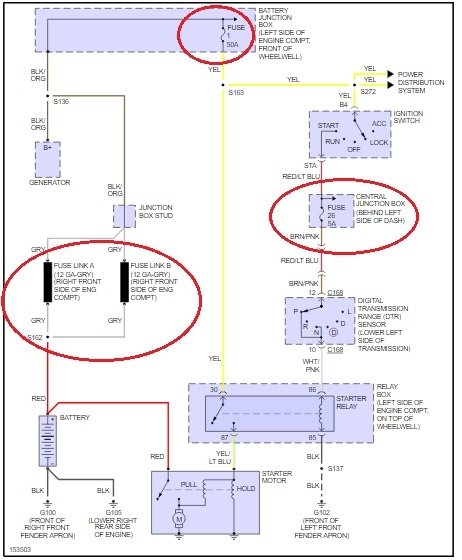

I pulled ignition fuse under the hood with engine running, I know stupid mistake. The car stopped. I replaced the fuse now the starter will not engage. Checked battery all good checked for voltage drop when switch is engaged but it has no effect on voltage meter.

I found a diagram for the "Starting Circuit" in "Prodemand"
I used the base model for my lookup (may be the same for all of their sub-models). If these are not looking right, I will look up the model you have.
Looks like there are two fuses and two fusible links in the diagram.
Let me (us) know what you find.
Maybe this will be real easy for you!
Click on the diagram below.

Thanks, I will check it out tomorrow and let you know.
