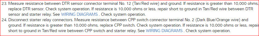

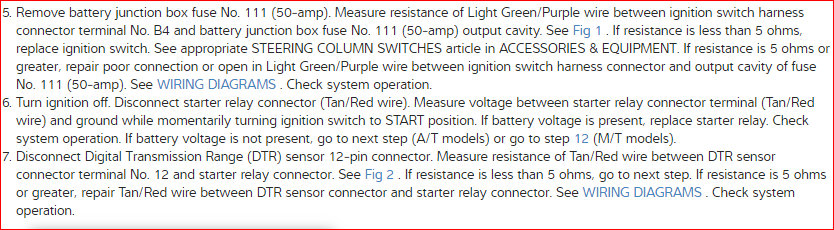

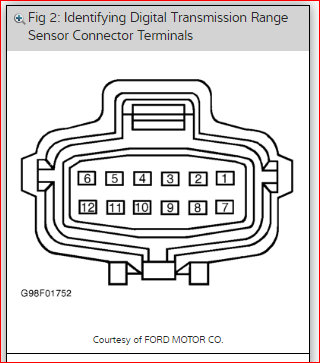

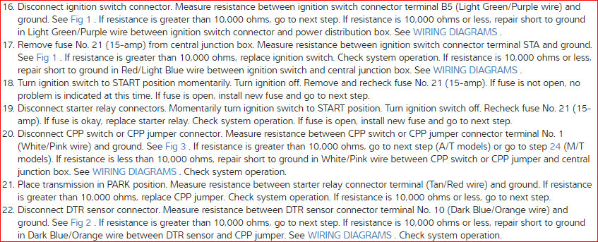

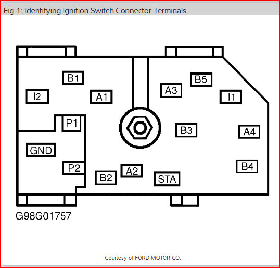

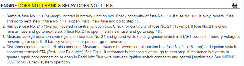

A few questions first. When trying to start do you hear the starter relay click? When cycling the ignition switch does it feel loose/sloppy? Is there a factory anti-theft system? Has Ignition switch ever been changed prior? Tampered with from vehicle theft? I am attaching a few test diagrams for you to test a few things. Hope this helps and let me know if you have any questions. Danny-

Yes, the relay clicks, no issues with sloppy/feel with the key engaged, to my knowledge, ignition switch/module has not been changed since I purchased the vehicle. Never have tampered with the anti-theft system. Will review the diagrams and update as soon as I can. Thanks for the reply.
