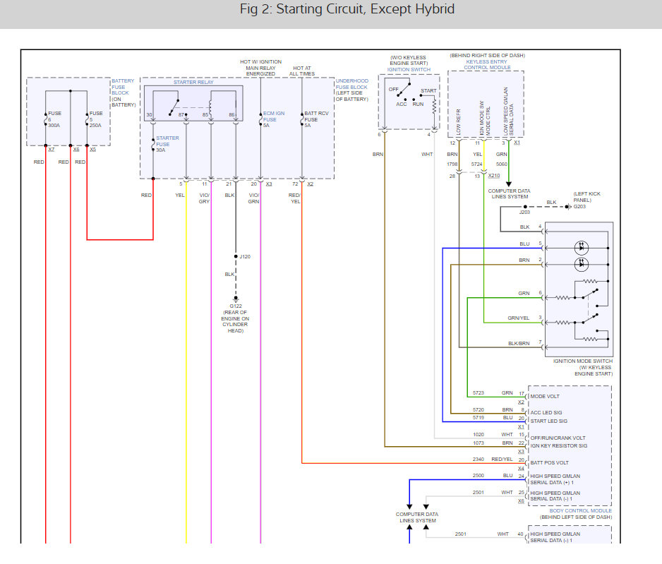

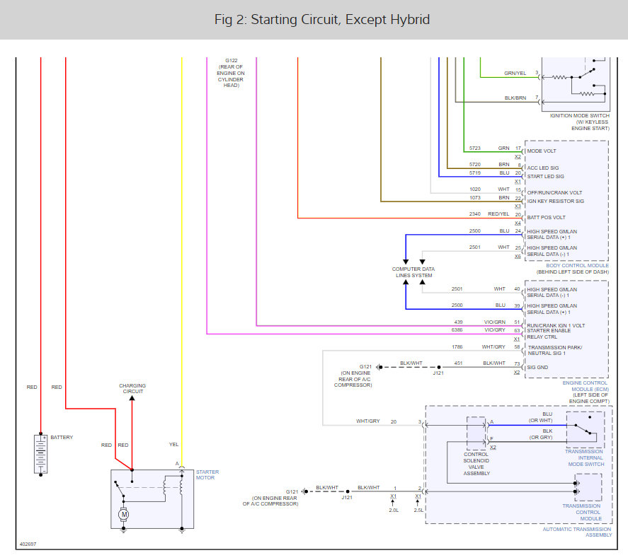

I have a very frustrating and confusing issue. I am trying to install a remote start, and need to wire it to the accessories and Ignition wires of the ignition wire harness. now the starter does not work?
Jan 21, 2018 at 11:50 AM
STEVE W.
  • 15,418 POSTS
it sounds like you have a starter trigger problem here is a guide to help confirm the issue with the starter wiring diagrams below.
and
Check out the diagrams (Below). Let us know what happens and please upload pictures or videos of the problem.
