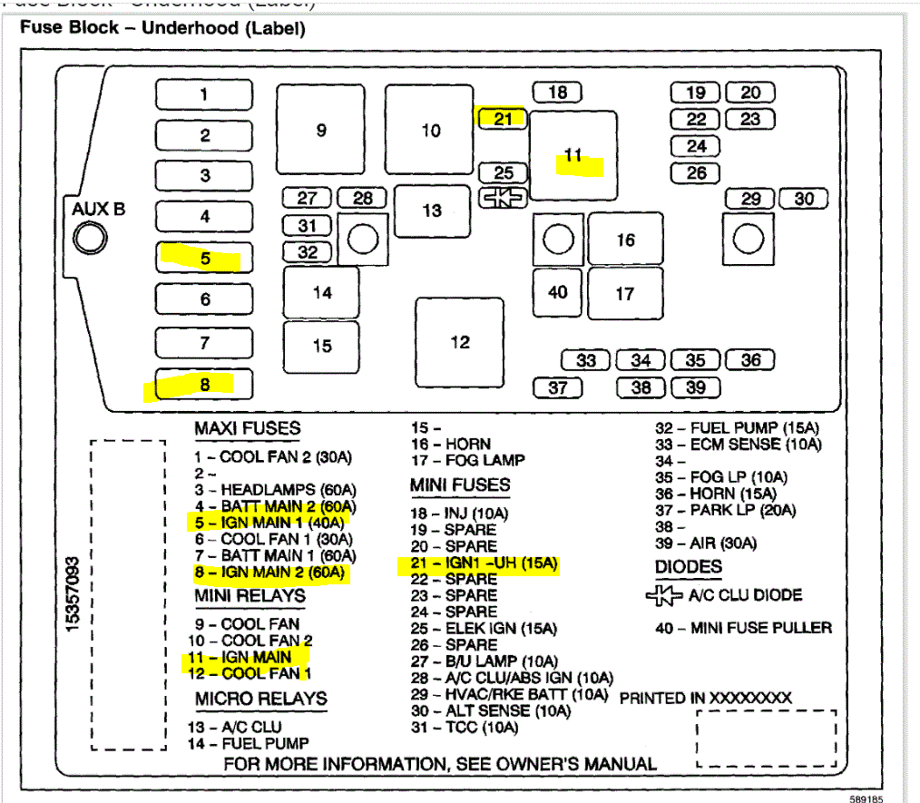

Every time I go to put the ignition fuse in it blows it. I also have a few fuses under the hood and next to the glove box that are showing they have negative current with the tester.
Feb 16, 2022 at 6:29 AM
  • 110,244 POSTS

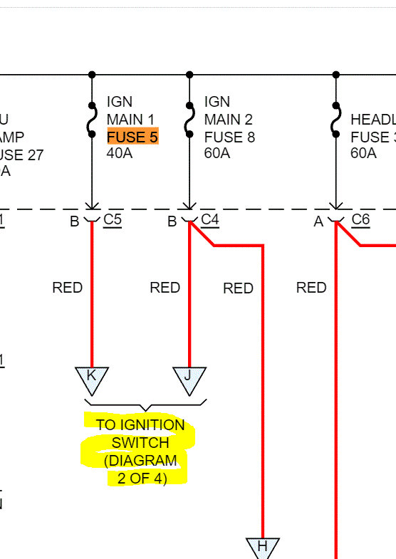

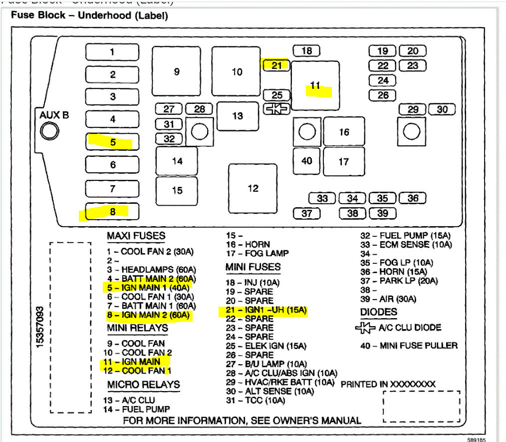

We have to have a short. Tell me, which ignition fuse are you having issues with? Take a look below, there are several labeled as ign.
Also, let me know which fuses are showing the polarity reversed. One last thing. Remove the fuse that is failing. One side of the connector in the box will have power and the other shouldn't. What I need you to do is determine which side has power. Then check the opposite side for continuity to ground. If you have continuity, we have a dead short at some point.
See pic below.

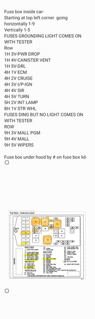

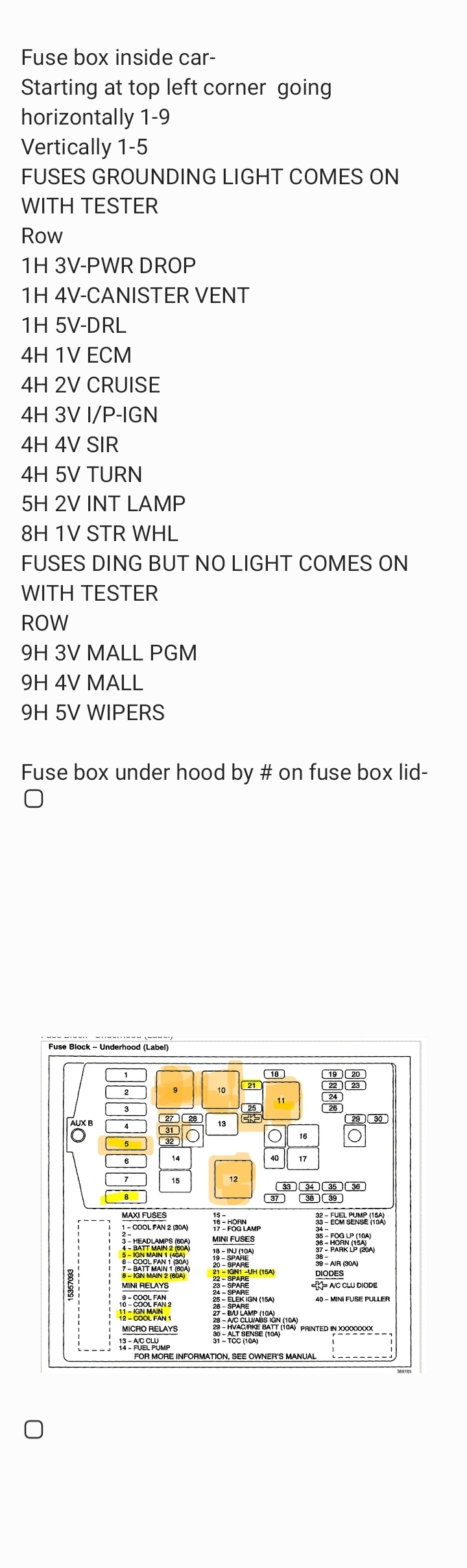

Below is the fuses grounding.
Feb 17, 2022 at 10:42 AM
  • 110,244 POSTS
I looked through the list and it is extensive. I'm not familiar with your tester. If the light comes on and the beep. What do they indicate?
Also, the reverse voltage simply could mean you have the wires on your voltmeter reversed allowing power to flow in a different direction.
Now, I noticed you highlighted the AC diode. I need you to check for continuity through the diode. It should only have continuity in one direction. If it, has it in both directions, it is bad. It is to allow power to flow in one direction only.
Let me know what you find.

Okay. so, when I put the light tester on the negative battery terminal nothing happens in either side of the fuse spot when I put it on the positive terminal at lights up on the right-hand side and on the left-hand side it lights up and clicks down towards the starter.

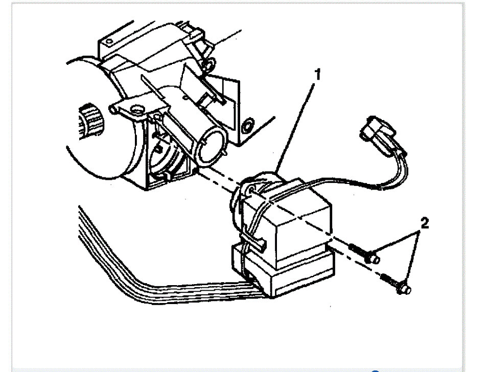

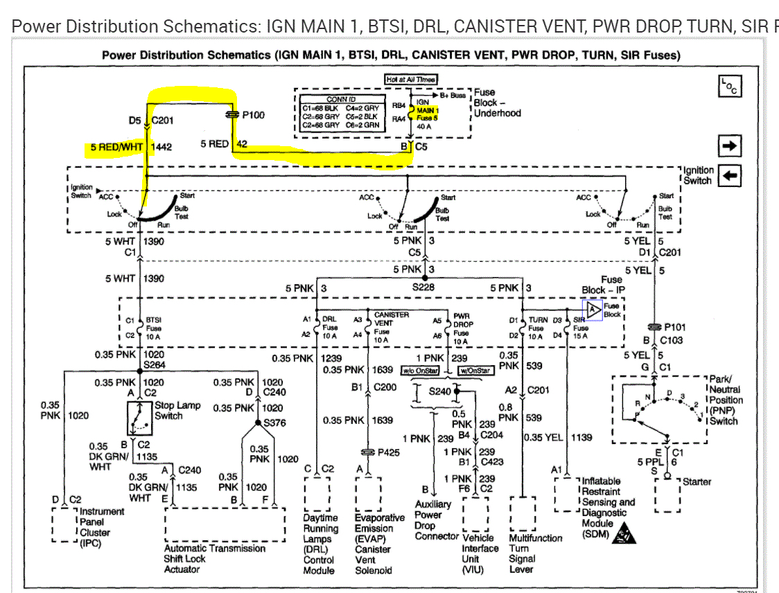

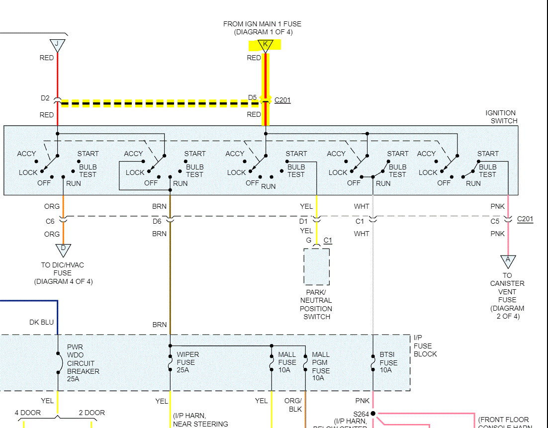

Okay, since it fails right away, it is between the fuse and the ignition switch. It could be the ignition switch. See the pics below.
Disconnect the negative battery terminal and then disconnect the connectors at the ignition switch. See pic 4.
Once disconnected, reattach the battery and install the fuse. Does it still fail? If not, it's likely the switch itself.
Feb 18, 2022 at 12:25 PM

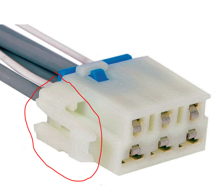

So how do you unhook the wiring? I can't find a way to undo the clip.
Feb 19, 2022 at 5:37 AM
  • 110,244 POSTS
It should have a traditional connector that clips. Take a look at the pic below. I believe that is what you should have. I circled where it should clip into the switch.
Let me know if this helps.
See pic.
