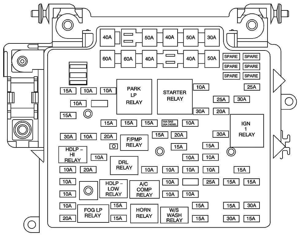

Had a no start no crank, towed to shop and replaced the starter. I picked her up and once I got her home the same thing happened. Called the shop and told them that the ignition fuse keeps popping and they said the new starter should have fixed it but since it didn't, they would have to run a full electrical diagnostic. Sounds a little shady, so I replaced all the ignition fuses, starter relay, ignition relay, made sure the battery is tightly secured, checked the fuse box wiring and made sure the starter wiring was secure. Yet this continues. I have to replace one 10-amp fuse to start her now. Is there something I am overlooking?

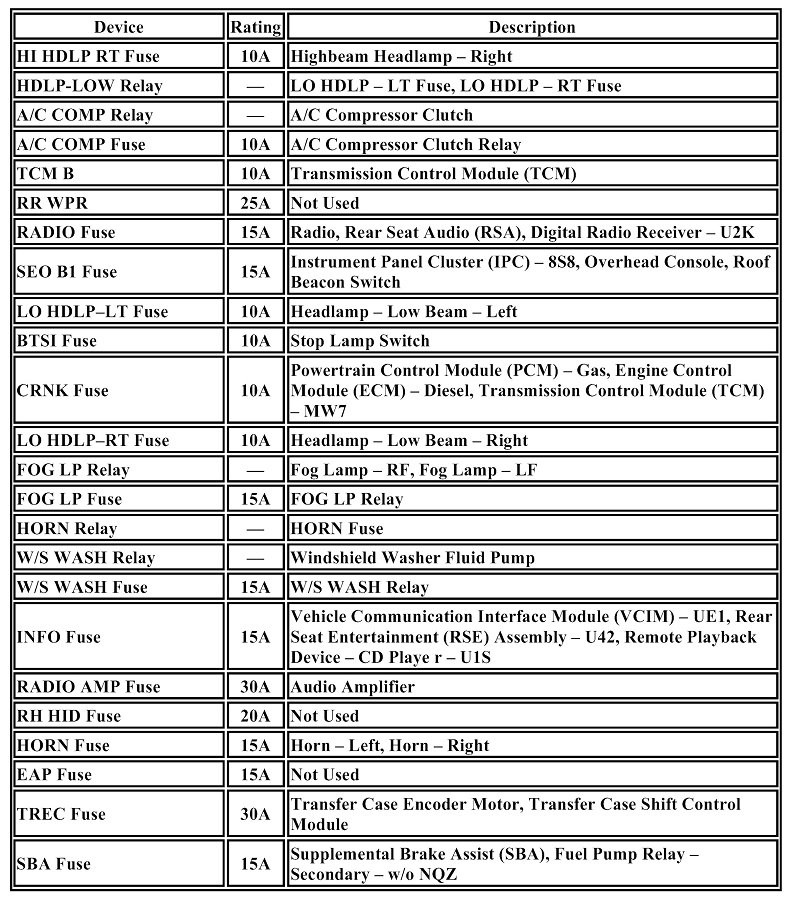

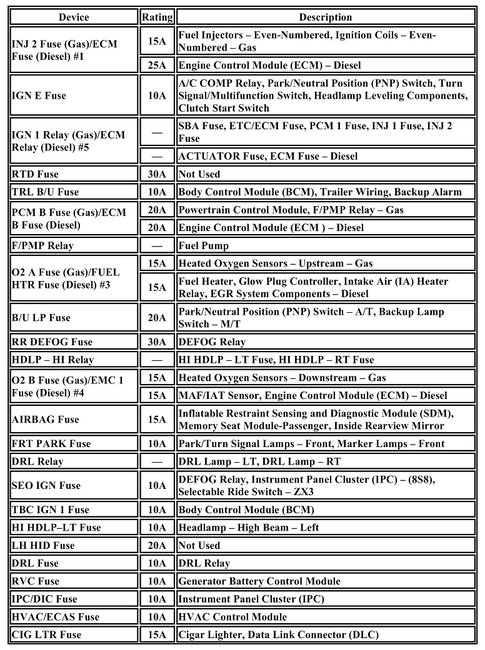

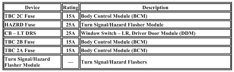

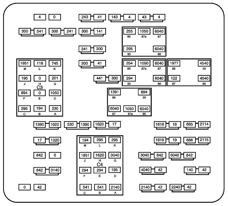

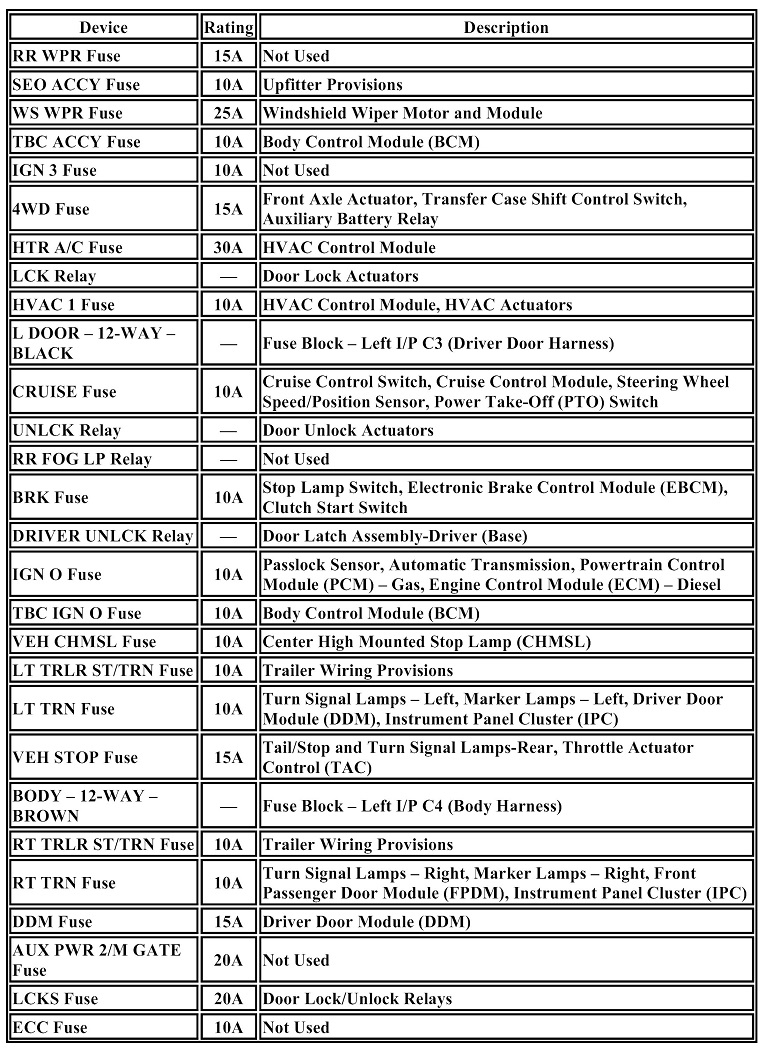

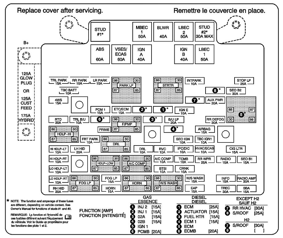

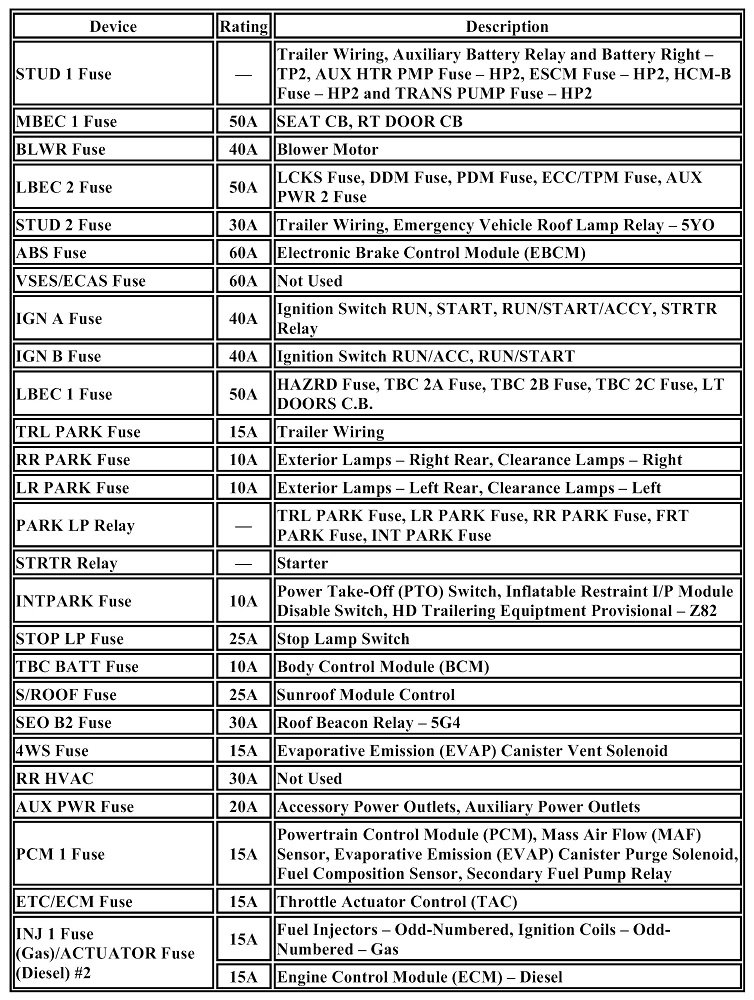

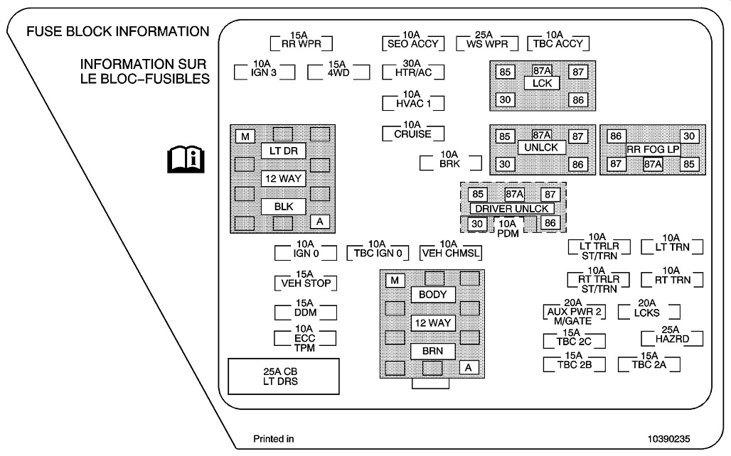

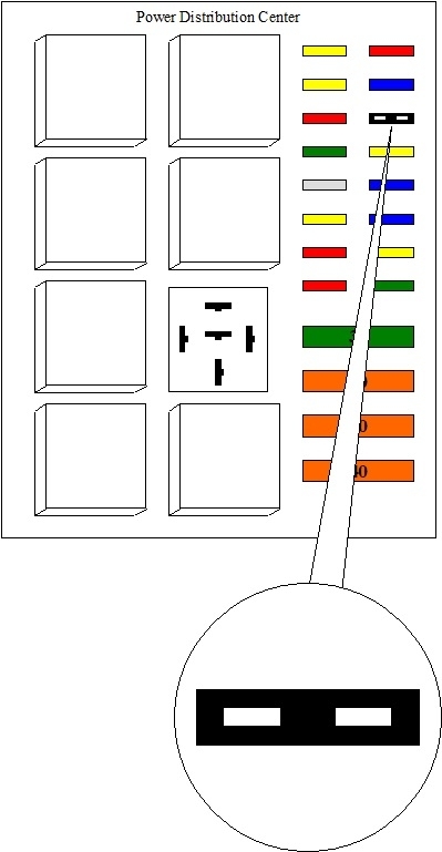

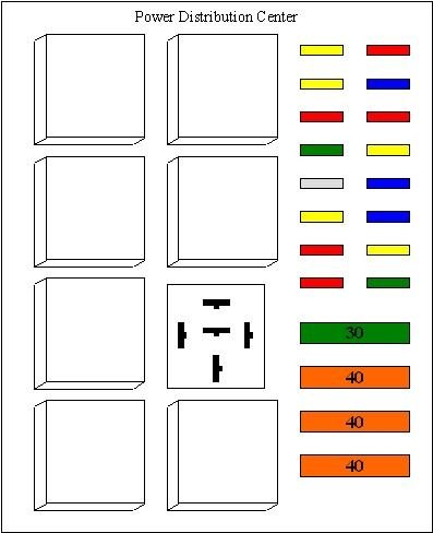

The first thing we need to do is identify exactly which fuse is blowing. See if you can identify the fuse from these drawings. The first five are for the under-hood fuse box. The last five are for the fuse box at the left end of the instrument panel.

JEREMIAHMESSENGER

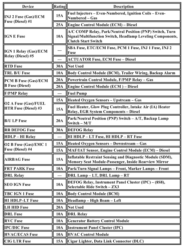

It is the 10 amp ignition fuse right below the starter relay.
Jun 24, 2022 at 2:37 PM
JEREMIAHMESSENGER
Ign E.
CARADIODOC
  • 34,381 POSTS

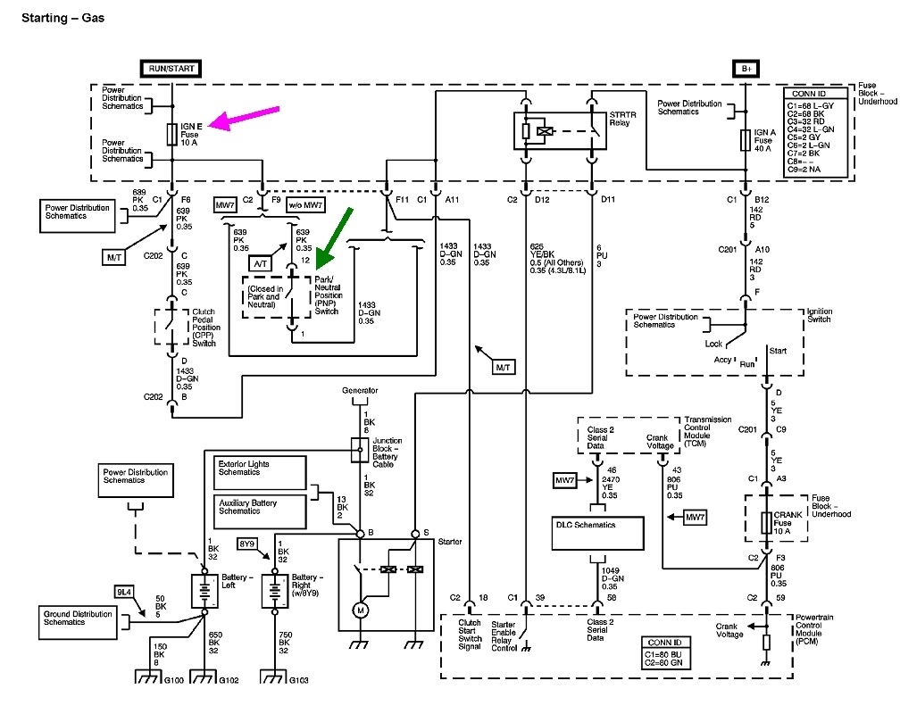

How often does this fuse blow? Is there anything you can do to cause it to blow?
I found this diagram showing some of what this fuse feeds. The main thing is the neutral safety switch in the starter circuit. I also found a reference to it going to the instrument cluster, but I haven't found which circuit it feeds.
With such little to go on so far, the best place to start is by inspecting the wiring harness going down to the transmission. Look for the black wrap chewed away in one area, or the harness has been rubbing against something and worn through the insulation of some wires.

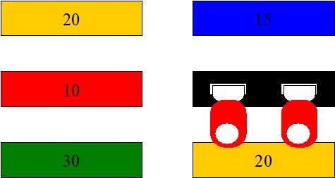

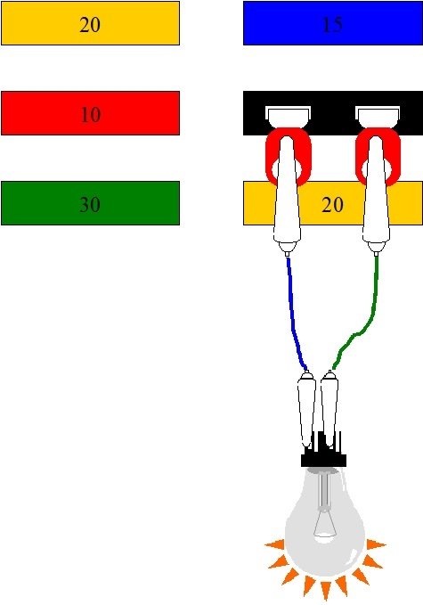

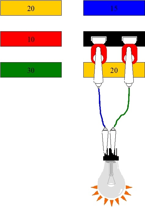

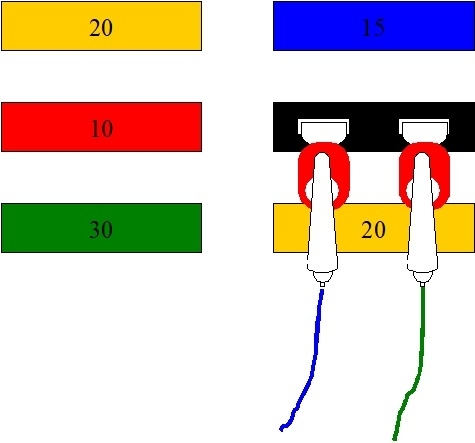

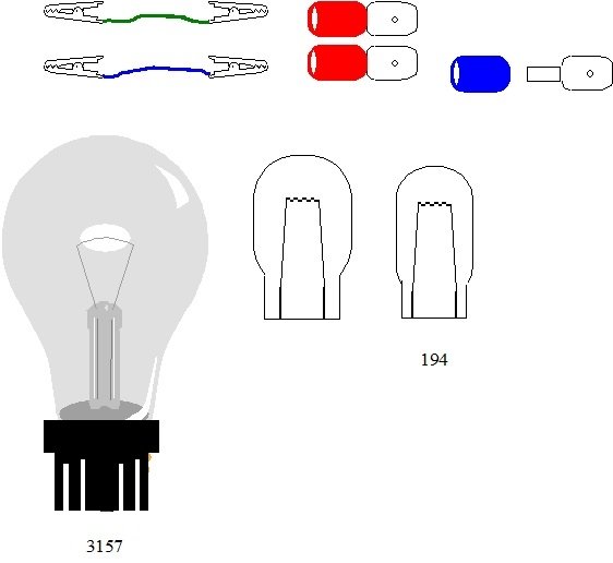

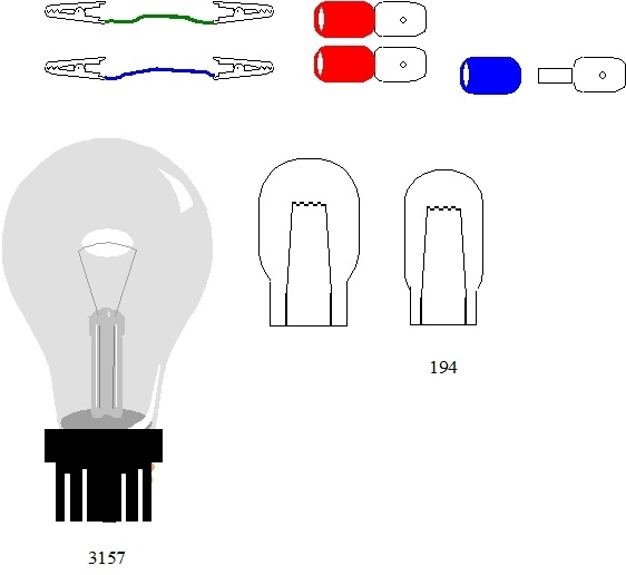

The next step is the trick I mentioned earlier. That is to replace the blown fuse with a light bulb. When the short occurs, the bulb will be full, normal brightness and hot, so be careful what it's laying against. It will also give a nice indication of current flow through that circuit, and it avoids wasting a lot of fuses. I drew up these drawings to explain the procedure. A common 3157 brake light bulb should work fine for this. It will allow a maximum of one amp of current to flow when the short is present. It is possible the circuit, or parts of it, will not function properly due to the bulb's resistance, but it will allow you to work in the area.
With the bulb in place, move or wiggle wire harnesses, turn on various switches, or do anything else that might make the short occur. When it does, the bulb will become bright. If you're lucky enough to get it to stay that way, very gently move things around until it dims. That will tell you you're in the area of the short. I've also found sheet metal screws run through wiring harnesses by banging on the body with a rubber hammer.
