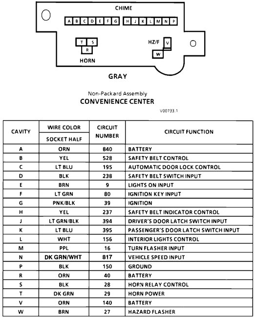

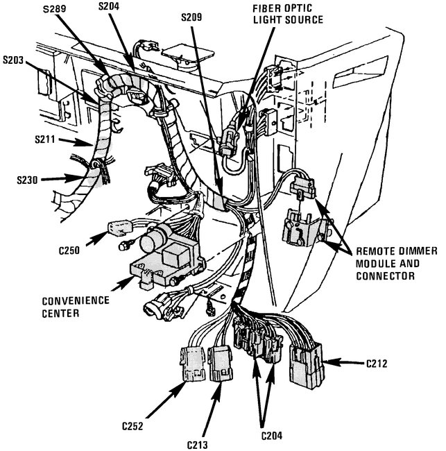

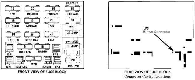

Where is the ignition fuse and ignition relay?
Dec 20, 2018 at 4:07 PM
  • 110,194 POSTS
The ignition relay is located in the convenience box behind the instrument panel. I attached two pictures for this. The one shows the panel and the other indicates relay locations within that panel. The third picture shows the fuse box and note that the bottom left two fuses indicate ignition.
