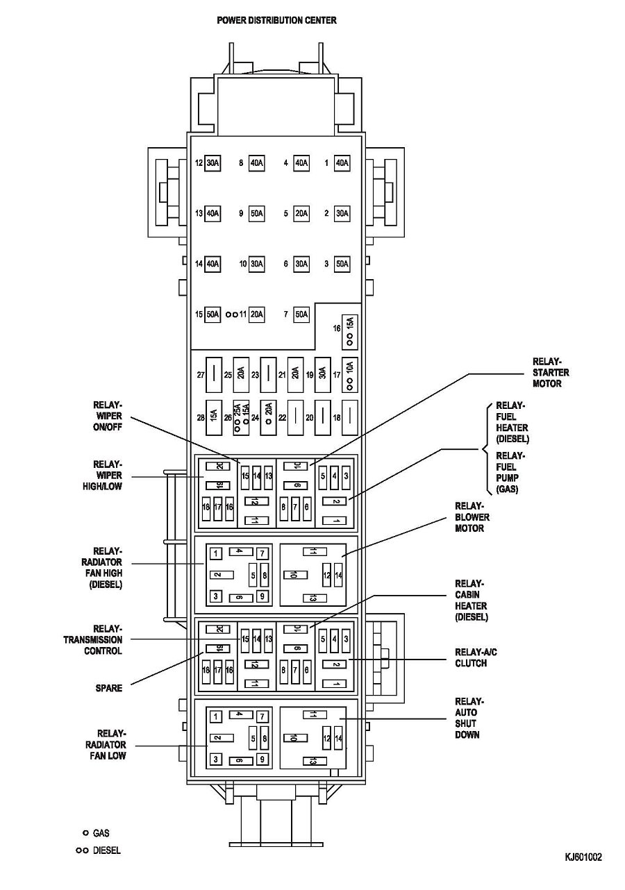

Now, since the problem seems to be related to the starter not working, we have a couple possible issues. First, I want you to locate the starter relay. It is under the hood in the power distribution box. I attached a picture of the relay /. fuse box which indicates which one is the relay. Once you locate the relay, switch it with another one with the same part number located in the box. See if the car then starts. Also, if you would rather check the relay itself, here is a link that shows how to test a relay. Additionally, I have attached a few links that will help you to test the relay.

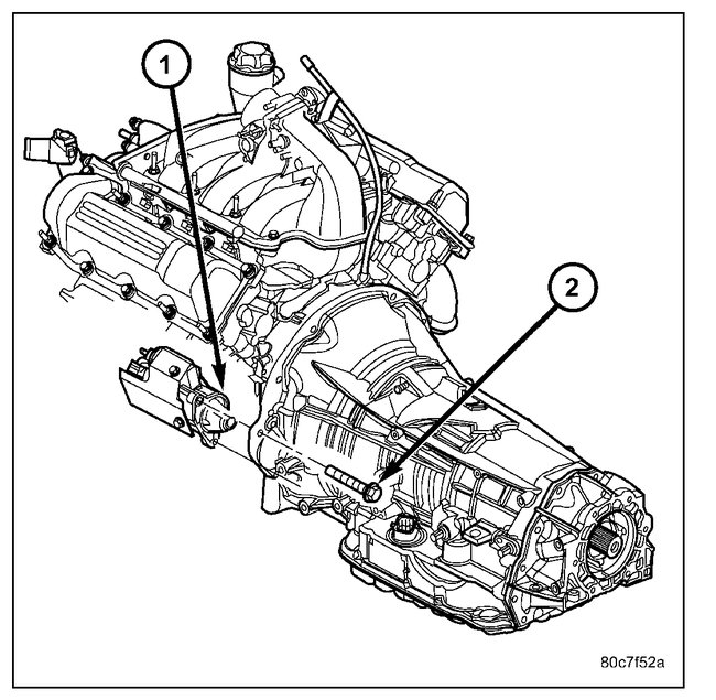

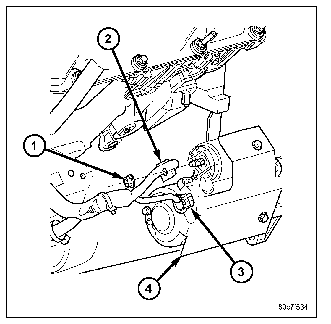

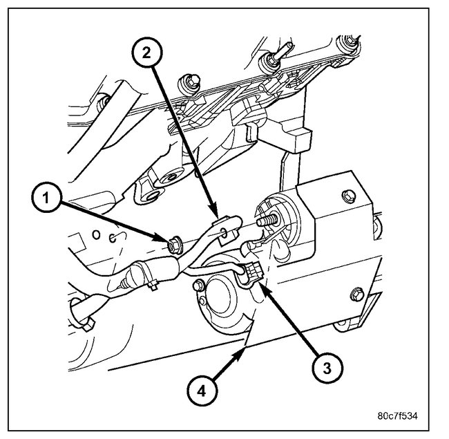

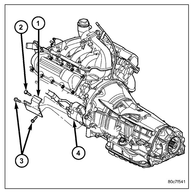

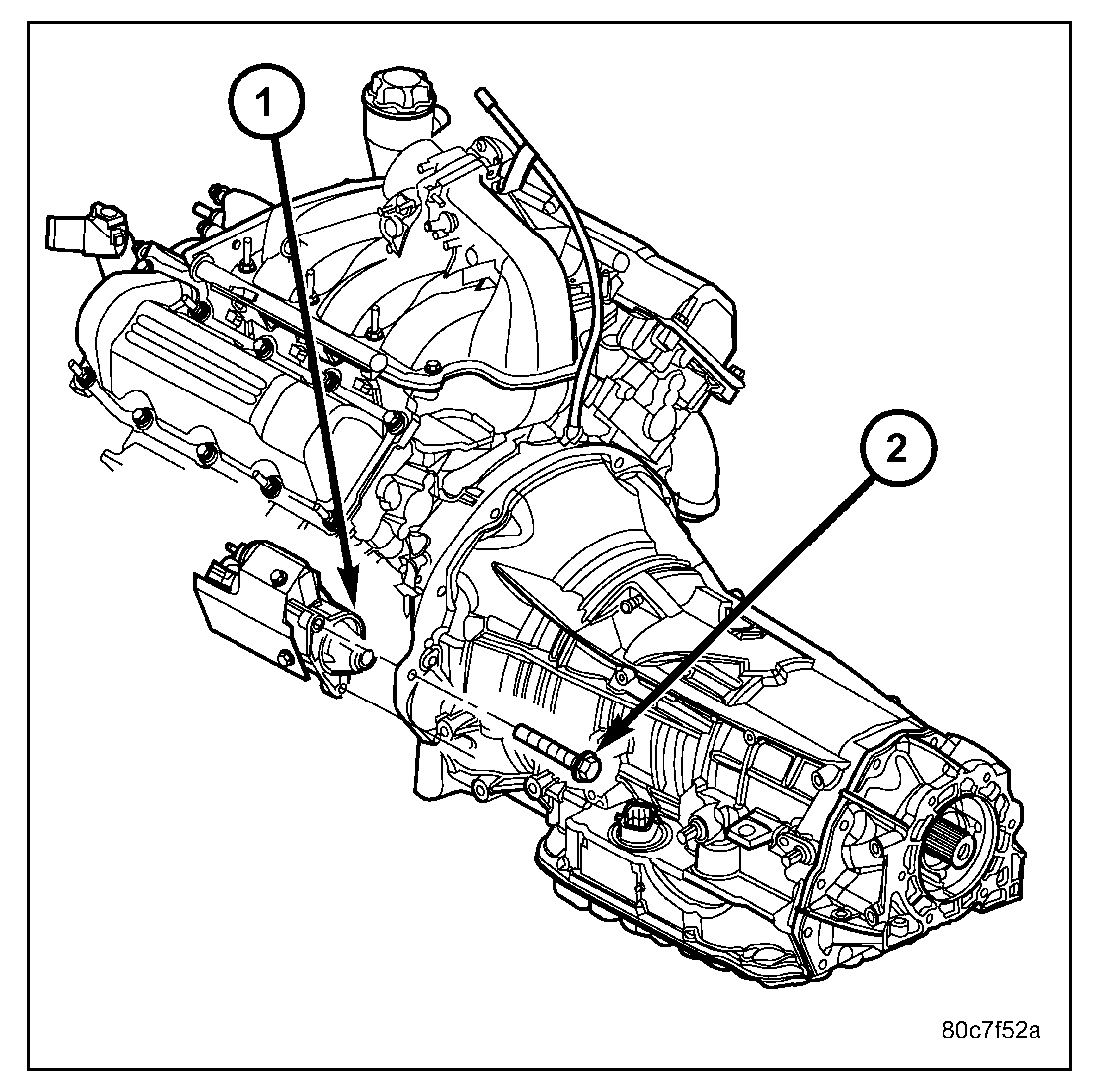

Here are directions for starter replacement specific to your vehicle. The remaining pictures, starting with number 2, correlate with these directions.

pic 2
5. Remove two starter heat shield bolts (3) at side of starter.
6. Remove starter heat shield nut at front of starter.
7. Remove starter heat shield.
pic 3
8. Remove solenoid wire connector (3) from solenoid terminal.
9. Remove battery cable eyelet (2) from stud on starter solenoid.
pic 4
10. Remove two starter mounting bolts (2).
11. Position front of starter to face rear of vehicle. Rotate starter until solenoid position is located below starter.
12. Remove starter from vehicle by passing it between exhaust pipe and transmission bellhousing.
INSTALLATION
1. Position front of starter towards rear of vehicle with solenoid position rotated until it is located below starter. Install starter by passing it between exhaust pipe and transmission bellhousing.
pic 5
2. Position starter into bellhousing and install two bolts (2) and tighten to 54 N.m (40 ft. lbs.).
