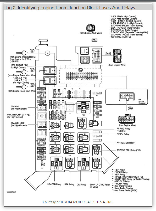

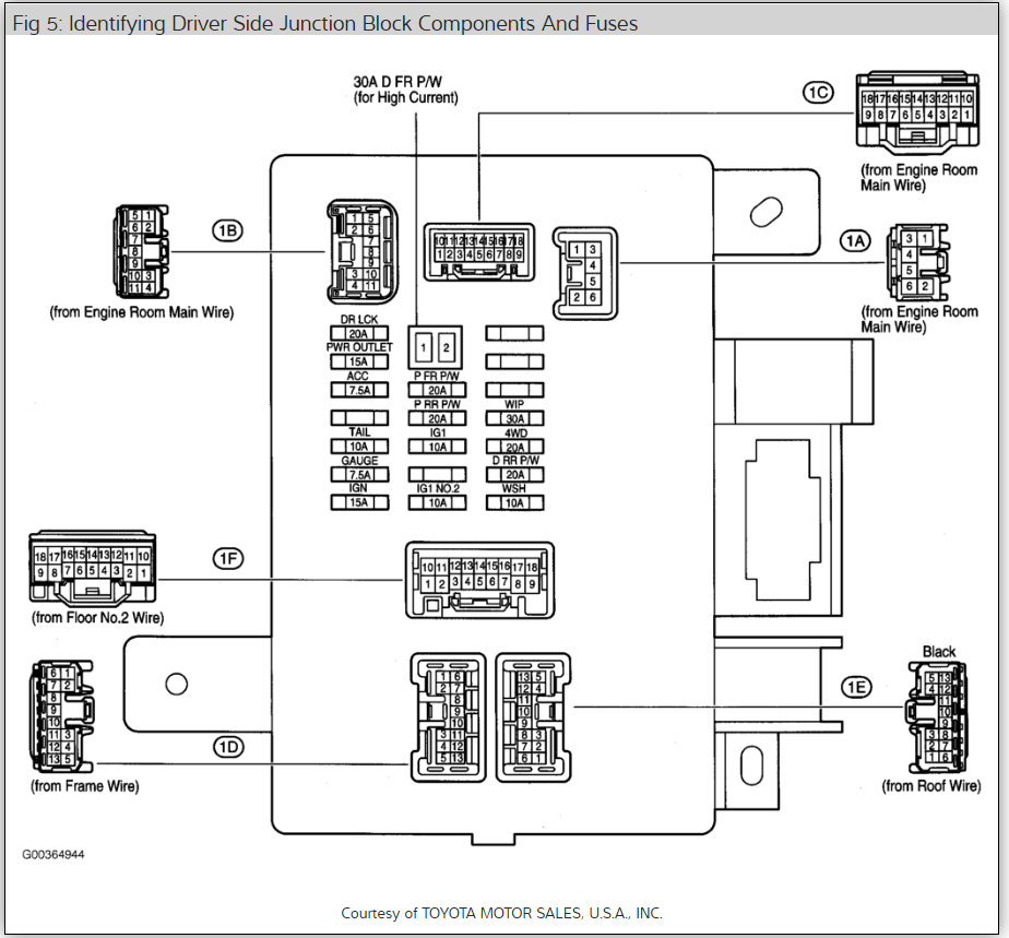

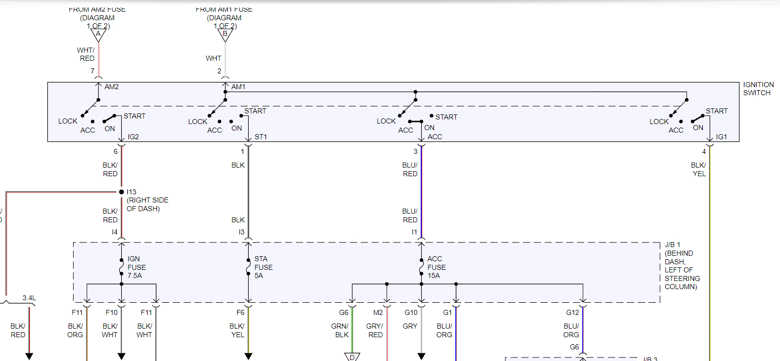

Gas, temp gauge, speedometer, turn signals, wipers don't work. I have new battery, new starter, new alternator. code P0500 comes up and P0300 comes up. also new plugs.
Jul 26, 2019 at 5:43 AM
  • 55,732 POSTS

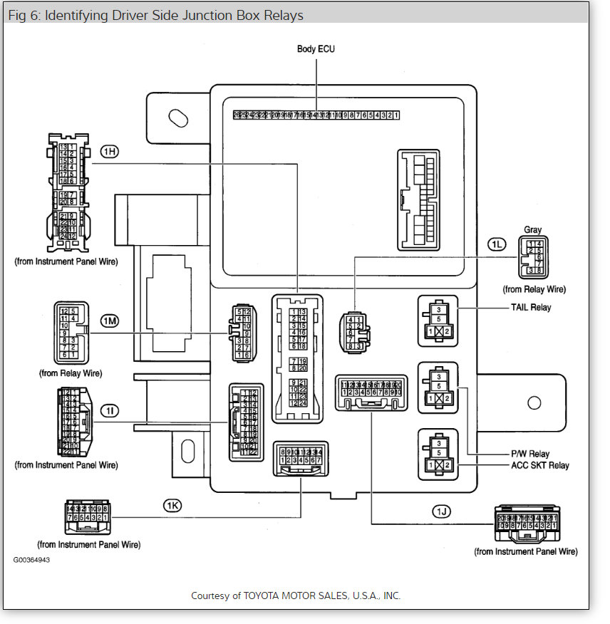

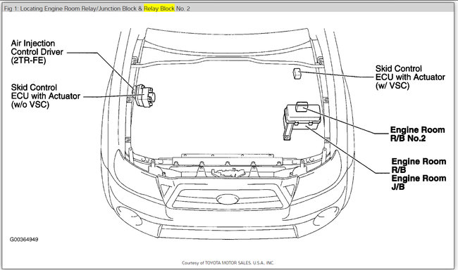

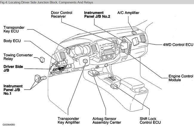

It sounds like you have an ignition switch that is out. To be sure here is a guide to help you check for power outputs with the wiring diagrams so you can see how it works. Also we should check all fuses. here is a guide and the fuse location as well:
and
