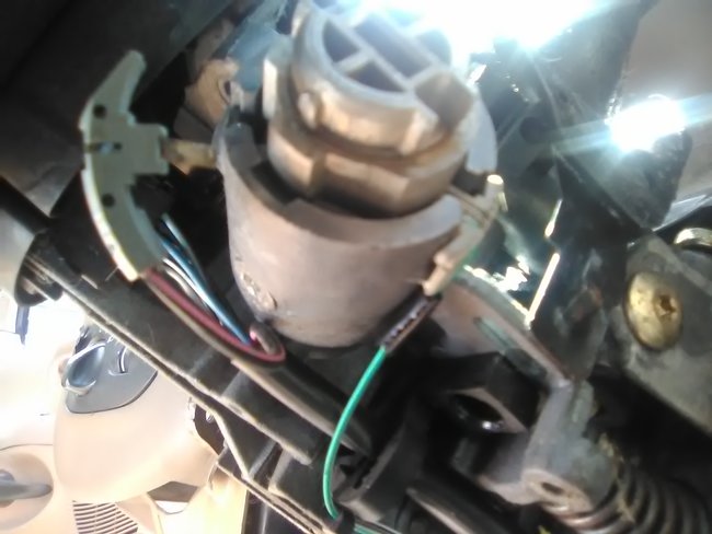

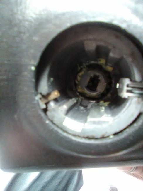

I recently bought the truck listed above. I bought it with some problems now my problems. I replace the GEM module, I figured it's always good to replace the solenoid if you have to jump it to start the truck. I also replaced the lock cylinder in the steering column, herein lies my problem: I went to Advance Auto and bought one of their "Exact fit" ignition lock cylinders. It didn't exactly fit, halfway in the cylinder jammed up! With a lot of sweat and cursing I finally got it out. I went to another auto parts store and got the right fit. When I was examining the housing to see if any damage occurred I noticed that the two contacts inside the housing that make to the lock cylinder we're broken off! Obviously they're important what are they for and maybe you could you tell me what they are called where where they connect because I can't find that information anywhere. I might be wrong but I assume they go to the ignition switch they're so tiny and they just fit into the housing just perfectly I don't want to screw anything up how do I go about replacing them or do I have to replace the entire housing? This and many more questions can be yours before I push the truck off a cliff! Thanks for any help you can give me on this guy's. I really am stumped P.S the image below is not of my housing it was pulled off the net but those copper contacts appear to be the same position different style but same position.

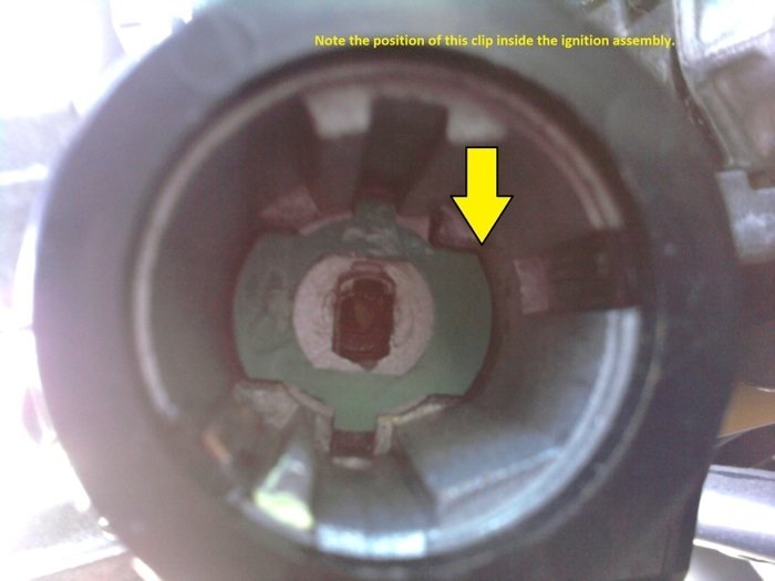

Your picture really didn't show much, but I'm thinking that the piece you are talking about is the retainer. In the diagrams down below I have included a detailed exploded diagram of the steering column. It should have the piece you are talking about on it. Please find it and get back to us with what it is and how things are progressing with this situation. If you have any other vehicle related questions, please, feel free to ask. That is what we are here for.

I attached the picture of the ignition with the new lock cylinder installed and the wires hanging free. my condition is I have a no crank no start. I replaced the gem module / PCM relay /starter relay and I have no joy. I got a multi-meter and a small tool set I'm having a whole lot of fun in the sun if you help me out I'd appreciate it.

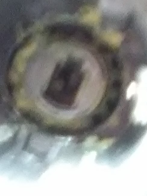

Ignition pictures.

Okay, so you have replaced the ignition cylinder lock and the Power-train Control Module (PCM). Did you have the ignition keys programmed to the PCM at either the Ford dealership or by a locksmith?

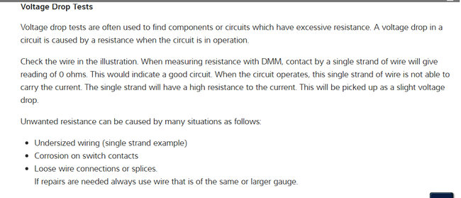

Okay, I understand. This can be very frustrating, and we will get this fixed with a little patience. We are here to help you get your vehicle fixed, so please, do you have battery voltage (12-12.6 volts) at pin for the control side (electromagnetic coil) of the relay. Please follow the directions that were previously included as to find the correct pin on the relay. I have also included instructions on how to do a voltage drop test in the diagrams down below. Please go through the guide and check for voltage and please get back to us with the answer.
