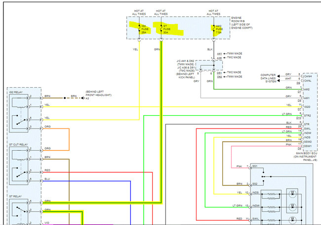

My vehicle has not been turning ignition on when I depress brake pedal and press the engine start button. I have changed the main body ECU to see if it solved the problem but it didn't. I change the engine the engine start button but it didn't solved it. What could be component or which harness is short causing this problem?

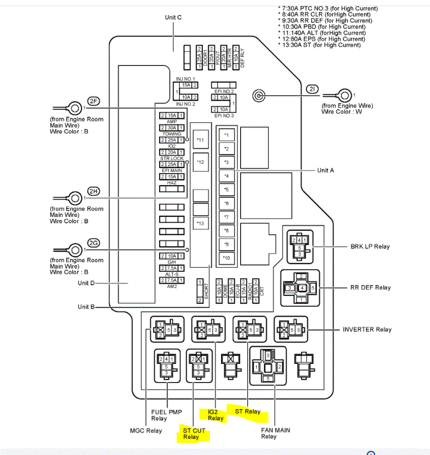

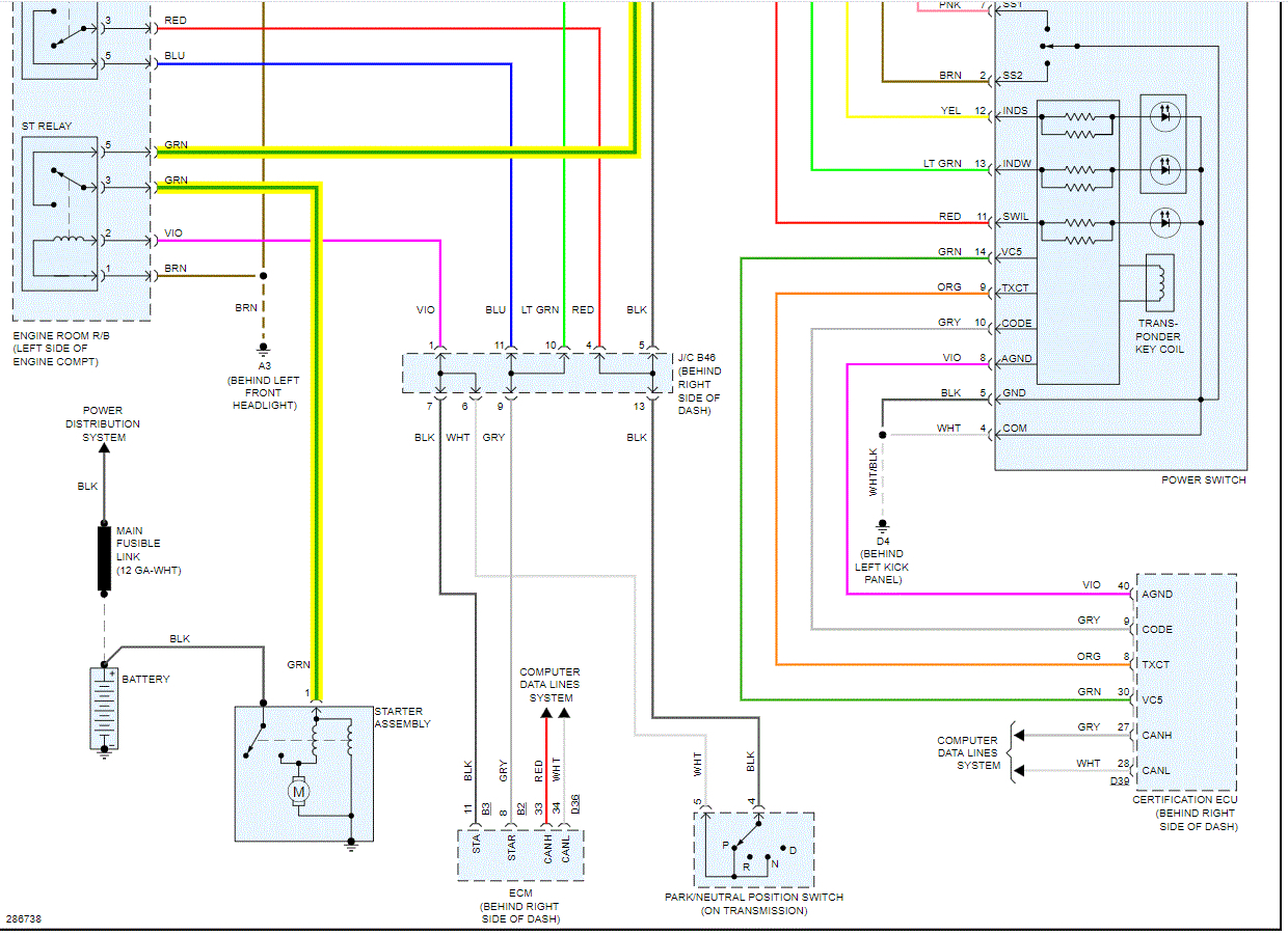

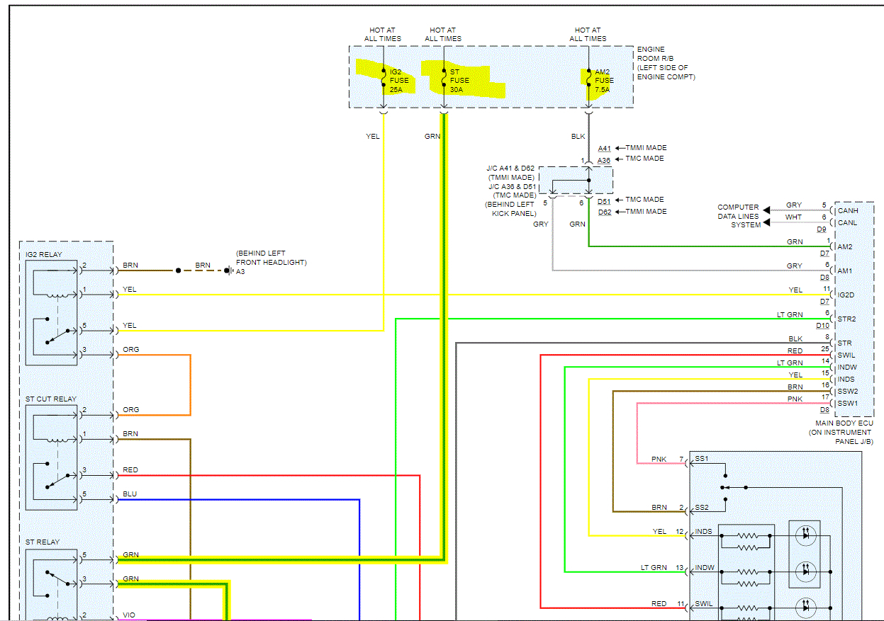

Have you checked the basics such as the fuses and the starter relay? I have attached two pics below. They are the entire wiring schematic for the starting system on this vehicle. I highlighted three fuses I would like you to check.
Note: When checking a fuse, it is important to make sure the fuse is good, but even more important to confirm there is power to it. Here is a link showing how that is done:
In addition to the fuses, I need you to check the related relays. They are located in the engine room junction box.
Pics 3 and 4 show the fuses I need to be checked as well as three relays that may be bad. As far as the fuses, again, confirm there is power to and from. As far as the relays, if there are other relays with the same part number, switch them one at a time to see if any make a difference. If there isn't one to use, here is a link showing how to test a relay.

No electrical work has been done on the vehicle. For the basic: I have check the fuses before replacing main body ECU and engine switch: starter fuse,IG2 fuse and Am1 fuse all okay. I check the Ig2 relay using battery voltage apply on terminal 5 and 2 and it was clicking. I check resistance on terminal 1 and 3, there was resistance. I also used test-lamp to check power on terminal 5 of engine R/B IG2 relay connector, the light illuminate brightly, I remove IG2 fuse and it off. I also check power on the main body ecu socket(A)1 and (B)6 the light illuminate brightly.
Engine Switch: I also check for power between terminal 11 and ground(4,5) the test lamp illustrates. So remaining smart key box and ECM to test ignition signal.

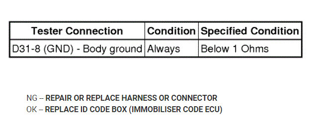

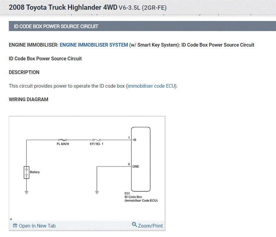

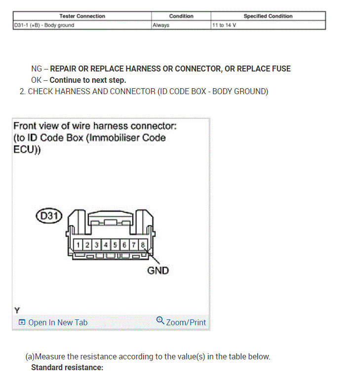

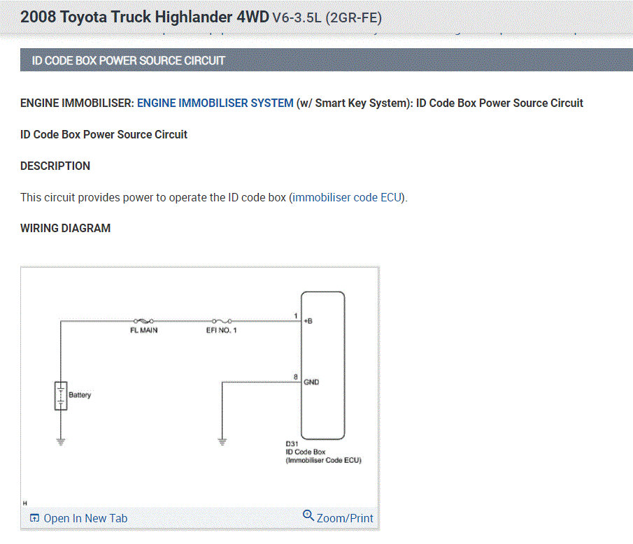

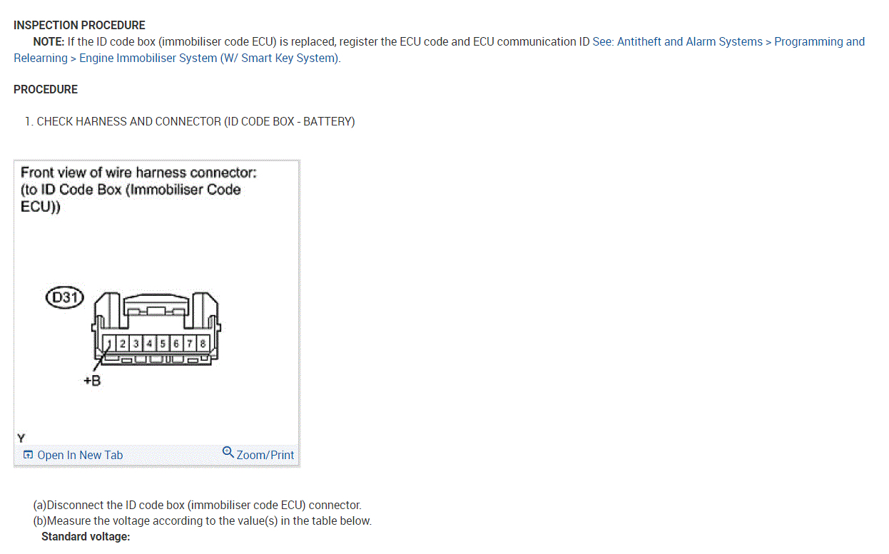

It sounds like you have been busy. I attached some general diagnostics for when you check the immobilizer module.
Let me know what you find.

Yeah, I was busy tracing the wires one after another on the ignition diagram. I have check the smart box and it tested okay. How would I test those 2- ignition wires from ECM for power?

On the ECM: Socket B2(8)(STA) gray and B3(11)(STAR) black. This is what I am referring to.
Jul 29, 2021 at 11:33 AM
  • 110,194 POSTS
The black wire turns to violet at the starter relay. This wire should provide a 5v reference to the relay engaging the relay and then sending power to the starter (s solenoid/green wire) to engage the starter.
Check for a 5v reference from the ECU on the black wire when the start button is pressed.
The gray wire (turns to blue at the cut relay) will only receive power if the transmission is in park or neutral and you pressure the starter button.
Let me know if that makes sense or if you have other questions.
