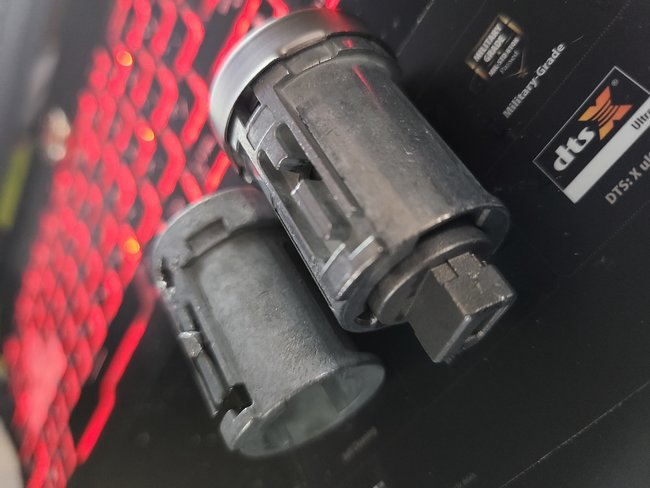

Today I removed the cylinder and noticed that the nub (lock button) that locks the cylinder in place is missing.
Now when I try to reinstall the cylinder, since it will not turn to the off position, it will not lock in place and just slides out.
I have another cylinder housing but since it will not turn to off I cannot remove the cylinder and swap it out.

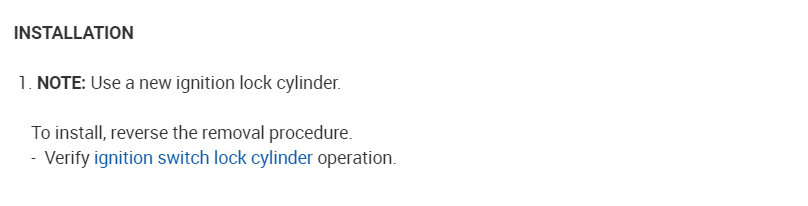

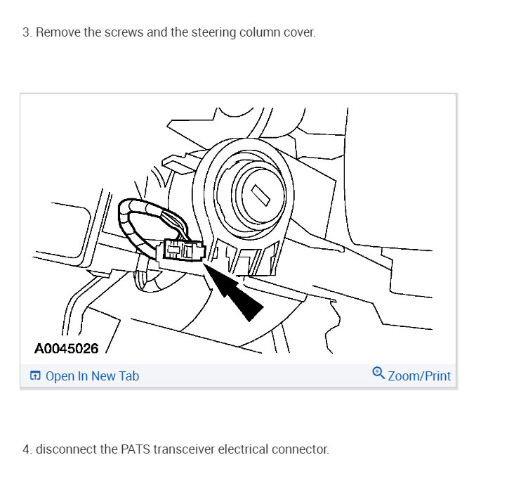

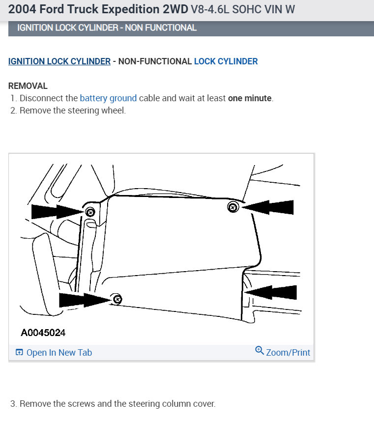

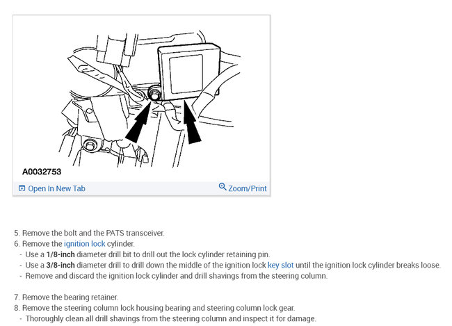

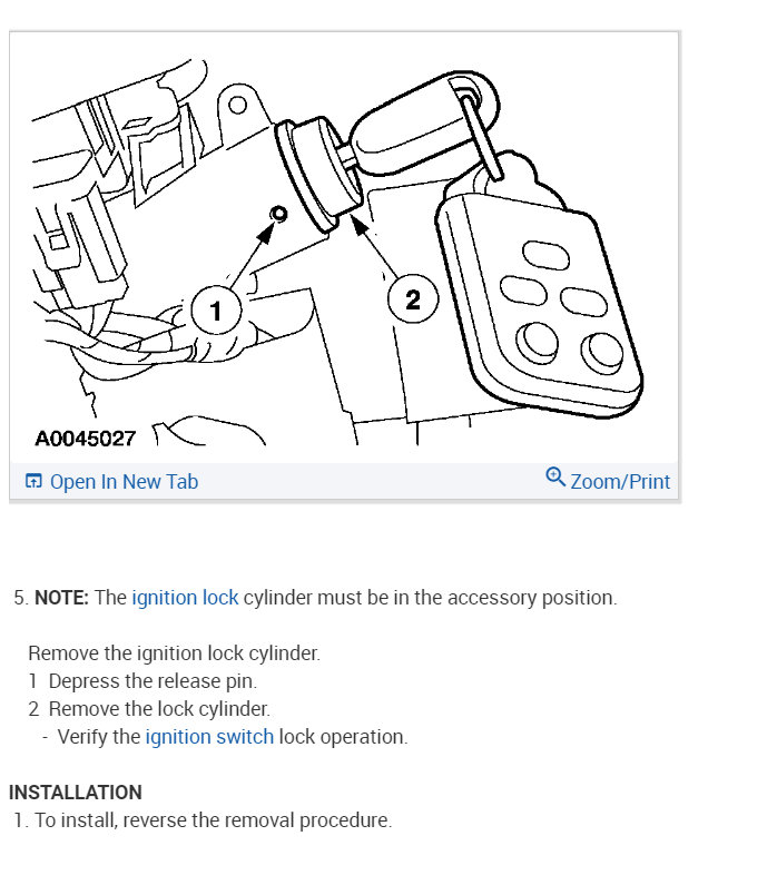

So, what happens is the new lock cylinder has fallen apart internally and it won't allow the lock to be moved completely. here is how you can remove it without the lock being in the park position. Check out the diagrams (below). Let us know what happens and please upload pictures or videos of the problem.
