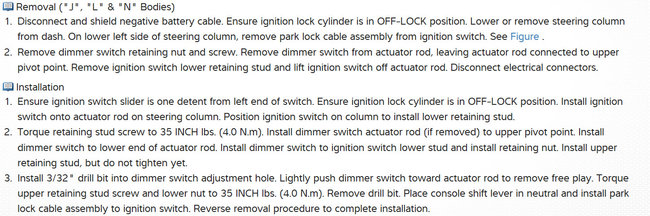

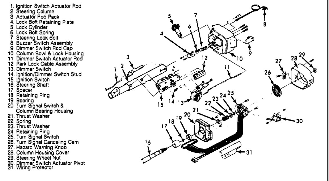

I need to know how to replace my ignition cylinder. I have the part and the tools, just need to know how to actually do it. Thanks!

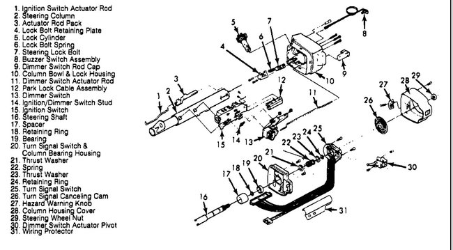

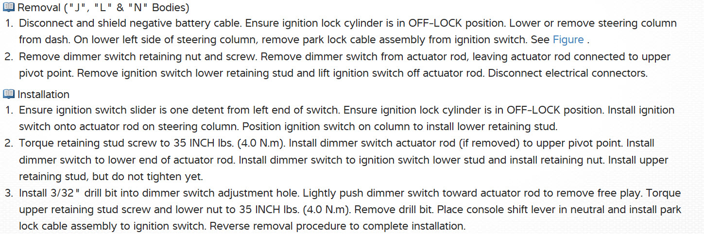

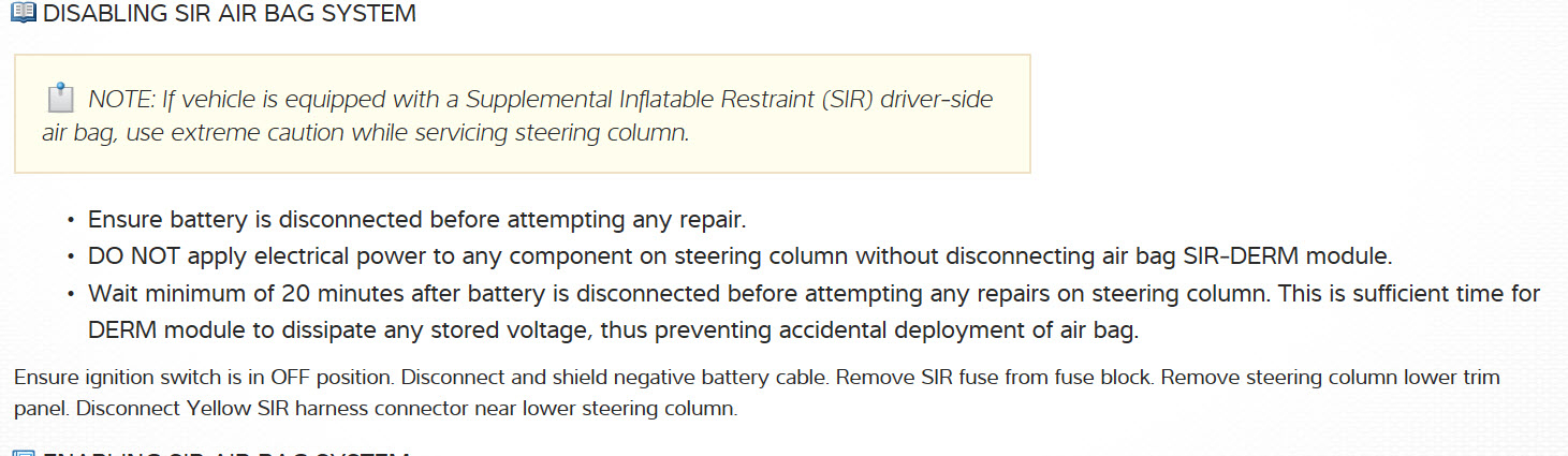

air bag module behind left dash. See pictures for instructions.
