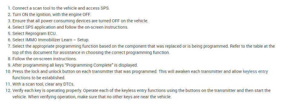

I lost my only key with key fob, so I swapped out cylinder with new one with keys already programmed to it but, it won't allow me to start the car. It came with the 10*10*10 instructions but no luck.

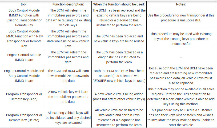

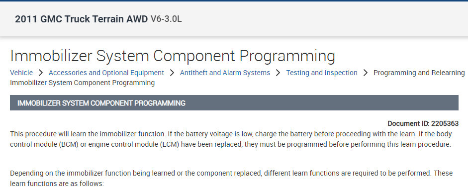

The key and lock cylinder you used may have worked on a different vehicle, but the ECU needs programmed to recognize the new part.

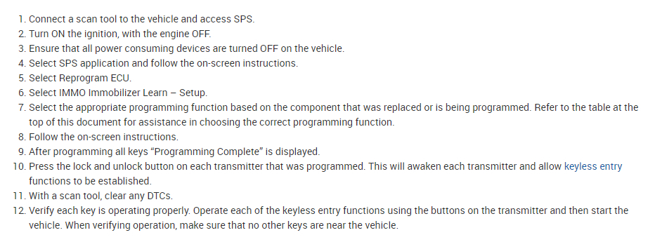

I attached the directions below. Note that you will need a scan tool that can communicate and initiate the relearn.
Let me know if this helps.
