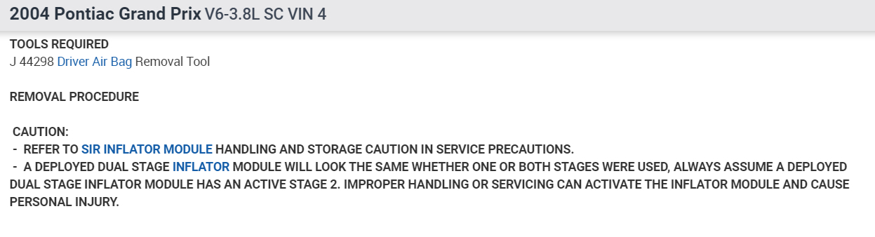

How to replace ignition switch cylinder?

Here is a video on the whole process. This is for a truck but it will basically be the same for your car. You will have to reset the security system which this covers as well.

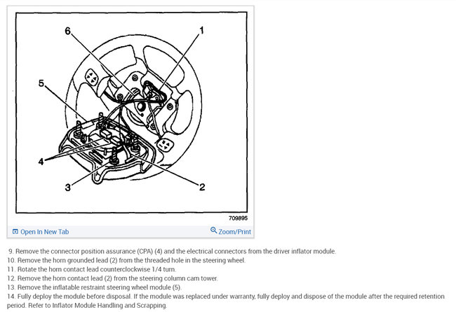

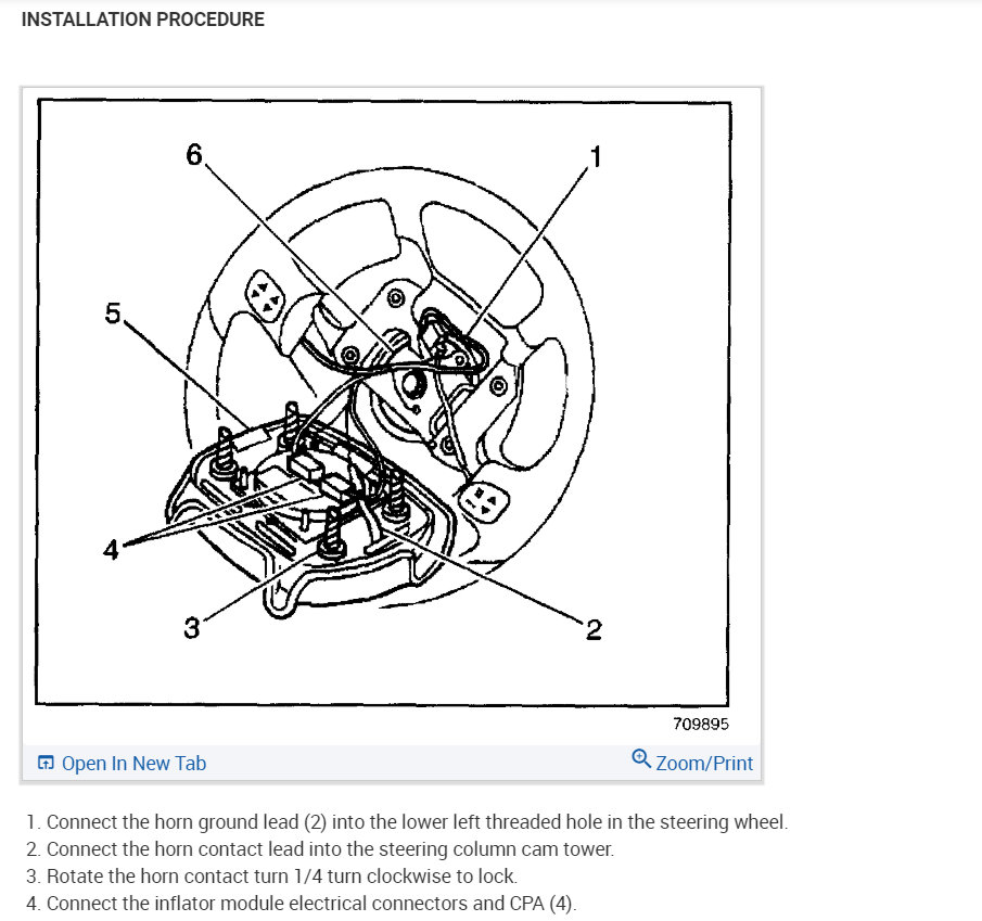

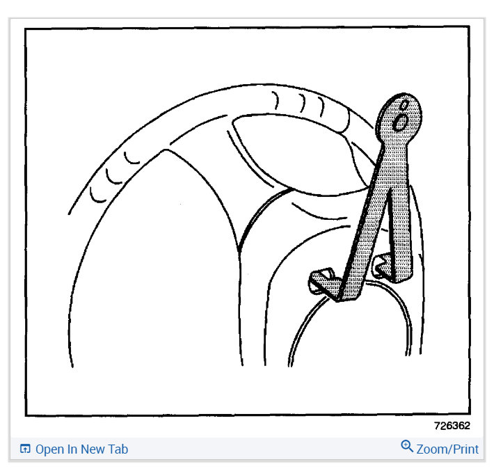

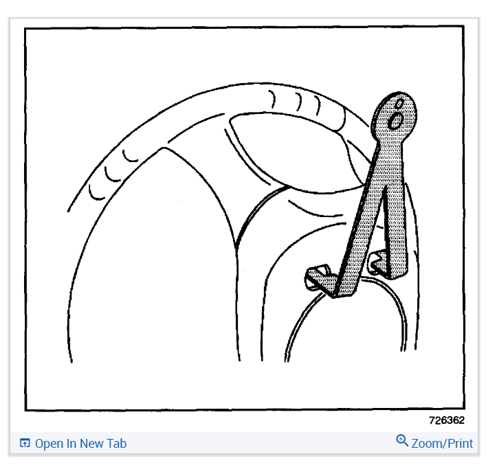

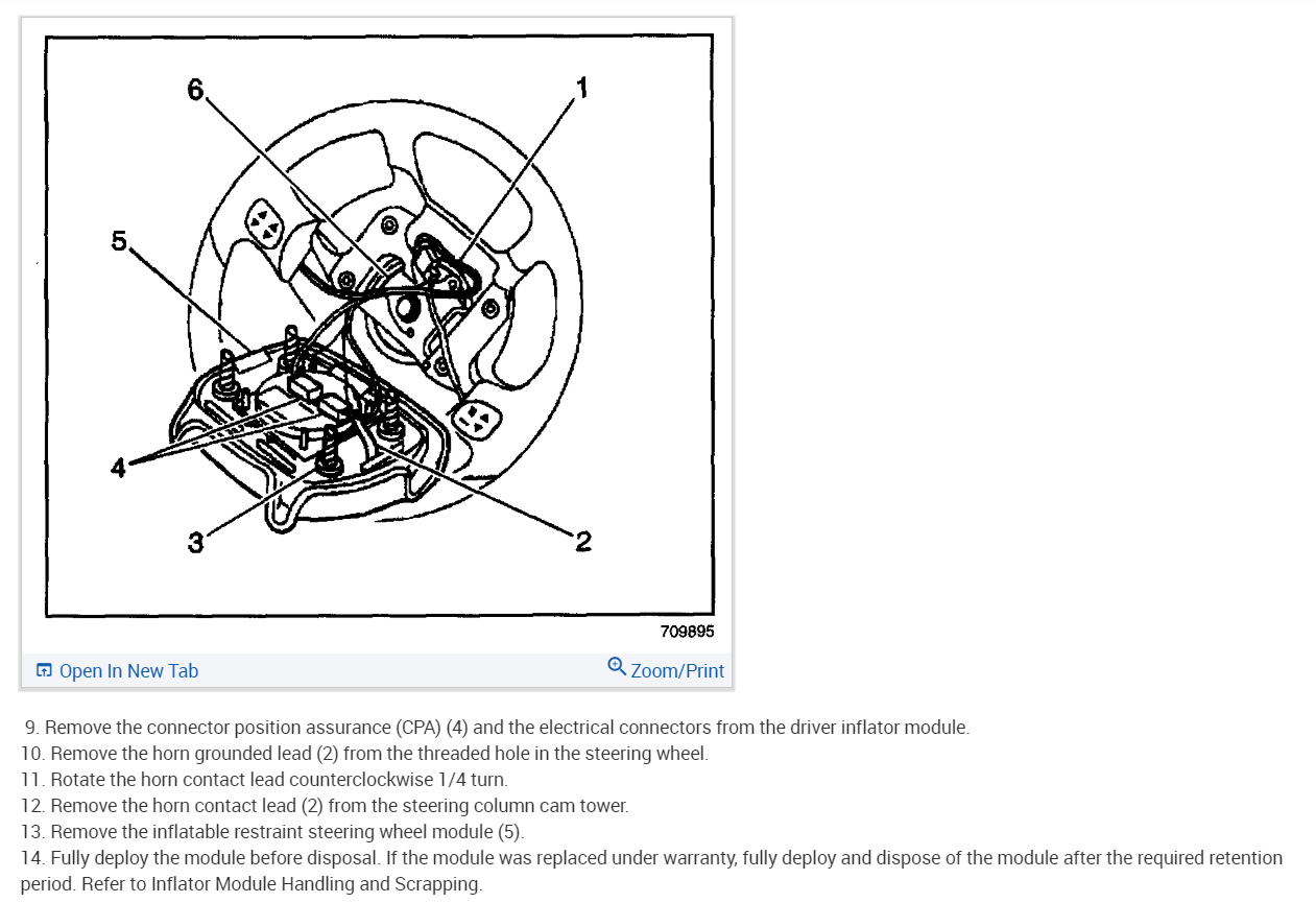

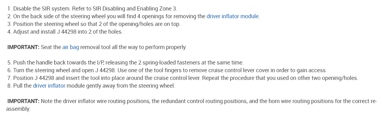

I have to remove the airbags?
Jan 28, 2020 at 1:33 PM
Experienced Mechanic
55,628 POSTS
Here is how you can remove the airbag in the steering wheel. This guide walks you through the steps with instructions below to show you on your car:
https://www.2carpros.com/articles/air-bag-removal-steering-wheel
Images (Click to enlarge)
