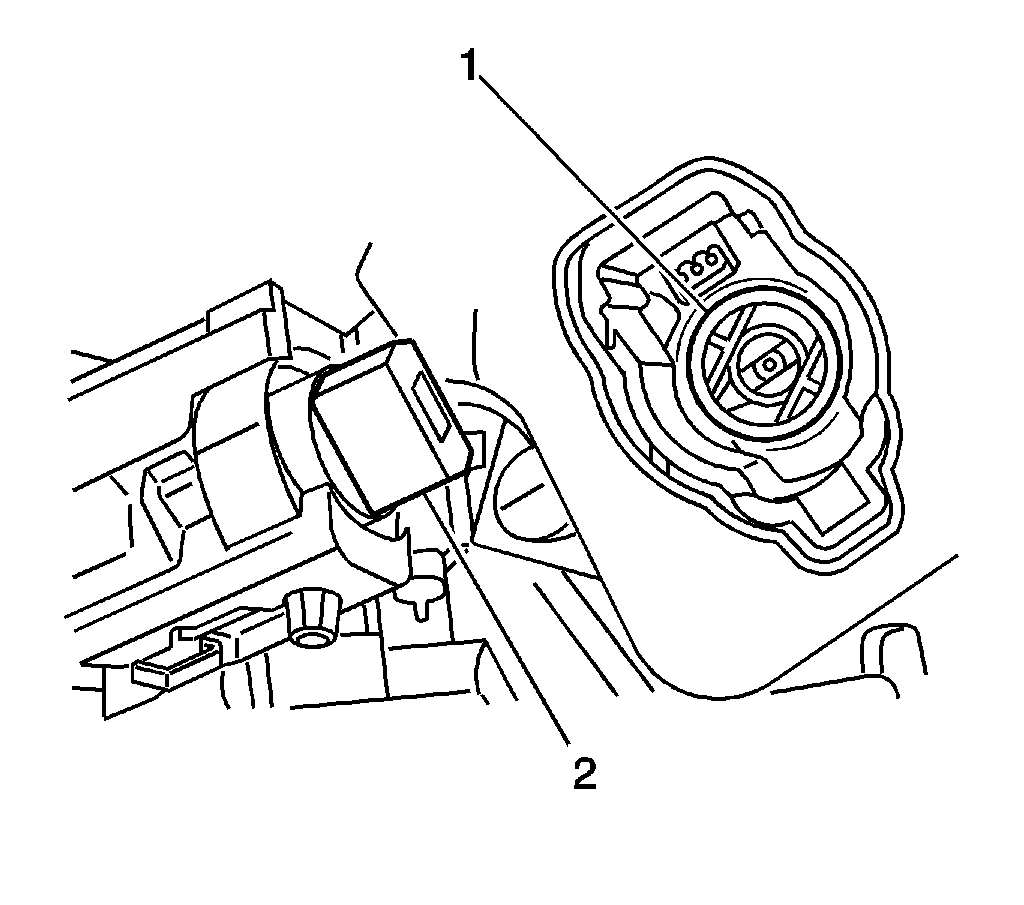

3. Insert the key and turn the ignition lock cylinder to the ON/RUN position.
4. Using a small curved tool or an L-shaped hex wrench, depress and hold the detent on the ignition lock cylinder. Access the detent by placing the tool through the I/P opening to the right of the ignition switch. If you cannot locate the detent with the tool, lower the ignition switch away from the I/P. Refer to Ignition Switch Replacement.
pic 2
5. Using the key as an aid, pull to remove the lock cylinder from the switch.
6. Remove the key from the lock cylinder.
7. If the cylinder does not rotate or is seized, follow the procedure in the ignition switch replacement. Refer to Ignition Switch Replacement.

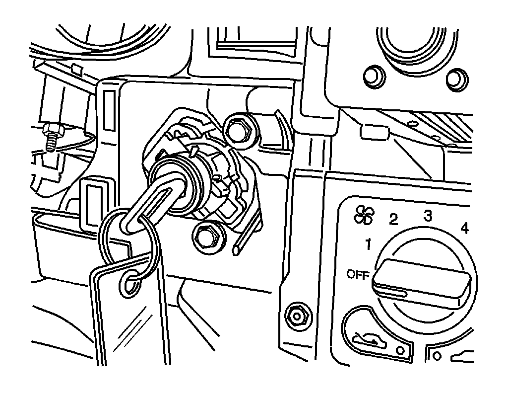

INSTALLATION PROCEDURE
pic 3
1. Code the ignition lock cylinder, if necessary. Refer to Key and Lock Cylinder Coding.
2. Insert the key and turn the lock cylinder to the ON/RUN position.
3. Position the lock cylinder to the ignition switch. Press the cylinder into place. If you turned the key slightly while removing the lock cylinder, you may have to align the white colored ignition switch rotor (1) with the lock cylinder (2). You can rotate the ignition switch rotor (1) with your finger.
4. Turn the key to the OFF position and remove the key.
5. Install the I/P cluster trim plate.
6. Connect the negative battery cable.
7. If you installed a new lock cylinder, perform the BCM theft deterrent relearn procedure.

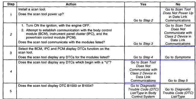

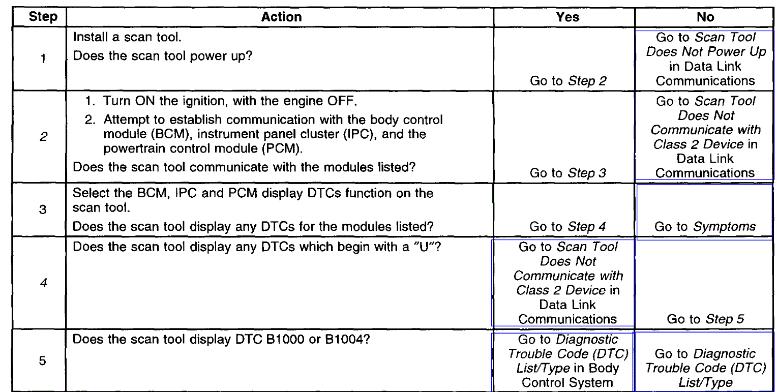

The problem is likely a connection issue. Take a look through the attached diagnostic flow chart and let me if anything helps. Also, if there are any diagnostic trouble codes, let me know what they are.
This information correlates with the attached flow chart.

2000 Chevrolet Impala V6-3.8L VIN K
Diagnostic System Check
Vehicle Accessories and Optional Equipment Antitheft and Alarm Systems Testing and Inspection Initial Inspection and Diagnostic Overview Diagnostic System Check
DIAGNOSTIC SYSTEM CHECK
A Diagnostic System Check - Theft Deterrent
Pic 1
DIAGNOSTIC AIDS
Use J 35616-A when probing or testing electrical connector terminals. Refer to Testing for Intermittent and Poor Connections.
TEST DESCRIPTION
The numbers below refer to the step numbers on the diagnostic table.
2. Lack of communication may be due to a partial malfunction of the class 2 serial data circuit or due to a total malfunction of the class 2 serial data circuit. The specified procedure will determine the particular condition.
4. The presence of DTCs which begin with "U" indicate some other module is not communicating. The specified procedure will compile all the available information before tests are performed.
