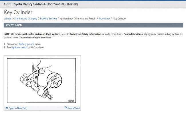

I’ve lost my keys. Will punching the ignition cylinder with a screw driver hinder the removal or installation of the cylinder later when I’m able to get one?
Sep 14, 2021 at 10:06 PM
  • 110,240 POSTS

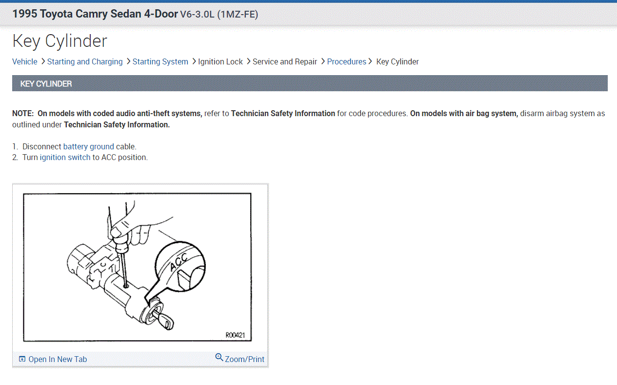

If the key is lost, chances are it won't start even if you do what was suggested. Does the vehicle have an anti-theft system? If it does, there is a receiver in the key lock cylinder. If it doesn't recognize the correct key, it won't allow the engine to start.
If there is no anti-theft, it should work. However, the lock will need to be replaced and it won't be as simple as putting a screw driver into the cylinder and turning. It will be difficult to break it.

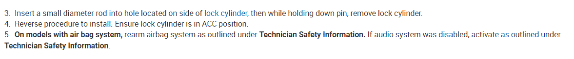

If you do get a new one, I attached the directions for replacement below. To make it a little more difficult, the directions indicate to place the key in the ACC position.
I hope this helps. Please feel free to let me know if you have other questions or if there is something I can do to help.
