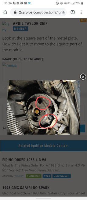

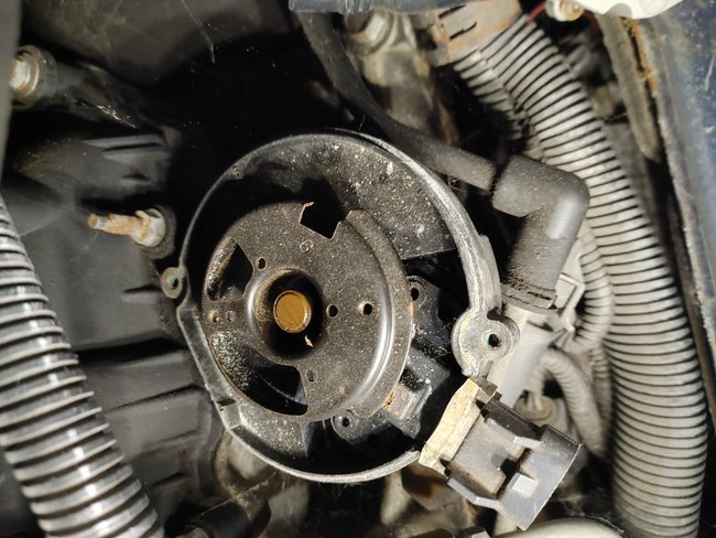

How do I move the metal plate under distributor cap to get control module out? Replaced distributor it started then slowly died out. So now I'm going to replace the ignition control module but the metal plate isn't far enough over for me to get it out.

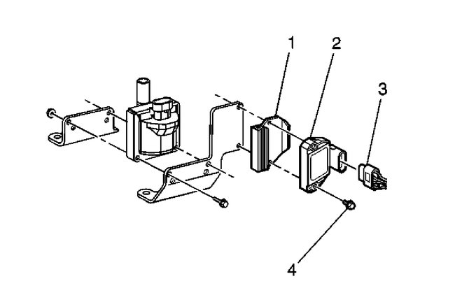

Here are the directions for replacing the ignition control module. Also, please explain what you mean by it isn't over far enough.

IGNITION CONTROL MODULE REPLACEMENT
REMOVAL PROCEDURE
pic 1
1. Remove the engine cover.
2. Disconnect the electrical connector (3).
3. Remove the screws (4) holding the ignition control module (2) and the heat sink (1) to the bracket.
4. Remove the ignition control module and the heat sink.

pic 2
1. Install the ignition control module (2) and the heat sink (1) on the bracket with the screws (4).
Tighten
Tighten the screws to 3.5 Nm (31 lb in.).
2. Reconnect the electrical connectors (3).
3. Install the engine cover.

Look at the square part of the metal plate. How do I get it to move to the square part of the module?

Van listed above has a 4.3 vortec. Distributor is behind the dog house inside the van.
Jun 2, 2020 at 1:42 PM
  • 110,240 POSTS
Okay, that is what the ignition rotor is attached to. For that to turn, the engine has to. Take a breaker bar and socket and place it on the crankshaft center bolt. With the key off, turn the engine a little at a time until they align.

You are very welcome, April. Did you get it out and the new one in?
Jun 4, 2020 at 1:40 PM
APRIL TAYLOR SEIF
  • 23 POSTS
Yes! It finally runs after 2 and a half years.
