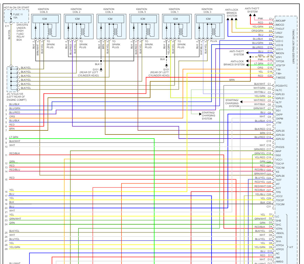

Where is the ignition control module located?
150,050 MILES
KITTYHELLO

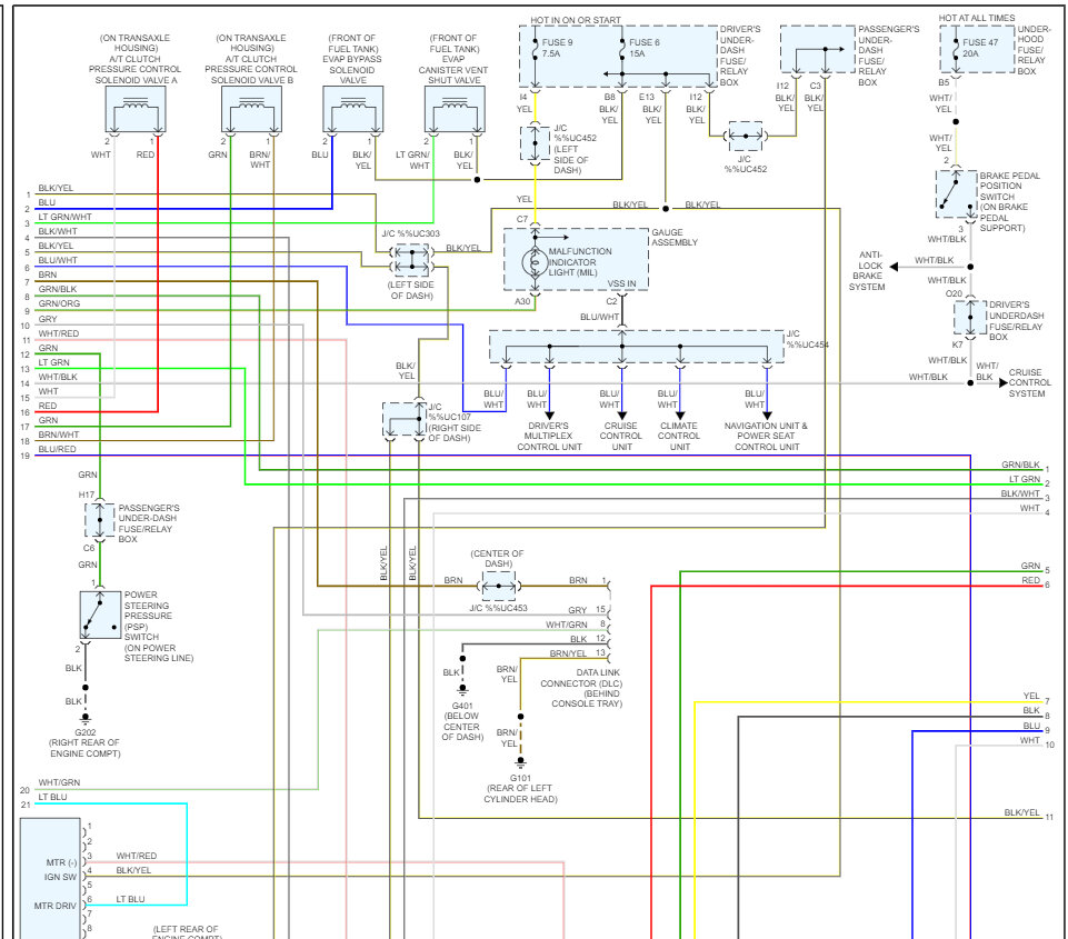

I can't find my ignition control module for my vehicle listed above type s.
Mar 28, 2023 at 6:53 AM
  • 55,691 POSTS

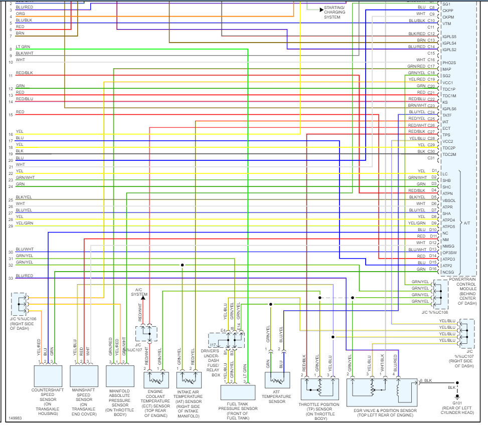

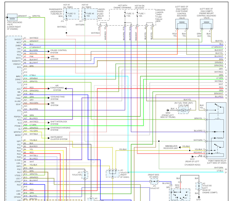

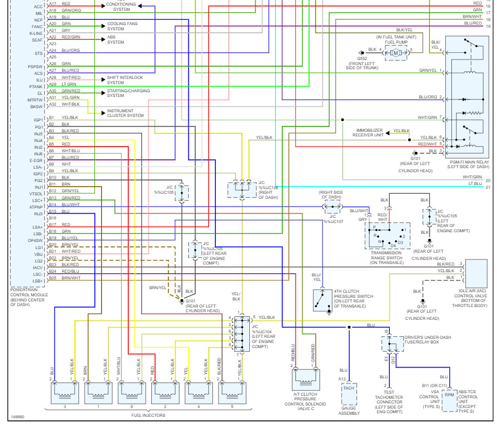

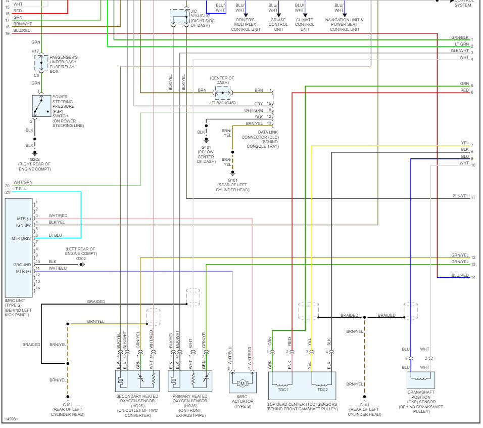

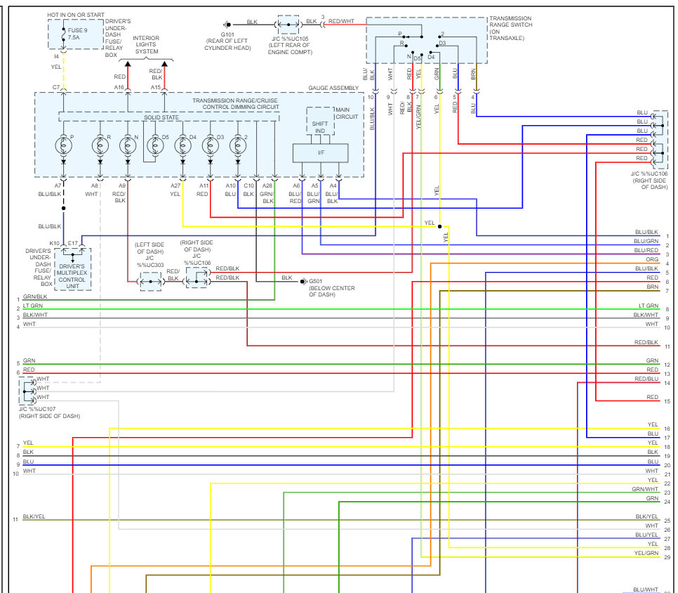

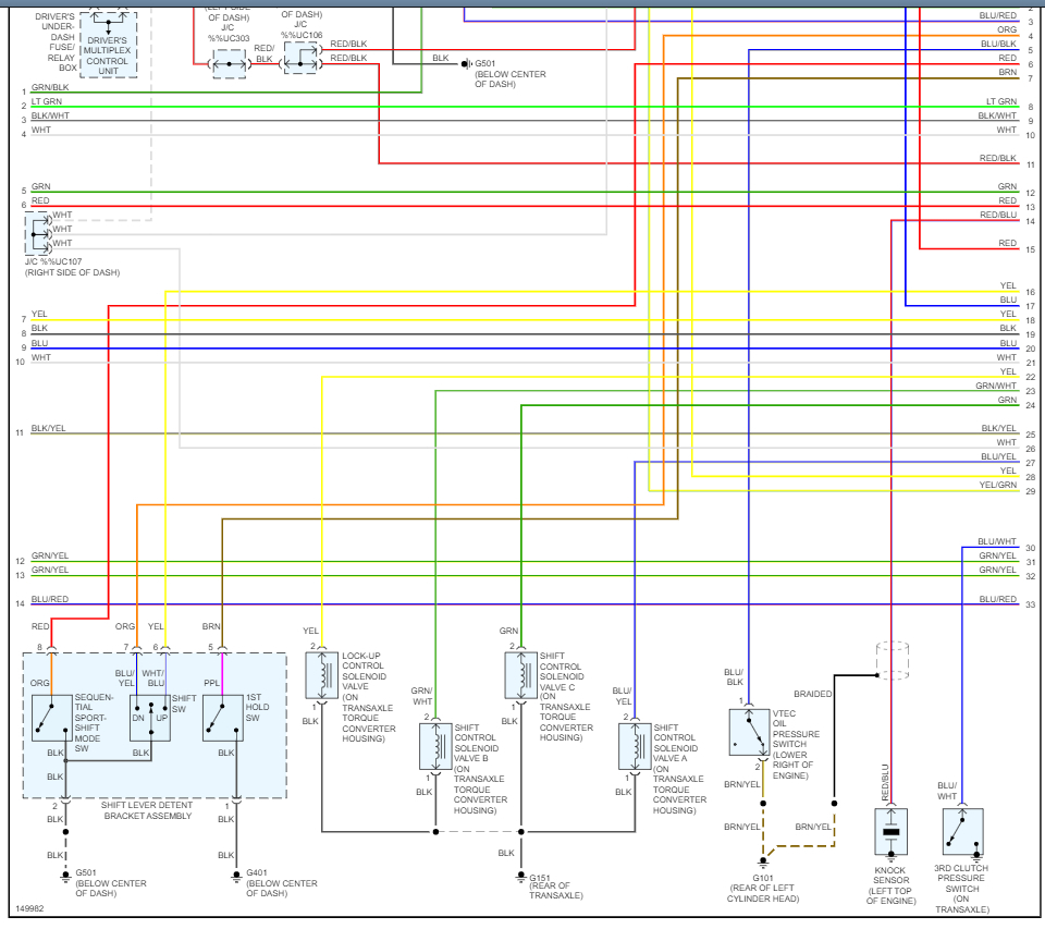

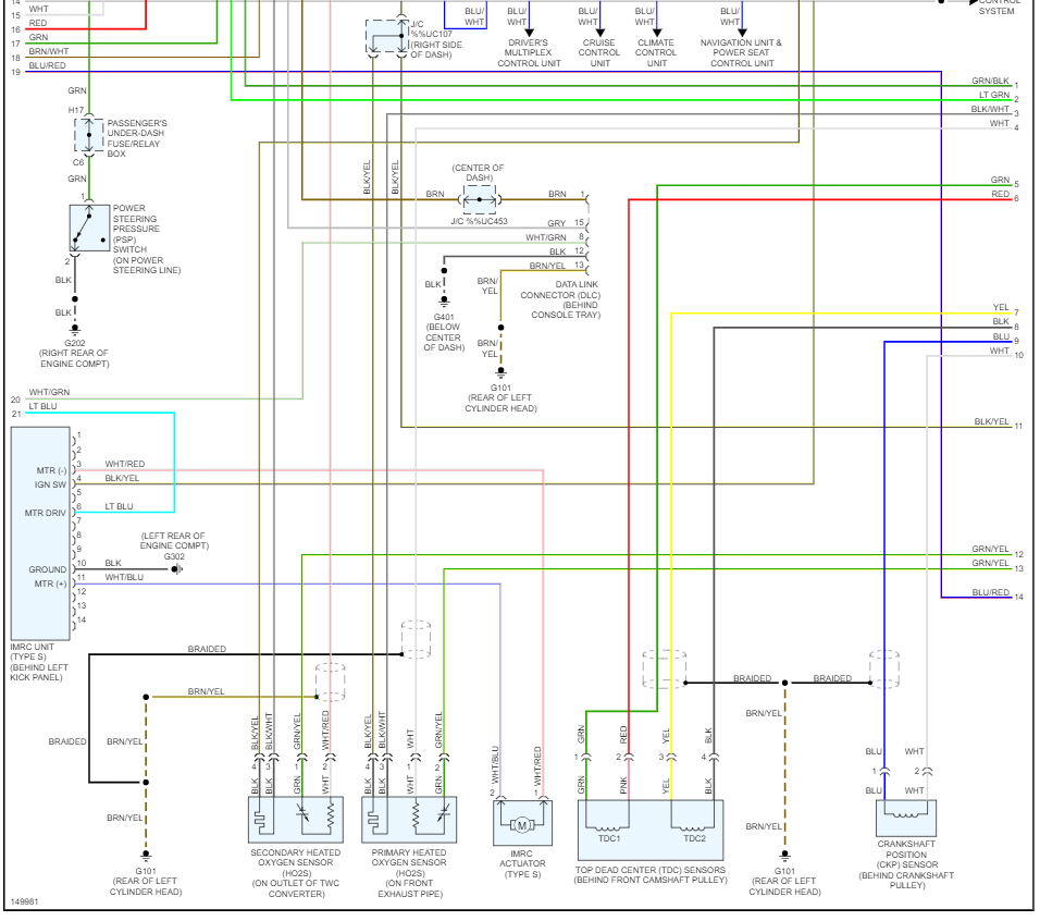

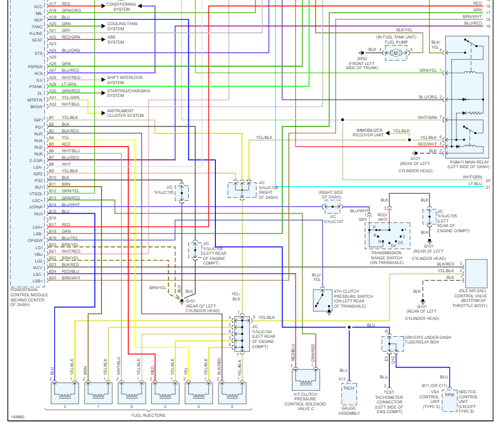

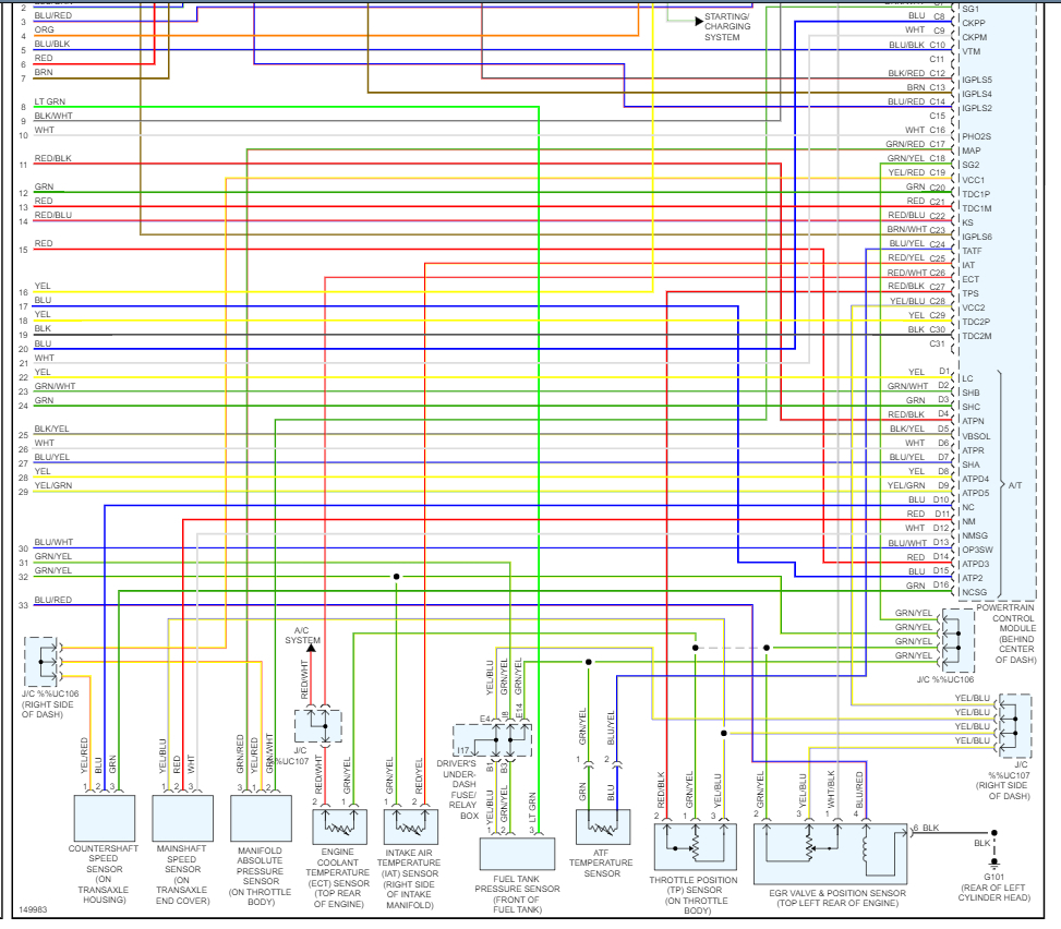

The ignition control module is interrogated into the PCM on this car I have included the engine wiring diagrams so you can see for yourself. Check out the images (below). Please let us know what happens.
