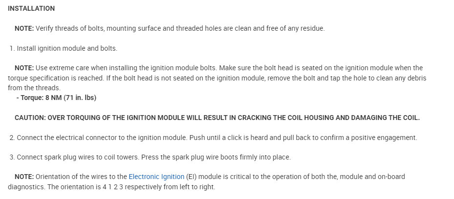

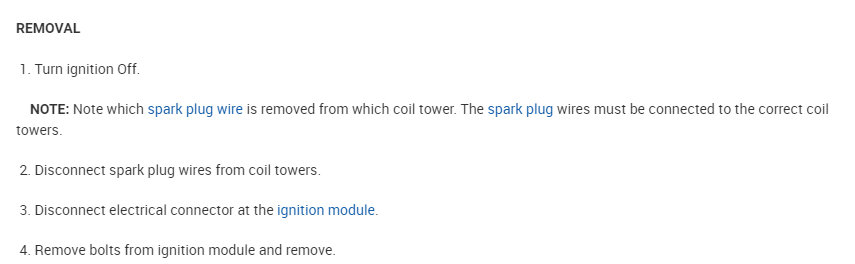

That is a tough question to answer because if it has already been diagnosed as failing, it can fail at any time.

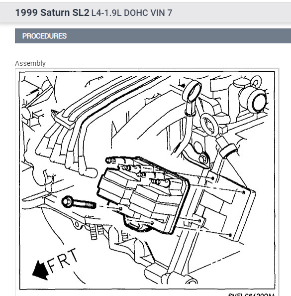

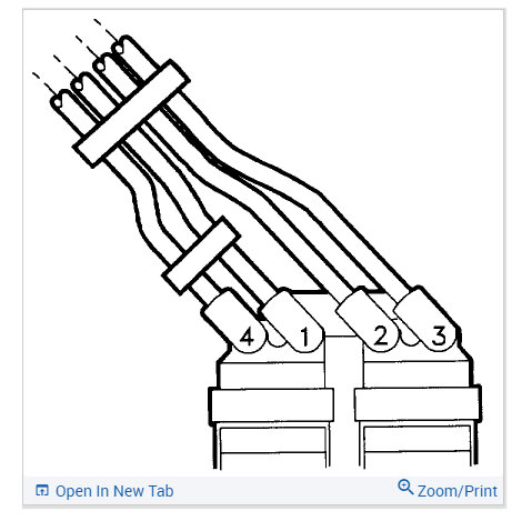

As far as the ICM is concerned, it is easy to replace, and you may want to do it yourself. It is mounted under the ignition coils. I attached directions below for replacing it. Take a look at the directions and let me know if you are comfortable doing it. If you run into trouble, I'll be able to help from here.
You should be able to find an ICM for this vehicle at most parts stores.

No problem whatsoever. If you change your mind, I can walk you through it. It requires removing a few bolts and unplugging an electrical connector.
If you change your mind, I'm here.
