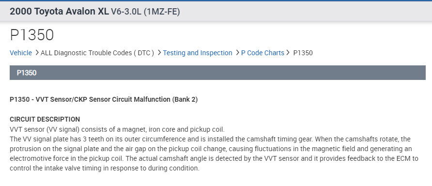

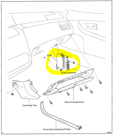

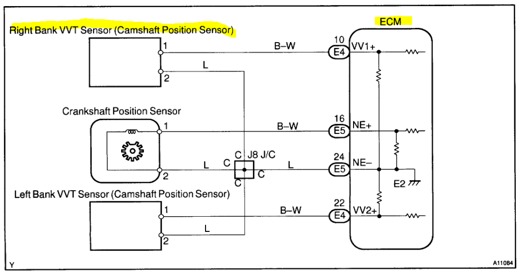

Have a P1350 code and I need the location of the ignition control module.
Oct 27, 2022 at 5:12 AM
  • 110,244 POSTS
This vehicle doesn't have a separate ignition control module. The code is related to the VVT sensor (variable valve timing sensor) DTC P1350 is specific to the right bank VVT sensor.
Do you need info on the engine control module (ECM)? See pic 1 below
Pic 2 defines the code and pic 3 shows the location of the ECM. It is behind the kick panel on the passenger side of the interior.
Let me know if any of this helps or if you have other questions.
