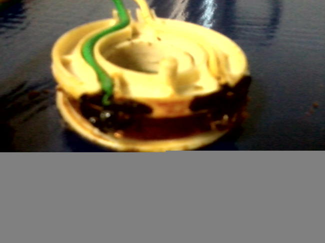

Thanks for your advise last year. Truck ran great for 5 months, no problems what so ever....until now. Would not start one morning, turned over just fine just not starting. Removed air cleaner, sprayer carb cleaner into intake (opened throttle plates) same results no change. Pulled ignition module, had tested at Advance, came back faulty. Replaced with new one one turn of key, same results, removed new module, had tested, faulty. Advance replaced, no charge. Installed replacement, after checking pick-up coil. Pick-up coil was bad also (burned areas). Installed new pick-up with new module, one turn of key.....module gone. I'm assuming there is too much current somewhere. 11.6volts going into external coil

what engine? 11.6 isn't bad voltage should be around there. i f you go on site here and look under tune up it will cover how to diagnose your system. pickup coils should be measured by resistance and make sure to put dielectric grease under module when replacing it.

4.3L, TBI Yes I installed module with the dielectic grease. And I checked the pickup using an ohm meter thats how I Knew it was bad (not just by looking at it) I have the Haynes manual that I was referring to do some testing of pickup & external coil. I added the 11.6volts in my question just to let you know the results of in going voltage to coil thats all.....Also checked the pigtail wiring going into module, found nothing shorted. Not blowing the ignition fuse at all (10amp)
