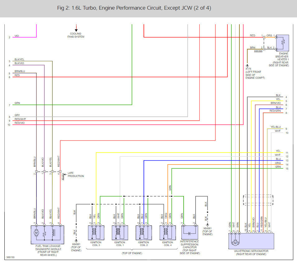

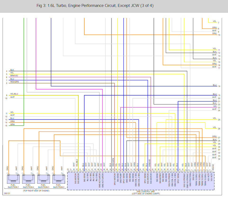

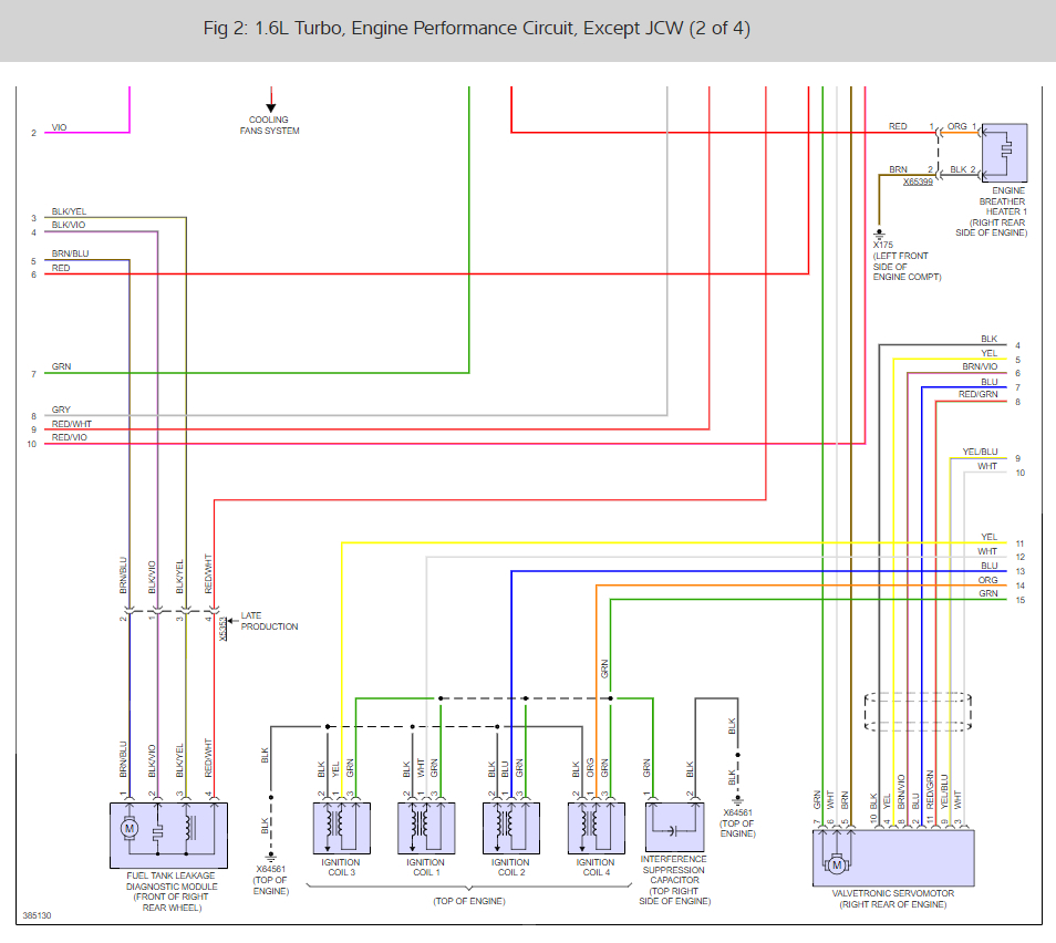

Today I have received the car listed above. I need help to know what is the correct colors of ignition coil connector wires diagram.
current diagram as following:
Cylinder number 1 : (green + white + black).
Cylinder number 2 : (blue + blue + black).
Cylinder number 3 : (green + yellow + black).
Cylinder number 4 : (green + orange + black).
is it correct?
I need to know the correct wires because engine is misfiring with several cylinders and all above wires can replace other : (1 and 2 can replaces the other)
( 3 and 4 also can replaces the other).
Any help please.
Thanks

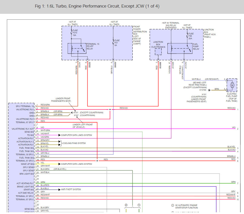

Here are the engine wiring diagrams so you can check them out and get the problem fixed. (below)
Oct 25, 2017 at 11:33 AM

Checked then scanned and found following codes :
2C58 / 2D60 / 2EE1 / 2EE8 / 2EEB / 2EEF / 2EFE / 2F00 / 2F01 / 2F02
assistance please.
thanks
Oct 26, 2017 at 1:14 AM
  • 55,433 POSTS
It sounds like you have a vanos going out not indexing the camshaft correctly. Can you clear the codes and then just turn the key on to see if any hard codes come up?
