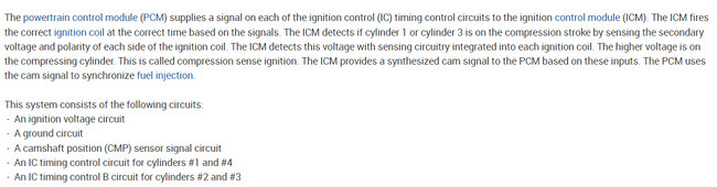

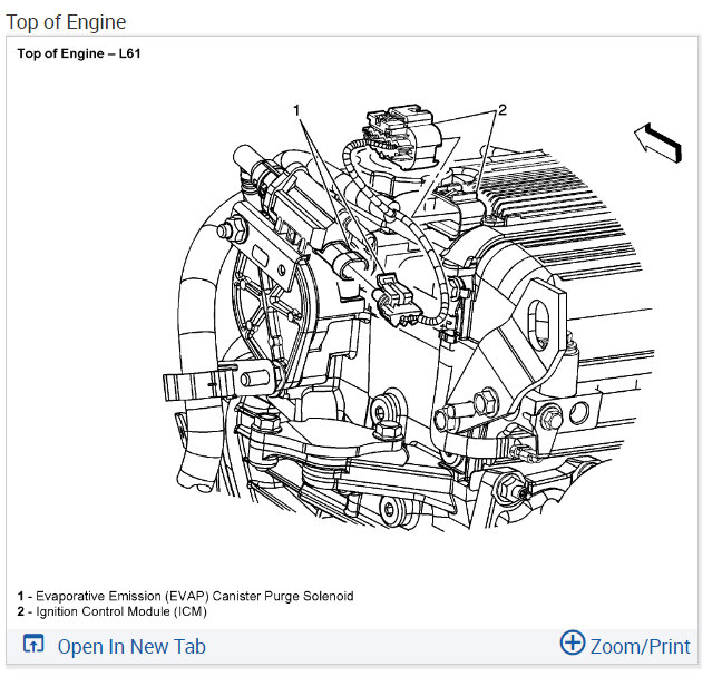

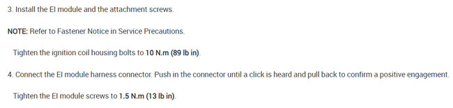

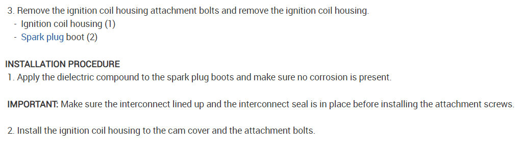

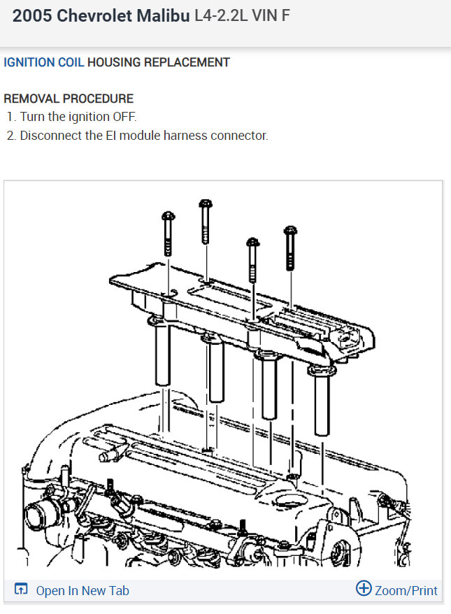

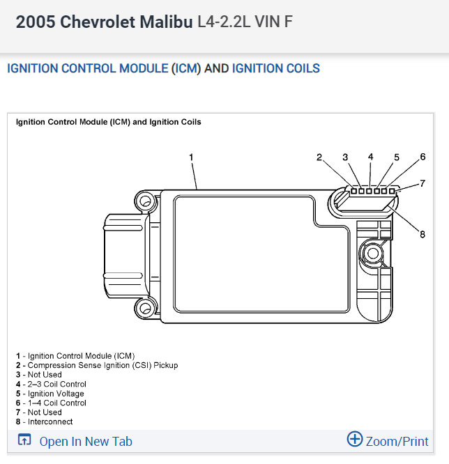

No problem, so the engine never started after the ignition coil replacement, correct? I would say you have a defective part. Can I ask which brand the part is? The ignition control module is integrated into the coil pack. Here is the correct way to replace both, also make sure the electrical connectors are plugged in completely. Check out the images (below). Please upload pictures or videos in your response of any problems so we can see what to help you with.

And the images on control module doesn't look like my 2.2l motor.
Jul 9, 2024 at 5:52 AM
  • 55,721 POSTS
The coil pack has the module bolted to it, you can use a voltmeter and test the OHMS of each of the coil terminals but that is not an actual "in use" test which is difficult to do. The images are correct for this car I have double checked, you can upload an image so I can see so we are on the same page. The fact that it doesn't run means the installation is not correct or the new coil pack is bad. Check out the images (below). Please let us know what happens.

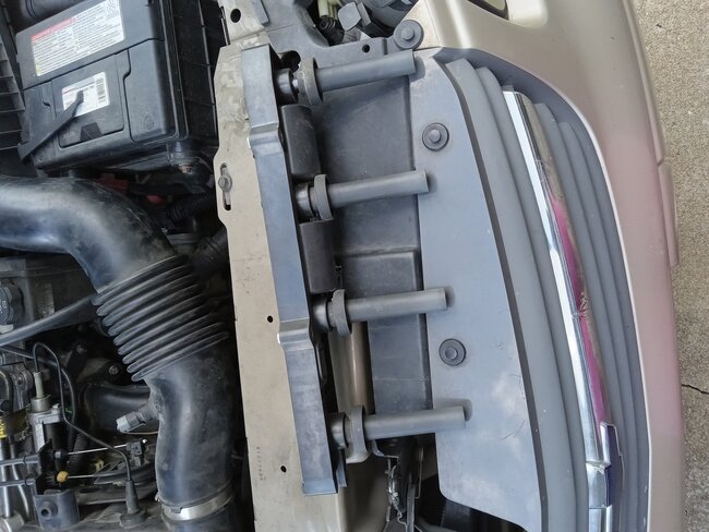

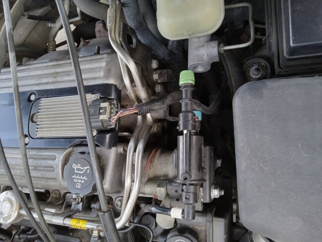

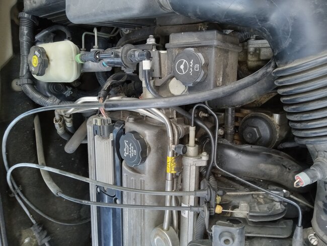

Here is my car photos the 1st is a picture of old coil pack and boots and the next 2 show the module and some connected sensors maybe.
Jul 9, 2024 at 10:14 AM
  • 55,721 POSTS
Yep, we are on the same page, this is the coil pack and ignition module. I would disassemble them to see if the electrical connectors are okay, ands if so I would get another coil pack because the one you have sounds defective.

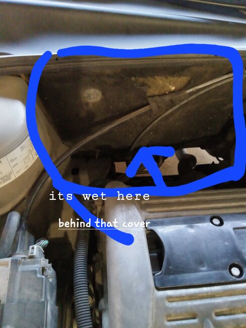

Also, here is an image of where water is leaking too.
