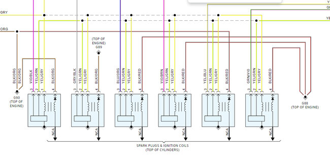

I bought new connectors online that they said were color coded, but they don't match. Do you have a color coded wiring diagram for the coils on the vehicle listed above t6 3.0?

I attached the schematic below from my manual. I noticed the cylinder number isn't indicated, but you should be able to identify each by the wire to the PCM which is different for each.
I traced the wiring to the PCM, and it doesn't identify a cylinder number either.
Let me know if this helps.
See pic below.
