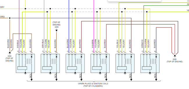

Ignition coil connector wiring diagram needed?
2010 VOLVO XC60
205,000 MILES • 3.0L • V6 • 4WD • AUTOMATIC
LARDOG58
I bought new connectors online that they said were color coded, but they don't match. Do you have a color coded wiring diagram for the coils on the vehicle listed above t6 3.0?
Aug 6, 2024 at 3:17 PM
  • 110,194 POSTS

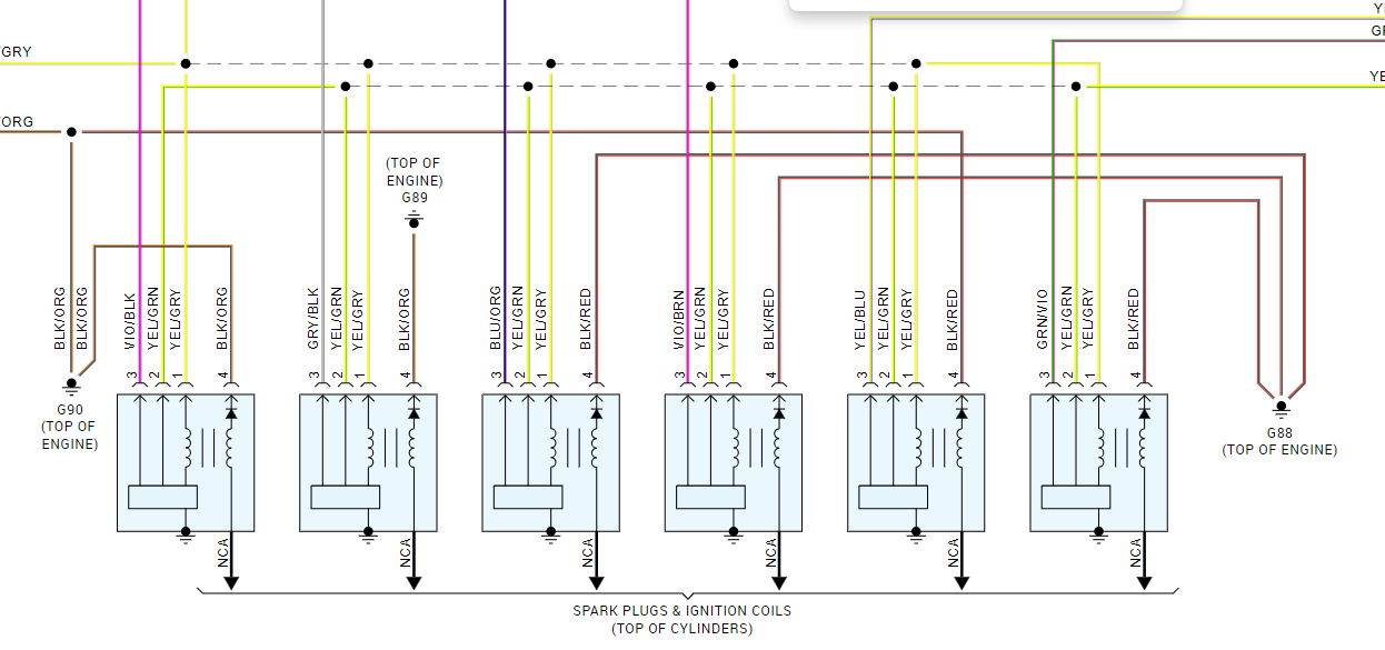

I attached the schematic below from my manual. I noticed the cylinder number isn't indicated, but you should be able to identify each by the wire to the PCM which is different for each.
I traced the wiring to the PCM, and it doesn't identify a cylinder number either.
Let me know if this helps.
See pic below.
