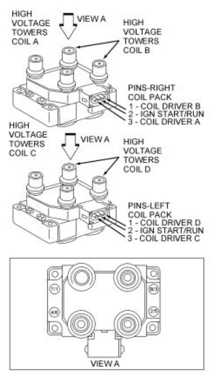

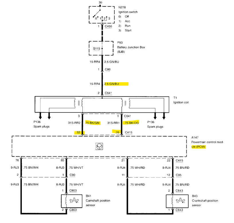

Hello, what was the reason for replacing the harness for the coil pack? There is a green wire with a blue stripe which is the power feed to the coil pack, the Black/Orange wire is the control wire for one of the coils and the other control wire is Black/Green. If you hooked power directly to the PCM control wire, then it most likely burned out the PCM coil driver transistor. This is a waste spark system, where one coil fires for 2 cylinders. Where did you get the harness, and did you replace the coil pack as well?
This is the Ford OEM wiring diagram.

When I got the car, it had a bad harness that is the reason I replaced it, and yes, the black and orange and black and green are the grounds. the car wouldn't start the only way to get it to start was just switching the black and green and black and orange wire around but only cylinder 2 an 3 are firing and 1 and 4 do not have no spark, but if I put the wires back the correct way it will crank but no start just trying to figure out why it start one way but not the correct way would my ignition coil do that if it's bad.

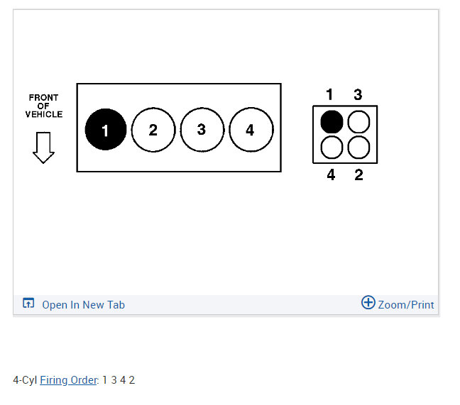

When you got the vehicle was that section of harness shorted out, missing insulation, or possibly where the wires had touched? It looks like there are 2 types of coils but that shouldnt change the way the coils fire. Here is the firing order, 1 and 4 should fire together and 2 and 3 should. the different coil packs are the Four Tower and the Series 5 Four Tower. But both have the middle pin on the coil pack is power and each side pin is a PCM driver for the 2 coils. It might be that the PCM driver for cylinders 1 and 4 were already burned out when you got the vehicle. And thats why it blew the 30amp fuse.

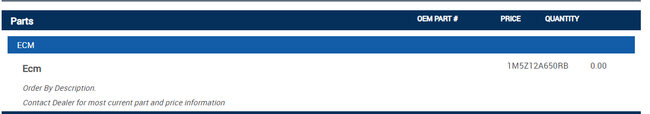

I would verify that the wire in question is not shorted to ground somewhere else by unplugging the PCM and checking the wire for continuity to ground first since it sounds like this vehicle has some wiring issues. If you find that there is a short to ground throw the PCM on either of the 2 control wires, below is the part number, and a link to flagship one. They have an updated PCM in stock for a low price,
