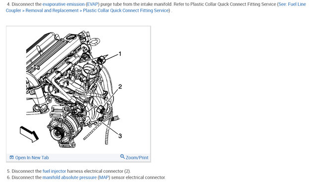

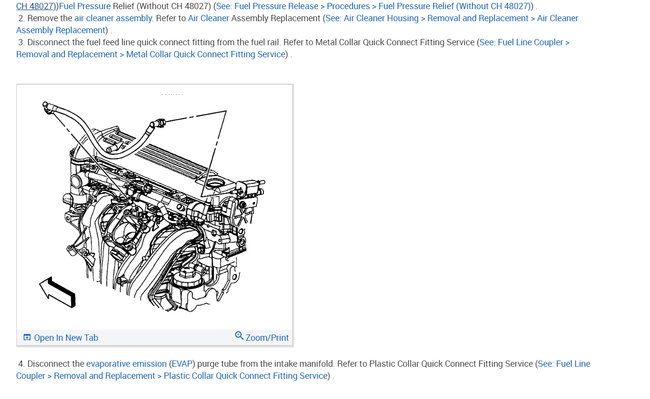

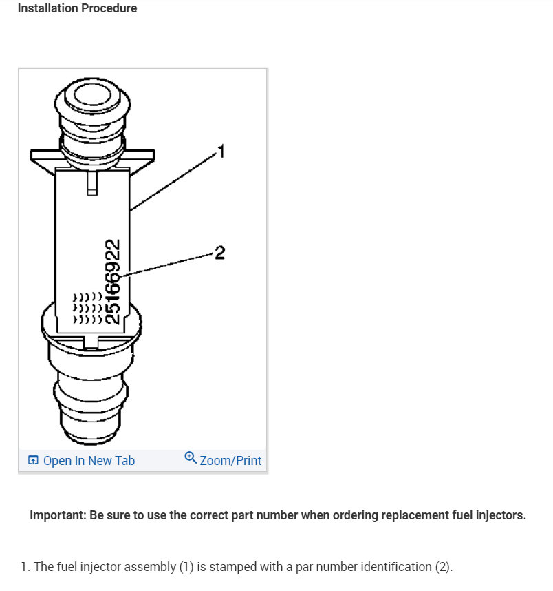

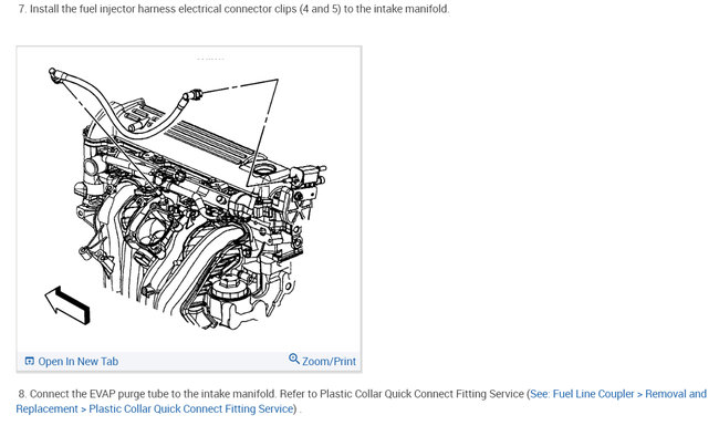

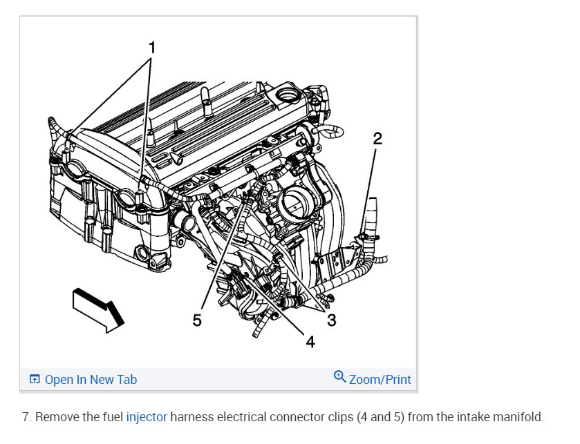

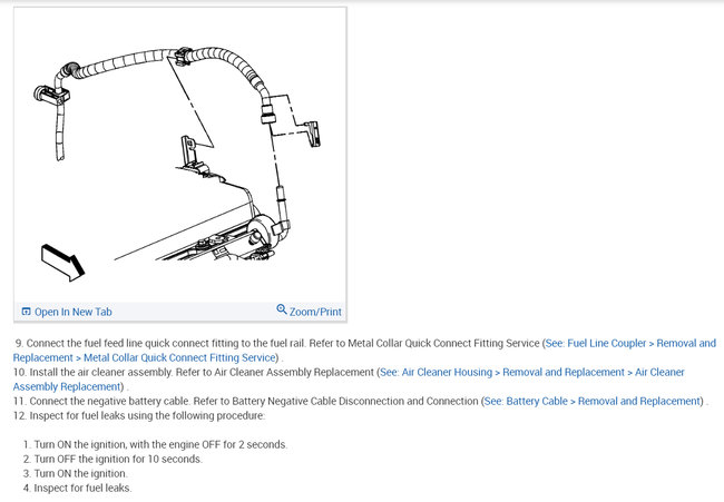

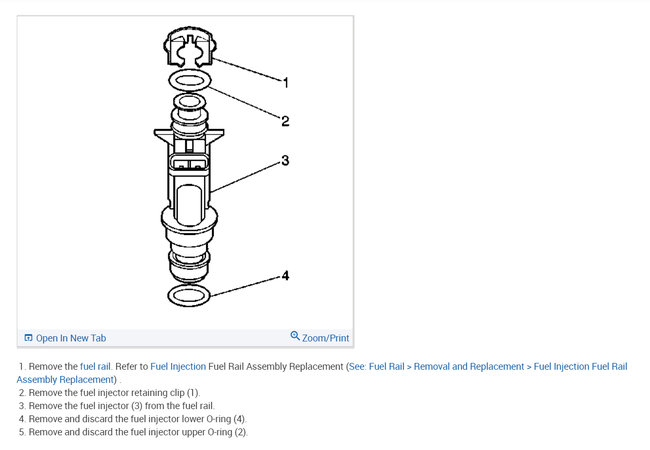

My car was throwing code for the 4th ignition coil was misfiring, and i changed the ignition coil and spark plug for #4 and it kept throwing the code so i replaced it thinking it was just a faulty one, but it is still throwing the code.
Jun 27, 2022 at 12:55 AM
  • 55,694 POSTS

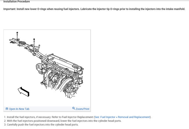

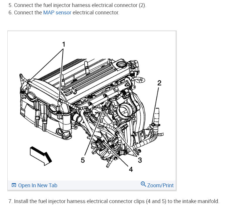

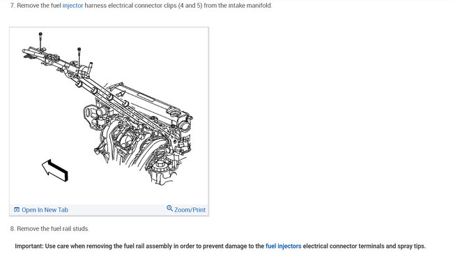

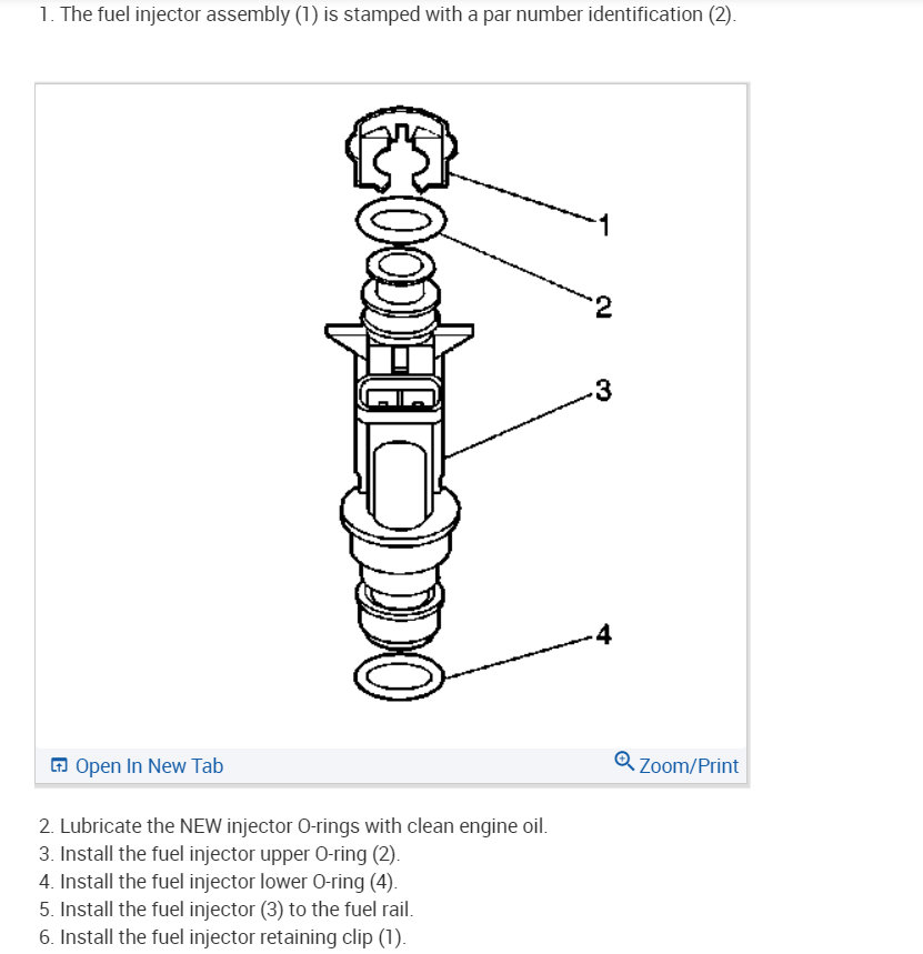

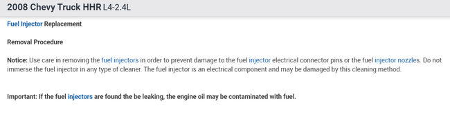

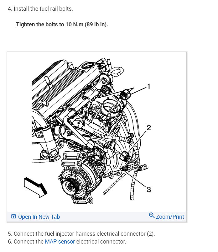

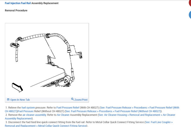

When you replaced the spark plug did it look okay? Also, how does the engine run? If the cylinder has good compression, you probably have a bad fuel injector. These guides can help, and I have included directions in the diagram below to help you change the injector out.
and
https://www.2carpros.com/articles/how-to-test-a-fuel-injector
