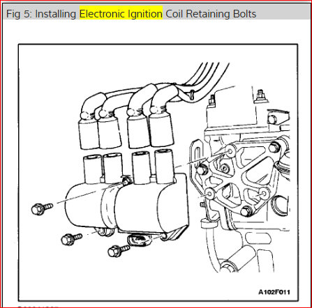

My car was running pretty bad. I have since replaced spark plugs the leads and now the ignition coil. I am thinking that the leads may be on the wrong way. Does anyone have a clue on which one goes from spark plugs to the ignition coil? Thanks. Want to double check, it is hesitating bad and just sounds like it is running two or three cylinders.
Aug 5, 2018 at 11:25 AM
DANNY L
  • 5,648 POSTS
Hello, I am Danny.
This is the only picture I found. Hopefully you pressed hard enough down to have them fully seat into the receptacles. If it runs bad enough it should trip the check engine light quickly. If it does that you can put a scanner/code reader on and it will show you if/what cylinders are misfiring. I have attached a link about misfires. Hope this helps and feel free to ask any questions if needed.Thanks for using 2CarPros.

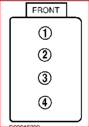

Hi, is the firing pattern 1432? Is the coil holes downwards 1432 or 1234?
Aug 5, 2018 at 11:44 AM
DANNY L
  • 5,648 POSTS
Hello again.
The firing order is 1-3-4-2 I have attached a picture. Hope this helps.
Danny-
Aug 5, 2018 at 11:57 AM
KAYLA BRITTNEY WALLIS
Hi, all seems to be in order. I pulled injector plug out one at a time and three times the idle went down on the far right cylinder. It did not change anything where to from there.
