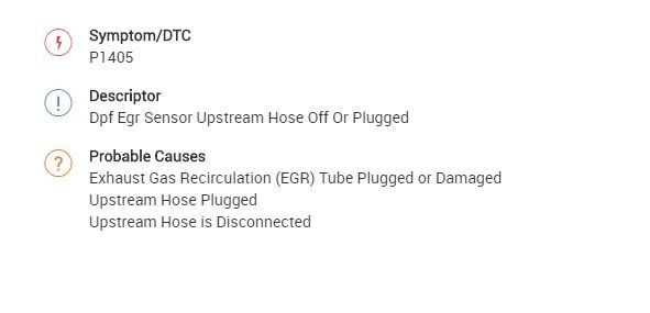

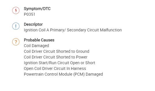

It was a P0351 and P1405.
Dec 12, 2019 at 7:17 AM

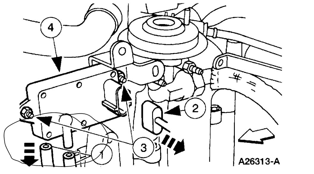

Okay, 1405 is for the DPFE sensor. It could be the hose is off or broken. I attached a picture for you.

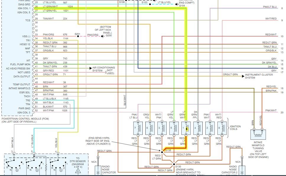

The 351 is a wiring issue for the coil. I attached a wiring diagram and highlighted the wires. One wire should have 12 volts with the key on. The other wire is pulsed to ground from a signal from the crank sensor.

There is no module. the control is the PCM. Check the voltage to the coil first.

Yes, check the voltage at the coil on number 1.
Dec 12, 2019 at 7:59 AM
BUDDYVEGA
  • 7 POSTS
With a multimeter, correct?
Dec 12, 2019 at 9:11 AM
Correct. Check for DC voltage.
