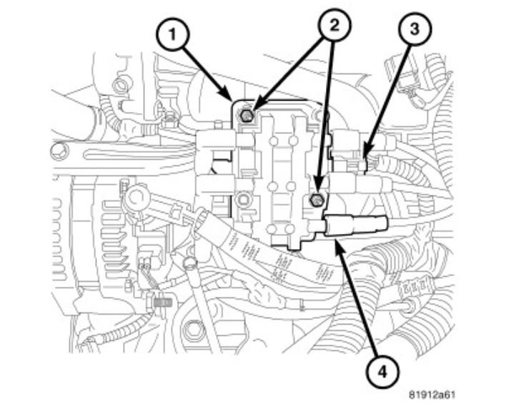

Just got this vehicle. Was going to do a tune up and wanted to know if I should replace the ignition coil at the same time. Some of the tune up kits have them others don't.

If you are doing a maintenance tune-up, no need for the coil to be replaced.
https://www.2carpros.com/articles/how-to-tune-up-a-car-engine
Only if you have a code for a coil failure would require replacement.
Replace the plugs. I would also replace the air filter as well.

No, there is no need for you to replace the ignition coil.Only reason to do that is if vehicle wont start.For a basic tune-up just replace the spark plugs and possibly change the fluids if needed. I can attach a service schedule if needed if you don't have the factory Jeep owners manual.Hope this helps and thanks for using 2CarPros.
