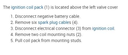

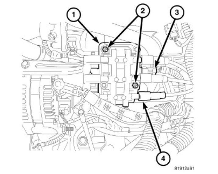

Good morning,
If you are doing a maintenance tune-up, no need for the coil to be replaced.
https://www.2carpros.com/articles/how-to-tune-up-a-car-engine
Only if you have a code for a coil failure would require replacement.
Replace the plugs. I would also replace the air filter as well.
