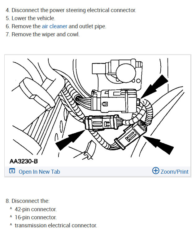

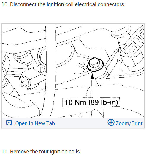

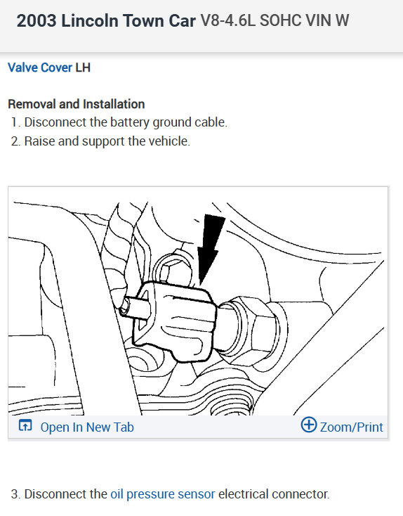

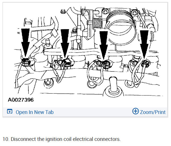

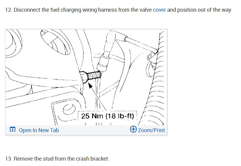

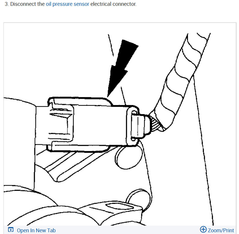

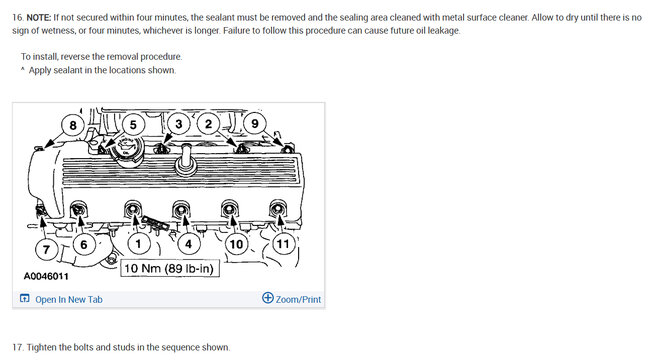

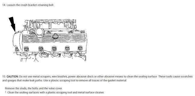

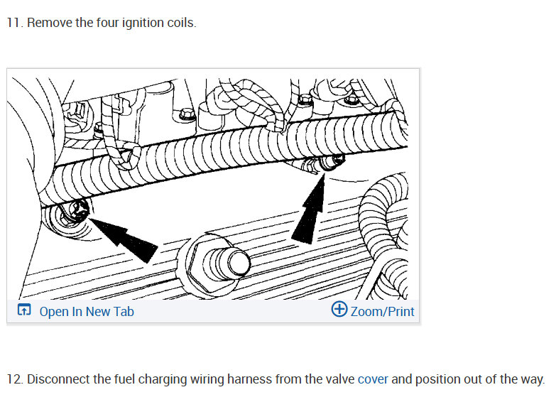

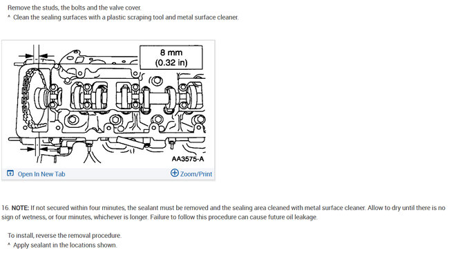

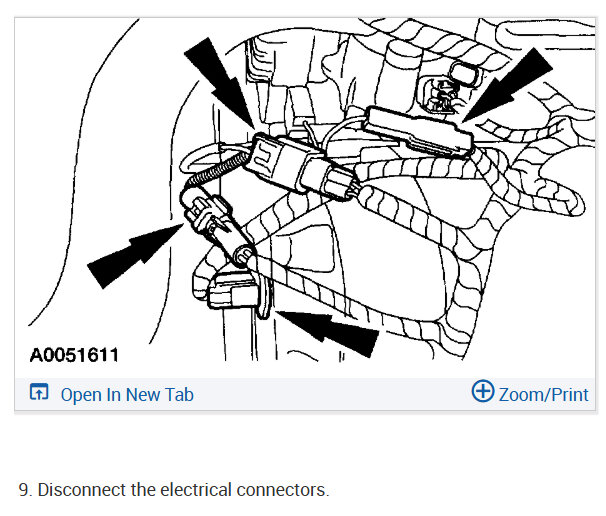

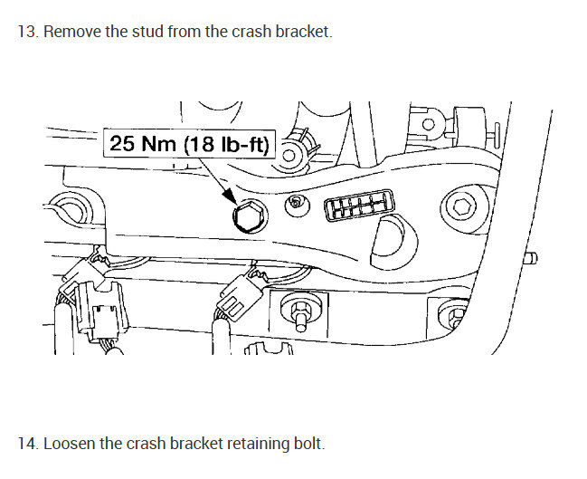

Chances are if you use a paper towel and a long screwdriver you can clean the oil out, install a new spark plug and coil and the problem will be fixed, here is how to change the valve cover gasket out.
