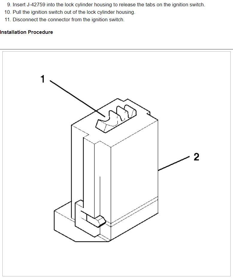

When I put my key inside the ignition the chime doesn't sound off. How can I fix this issue? do i need to replace the ignition cylinder lock or a fuse in the fuse box?
Jan 12, 2019 at 1:44 AM
  • 55,743 POSTS

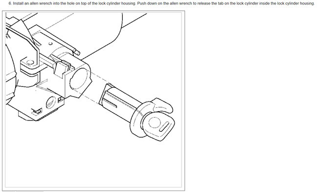

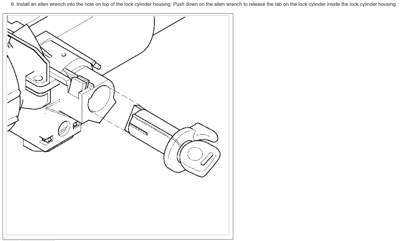

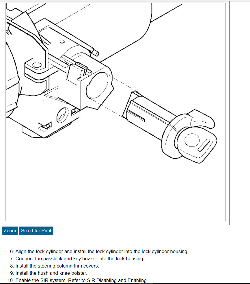

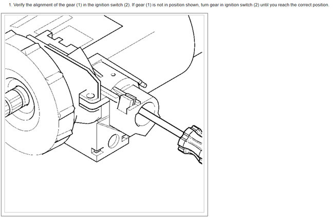

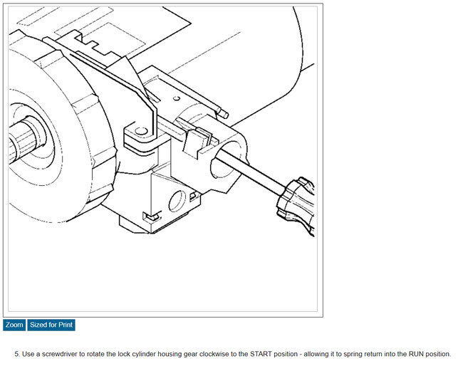

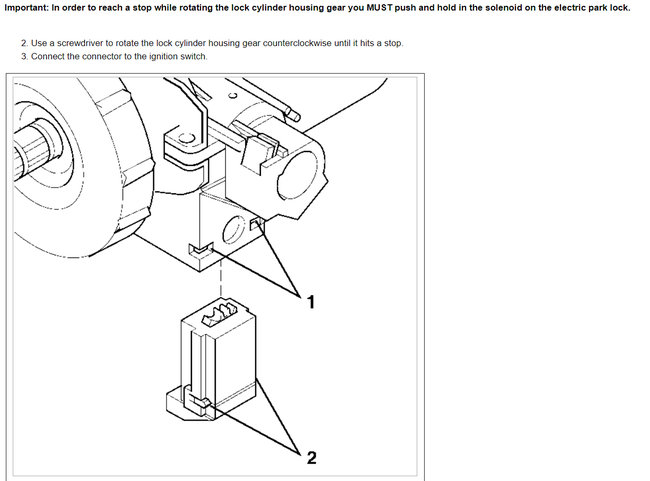

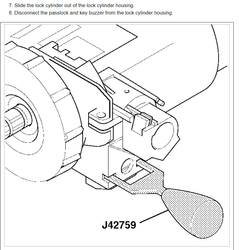

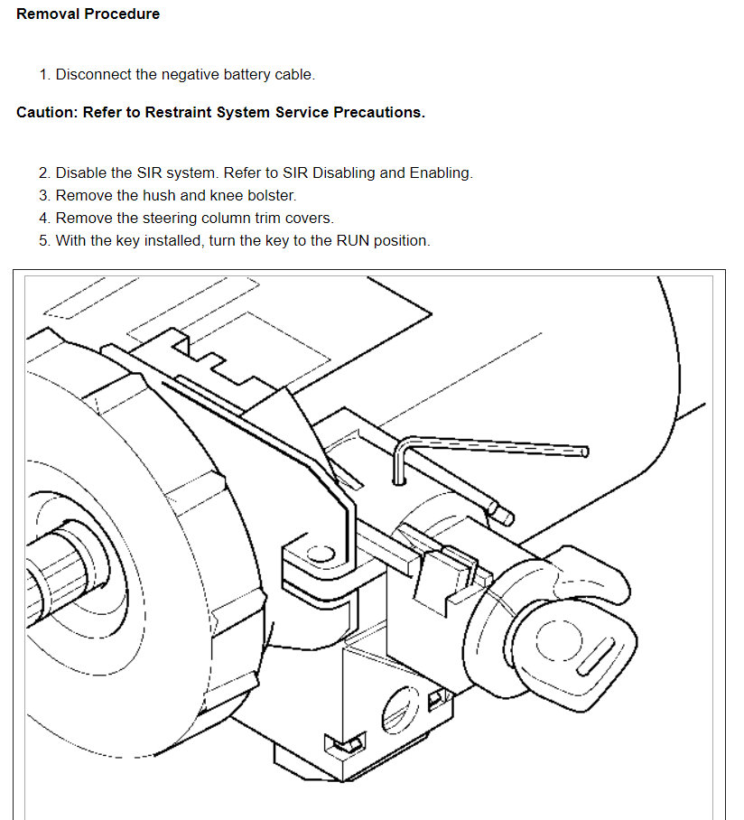

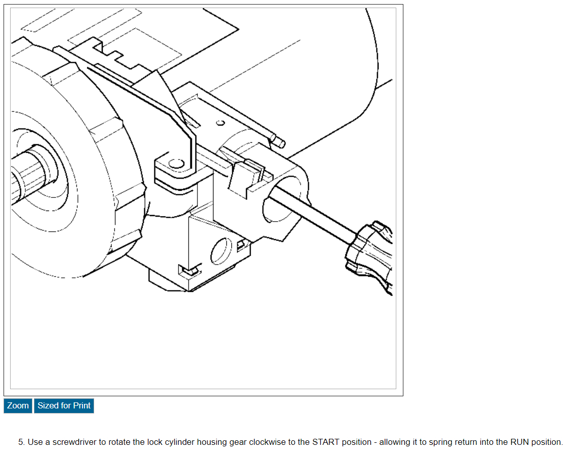

There is a small switch inside the tumbler that sounds like it broken or is getting bad connection. I would try contact cleaner inside the tumbler first and if that doesn't work here are diagrams to help you change the ignition tumbler out:
Jan 13, 2019 at 3:01 AM
BLESS2SUCCESS
  • 45 POSTS
I will for sure hold on to these diagram steps awesome! thanks Ken, by the way I had ordered a brand new Ignition Lock Cylinder will this fix this issue by any chance?
Jan 13, 2019 at 4:04 AM
  • 55,743 POSTS
It should, make sure you have the dealer code the new lock for you have your VIN ready. Let me know.
