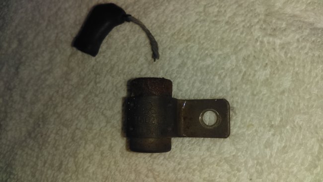

Touched the capacitor and it crumbled. So was looking up part number T50276. It is 0.5 uF from Mitsubishi. Cannot find it anywhere. Now is it electrolytic or Non electrolytic. Most under 1 uF is Non. Is this protecting from surges? Car will start sometimes but rare and when it does it does not want to idle, it is like I am intermittently depressing accelerator. seems like it is robbing power from other components too. And with it not in will I burn up other things on the run circuit?

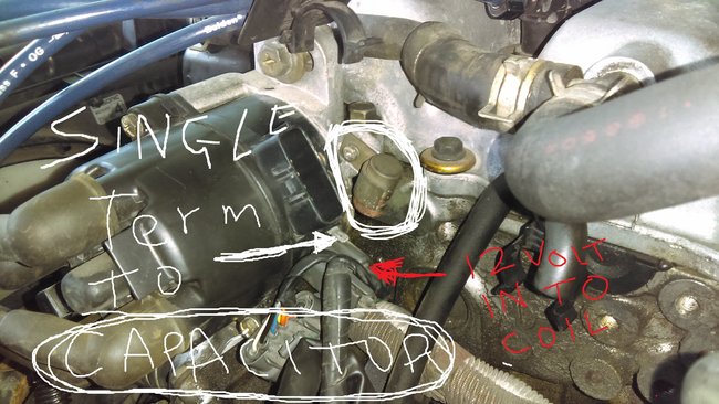

Is this stopping spikes of current from the secondary? And isn't their supposed to be a diode inside the relay for it?

That looks like a noise suppressor for the radio and has noting to do with the way the engine runs. Does the engine have low power misfire? what is it doing

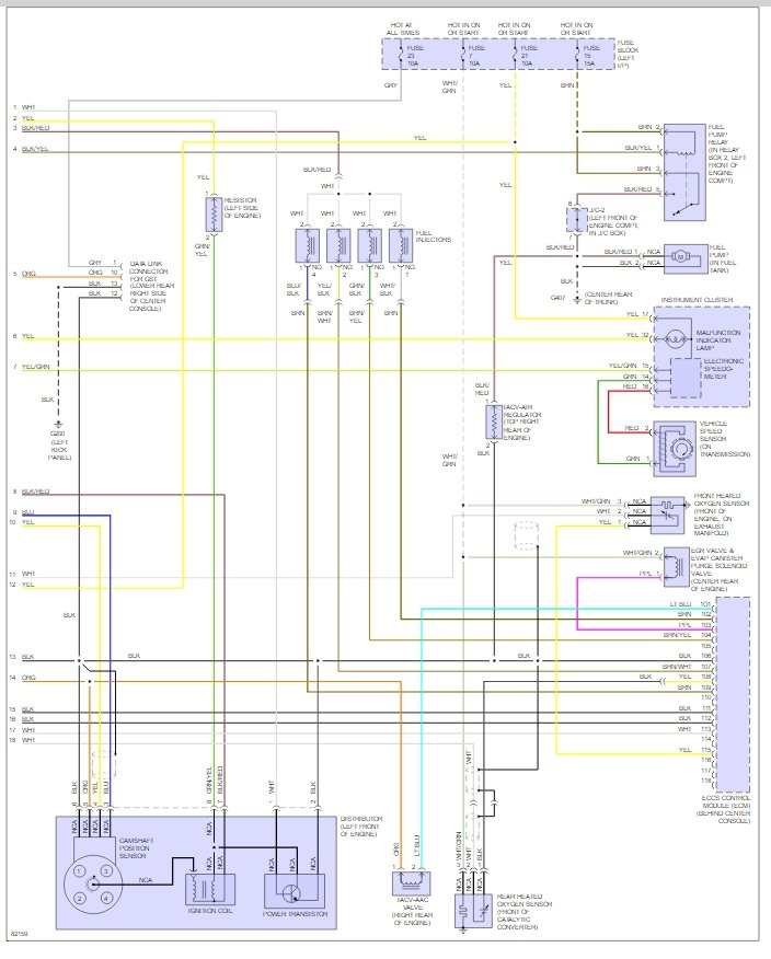

Thanks for getting back to me, it seems like a power transistor is shorted out, here is a wiring diagram that shows the o2 sensors wiring.

Power transistor spec and air regulator good too. Where else does the white green ignition wire go your diagram is alot better. Maybe that is why the inhibitor switch has to be jumped.

It's called an external ignition coil good luck trying to find them you got to buy the whole distributor to get it and that's the reason why his car is not starting just dealt with the same thing
