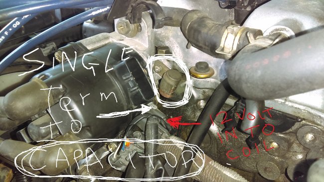

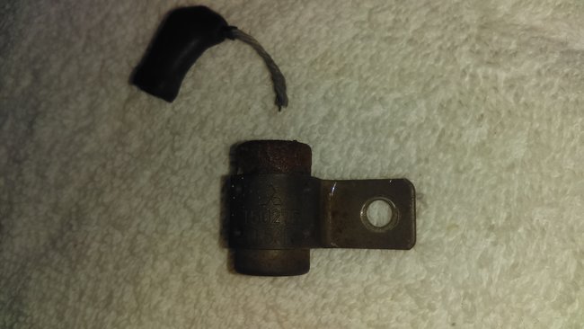

Touched the capacitor and it crumbled. So was looking up part number T50276. It is 0.5 uF from Mitsubishi. Cannot find it anywhere. Now is it electrolytic or Non electrolytic. Most under 1 uF is Non. Is this protecting from surges? Car will start sometimes but rare and when it does it does not want to idle, it is like I am intermittently depressing accelerator. seems like it is robbing power from other components too. And with it not in will I burn up other things on the run circuit?

Is this stopping spikes of current from the secondary? And isn't their supposed to be a diode inside the relay for it?

That looks like a noise suppressor for the radio and has noting to do with the way the engine runs. Does the engine have low power misfire? what is it doing

I soldered the wire back in to the cap and it will start fine. Idle fine. But I do have about .6 volt drop in the ignition circuit. And when I jump the inhibitor relay ..battery straight to start. It will run but also coolant sensor had about.298 and tps .650. Ect power comes from ecu and tps from tcu. But both on same ground.

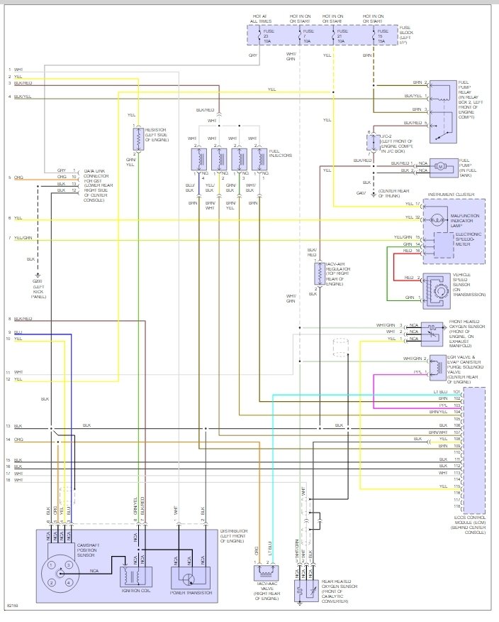

Thanks for getting back to me, it seems like a power transistor is shorted out, here is a wiring diagram that shows the o2 sensors wiring.
Let me know what you find.

Power transistor spec and air regulator good too. Where else does the white green ignition wire go your diagram is alot better. Maybe that is why the inhibitor switch has to be jumped.
