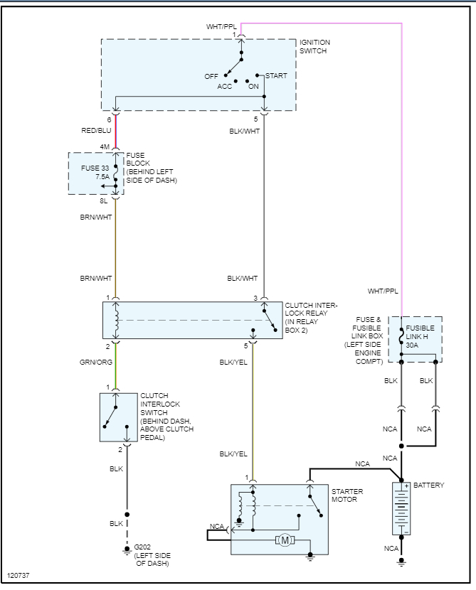

I was wondering if I can use a directed 555 G bypass module with my car listed above.
Sep 5, 2023 at 6:03 PM
  • 55,456 POSTS
To determine if the Directed 555G is compatible with your 1999 Nissan Maxima, you should refer to the manufacturer's documentation or contact their customer support. If it is, here is the starter wiring diagram to help you with the installation. Check out the images (below). Please let us know if you need anything else to get the problem fixed.

Okay, well, do they make a bypass module for this car, or do I even need one? Thanks for your time and answers.
Sep 6, 2023 at 10:49 AM
  • 55,456 POSTS
What kind of bypass module are you looking for to solve what kind of problem?

I have a 1999 Nissan Maxima and I just need to know what type of ignition bypass I need for it. Thank you.
