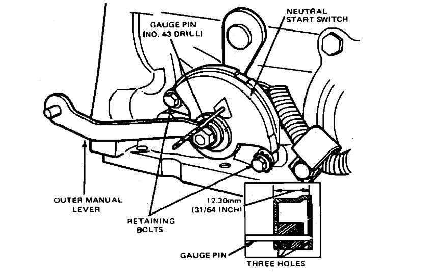

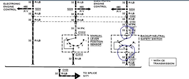

I replaced my spark plugs, wires, the whole distributor, and the ignition coil. The truck runs and drives with no problem, but when I first start it I have to put it in neutral then back to park before it fires up. Once I start it the first time it'll start in park no problem. Help
May 3, 2020 at 9:07 AM
Good evening,

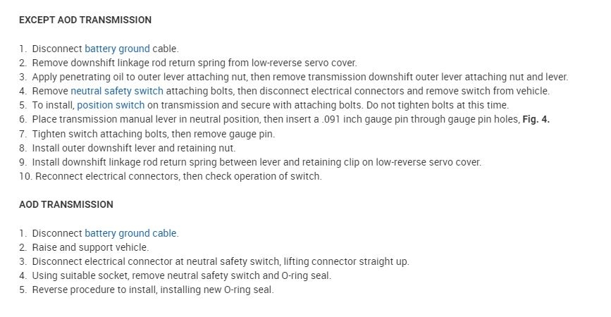

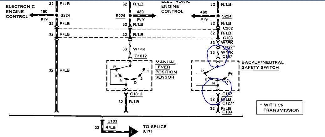

That sounds like the park neutral switch. It only allows the starter to work in park or neutral.
I attached a diagram and a picture for you to view.
I would replace the switch.
