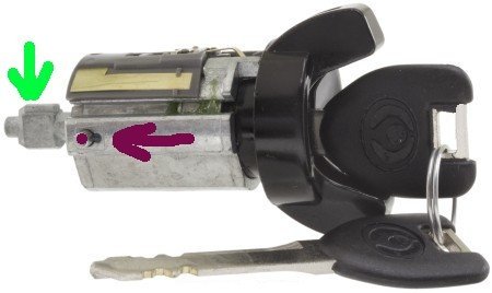

My ignition switch cylinder that I put the key in just spins and spins around I cannot cut off the engine once it is started because the cylinder just spins all the way around. How do I remove and replace this ignition cylinder switch?

How are you currently starting the engine and shutting it off? It sounds like the end of the lock cylinder has broken off.

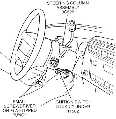

This is what the book says but looking at the parts available I am not sure it is correct, as I recall that is basically the same truck as a Ford Ranger and those use a rod to connect to the ignition switch mounted down on the column.
First disconnect the battery ground cable.
Next remove the screws that hold the lower and upper covers to the steering column and remove the covers.
Unplug the ignition switch connector .
Remove the screws that retain the lock assembly and remove it.
Reverse to install the replacement.
The Ford process (in the picture)starts with removing the battery ground
Then remove the lower steering column cover. Next you turn the key to the run position. As yours is broken you should be able to use the switch rod to move the switch to that same setting.
Next you use an 1/8" punch or stiff wire to push the retaining pin (purple dot and arrow) up in the hole in line with the cylinder under the column.
Then pull the cylinder straight out.
Now look at the green arrowed part. If it is broken off (which I suspect) then you will need to use tweezers or similar to remove the broken piece from inside the actuator inside the cylinder socket.
Then you reverse the process to install the new cylinder, hold the pin in while you insert it into the column and gently align the cylinder to the actuator. Be sure the pin locks in.
