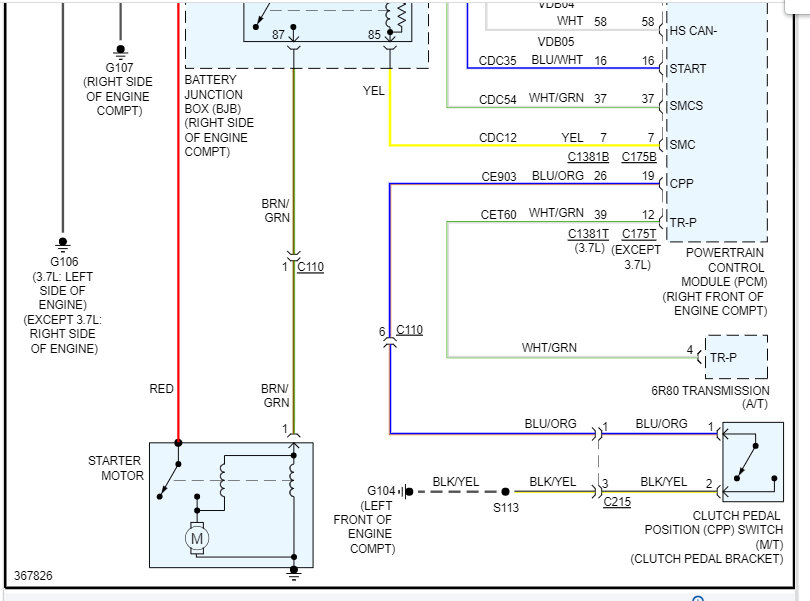

Do you mean the starter won't engage when the key is in the start position? If that is the case, take a look through this link first to see if it helps.
If that doesn't help, see if it will start in reverse. If there is no change, I need you to check fuses and the starter relay.

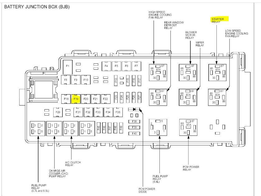

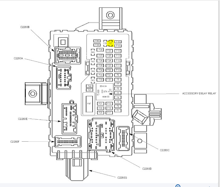

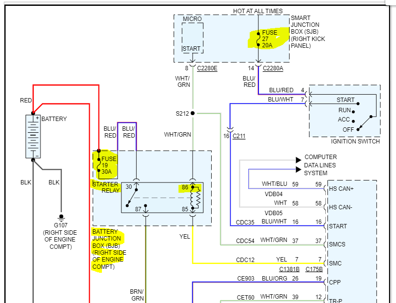

If you look below, I attached the starting circuit wiring schematic. Start by testing the start fuse in the battery junction box (fuse 19). Also, check fuse 27 in the smart junction box under the dash.
In addition to checking the fuses, confirm there is power to and from them.
If the fuses are good and have power, switch the starter relay with a different one in the box having the same part number. If there isn't one, here is a link that explains how to test a relay:
Let me know what you find.
joe
See pics below. Note: The last two pics show fuse and relay locations. Pic 1 is the BJB, and pic is the SJB.
